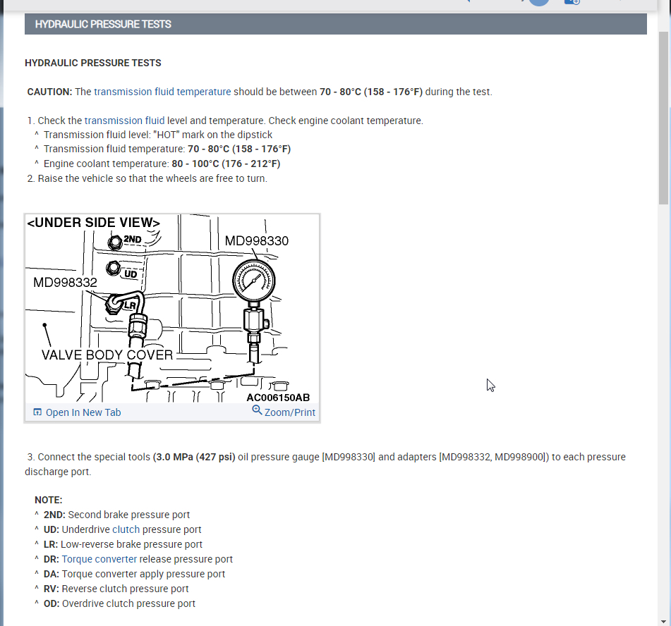

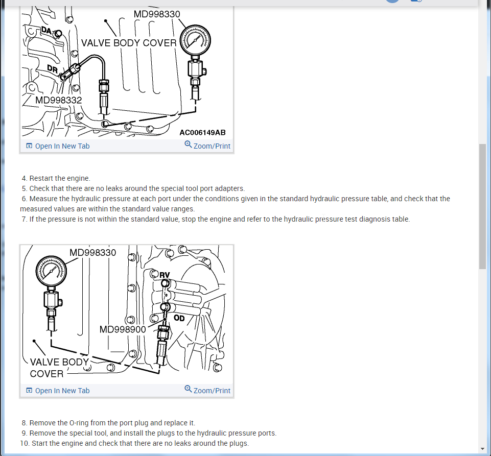

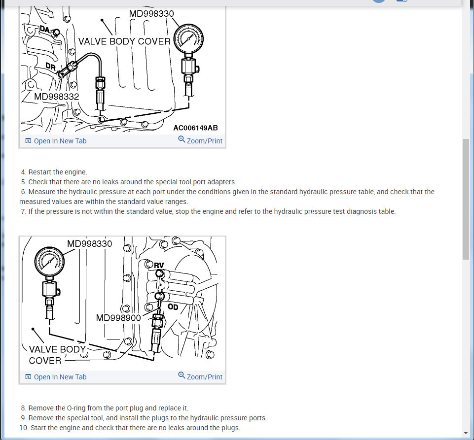

That is for an o2 sensor you are correct that this would not be related.
The next step if there are no codes is to check the pressure. This is not an easy thing to do but would be what we need to find out. I attached the process for your review.
