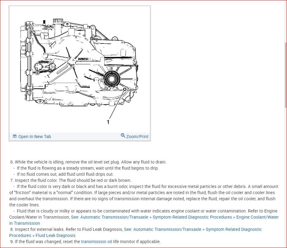

Hi Umar,
This sounds like it is fluid related. When is the last time you had the fluid changed? According to the post the vehicle only has 11,000 miles however, it is over eight years old. If this is accurate then the fluid needs to be changed even if it hasn't hit the specified mileage.
Apr 12, 2019 at 1:21 PM
Sorry i hit the reply button by accident.
The reason I believe it is fluid is because it does not act up while the fluid is cold. The fact that letting it cool down makes it operate again indicates a fluid issue.

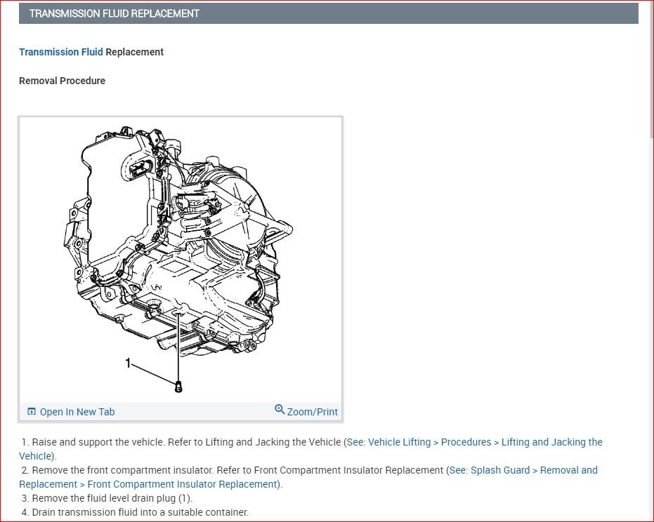

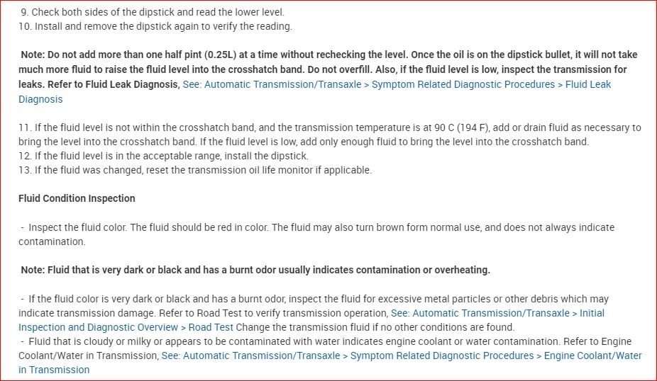

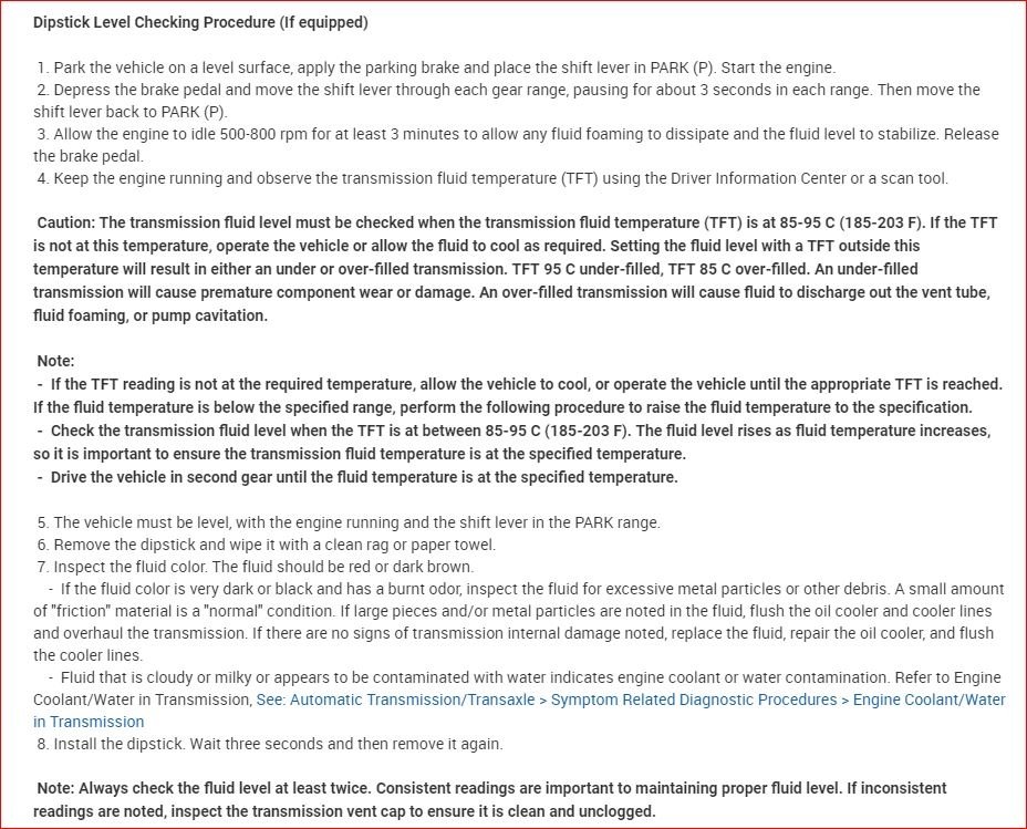

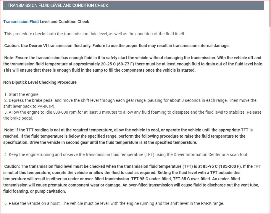

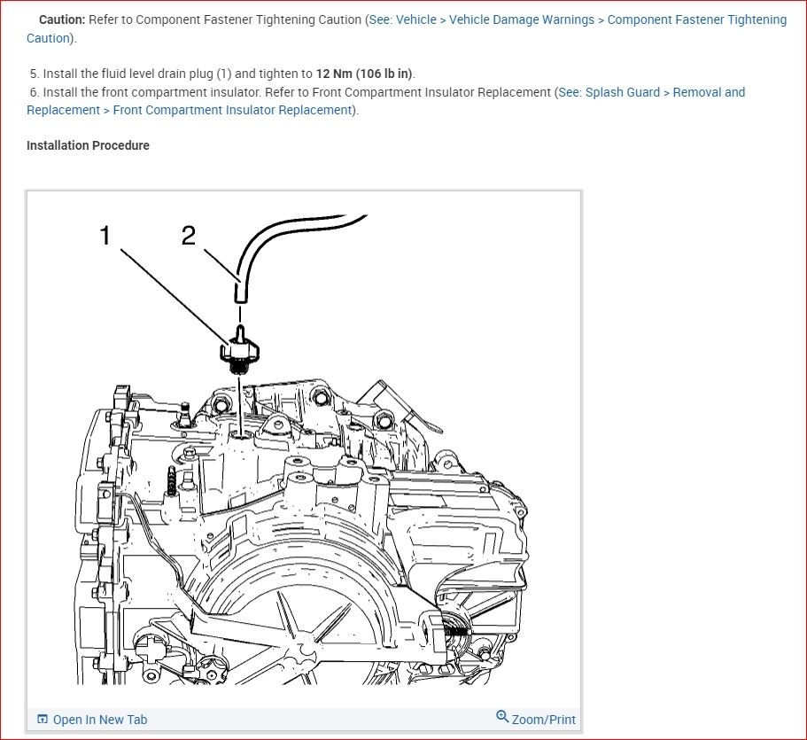

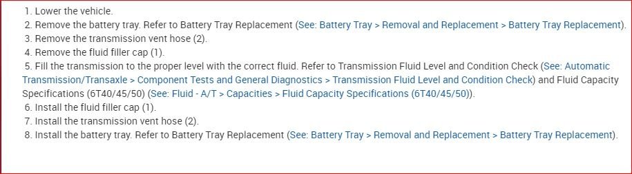

There is a chance that this has now effected the clutches in the transmission and if it has, it will require to be rebuilt or replaced. However, I would start with the fluid because that is an easier fix and much cheaper. Basically, it is worth trying before going any further.
