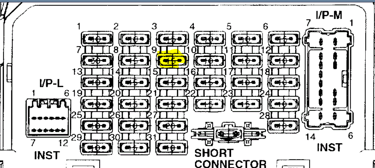

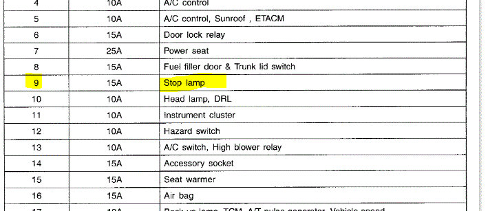

Now, the vehicle has a shift interlock in the vehicle to prevent the vehicle from being shifted from park by accident. The release solenoid is powered via the brake light switch. So, first check to see if the brake lights are working. If they aren't, check fuses first. The brake light fuses is located in the vehicle fuse box. It is number 9. See the attached two pics.
