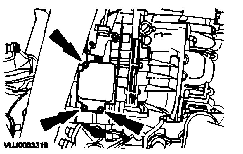

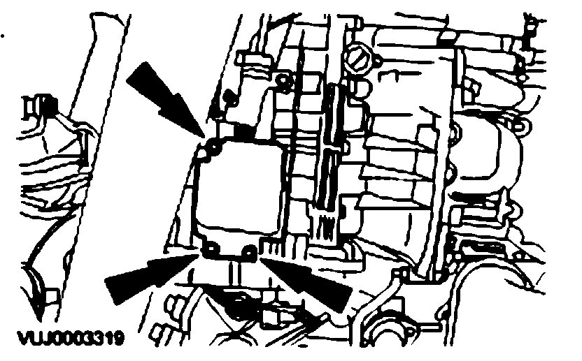

1. NOTE: To move the gear selector lever, the ignition must be in the RUN position, with the foot brake pressed.
Move the gear selector lever to 'N' position.
pic 1

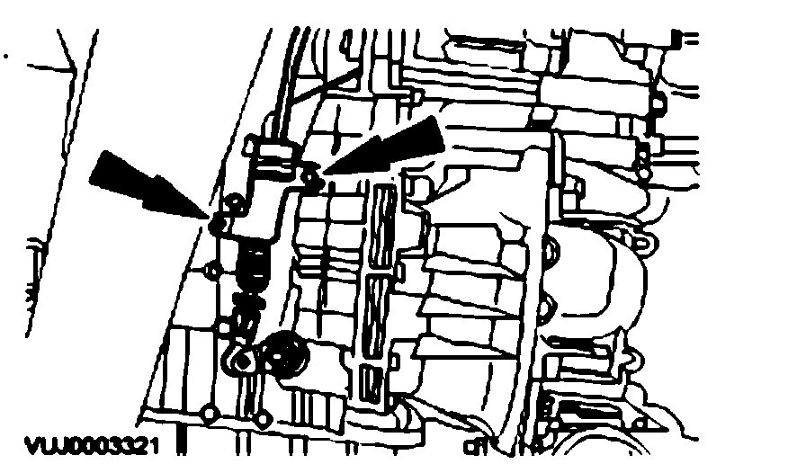

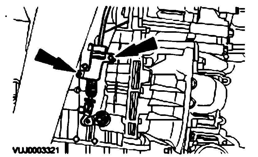

2. Remove the center console right-hand side trim panel.
pic 2

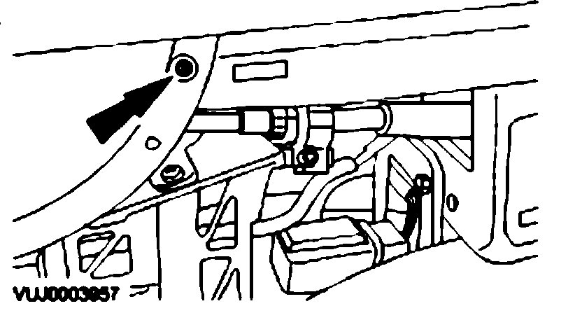

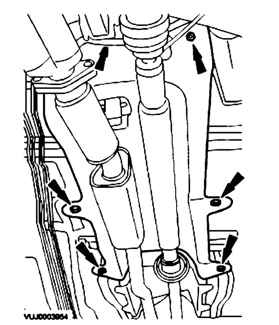

3. Release the gear selector cable locking pin.
pic 3

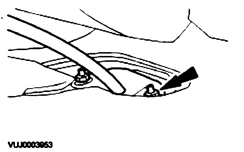

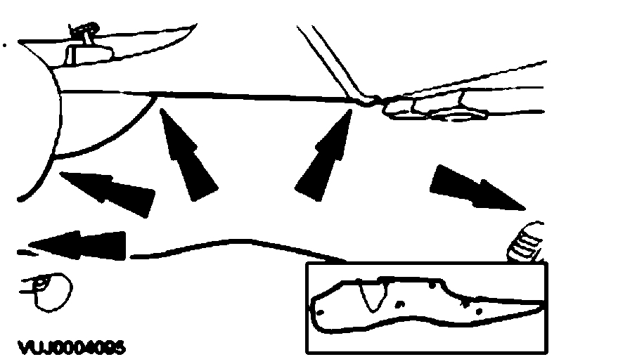

4. Remove the center console side retaining screw.
pic 4

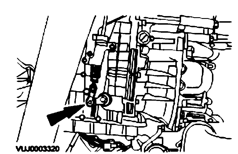

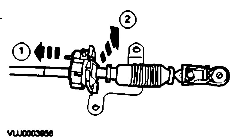

5. Detach the gear selector cable from the J-gate.
pic 5

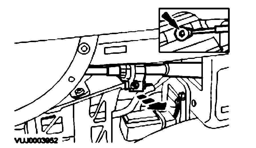

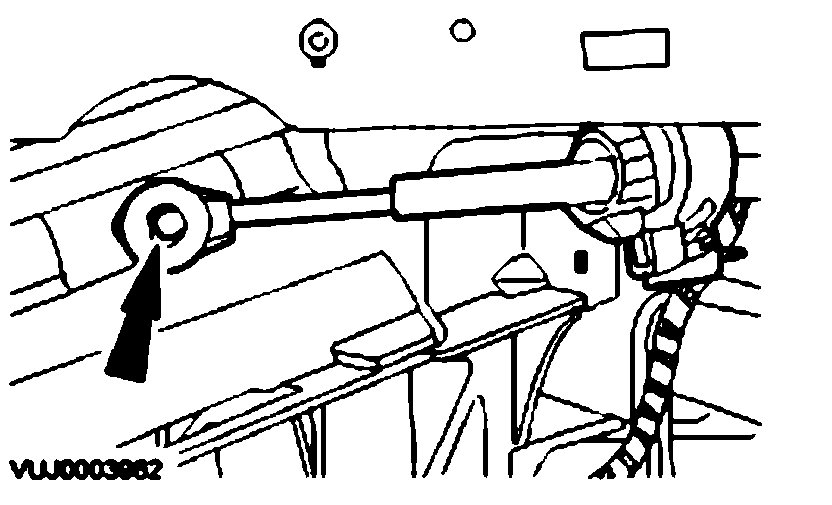

6. Disconnect the gear selector cable from the J-gate.
pic 6
