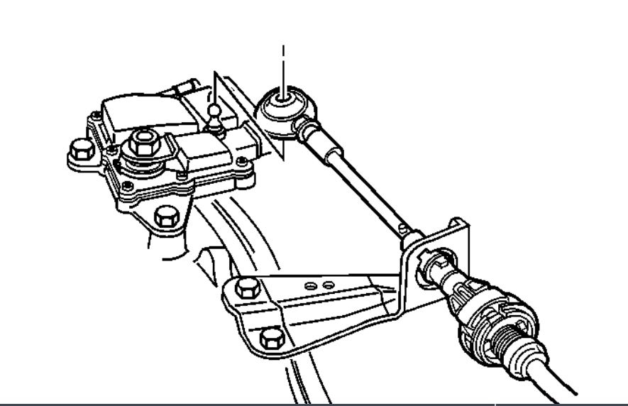

The shifter moves freely without the brake engaged, but the vehicle says it's in reverse so it won't start.
Sep 17, 2019 at 6:19 AM
Good morning,
It sounds like the cable has either broken or came off where it hooks to the transmission.
Open the hood and look under the battery. There should be a cable that attaches to the top of the transmission. Make sure it is connected.
