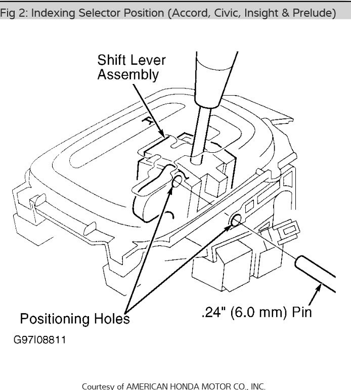

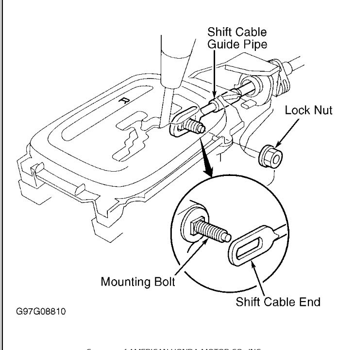

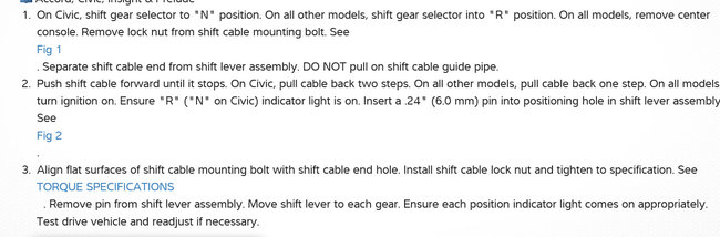

scan for codes it may be a TCM or a wiring issue /connection. see pictures for adjustment procedure.

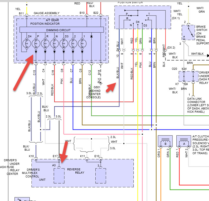

You can try a new TCM but it may have to be programmed to your car or check the wiring to see if it has a good ground or maybe a short in wiring between TCM and switch. looking at the wiring diagram it uses the multiplex unit so that could be bad from switch and ground is in center console. it should not have any more than 5 ohms per wire. i am not sure if multiplex unit is sold separately.

I believe it was the "gear range sensor" but let's see if they respond. If you go over the wiring diagrams in the post above, you can see how the system works.

KEN L, I had a similar issue, and the mechanics got it fixed by adjusting the shifter cables and the new NSS to correspond with the gear selection on the instrument cluster, the selected gear on the lever, and the selected gear on the gearbox. My car still blinks D and shifts erratically in drive mode or just revs. I'm hoping replacing my shifter solenoids fixes the issues with my drive shifts.
