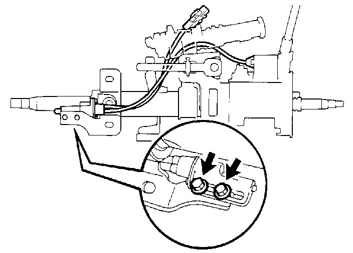

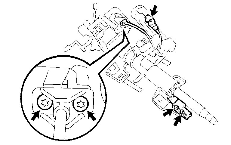

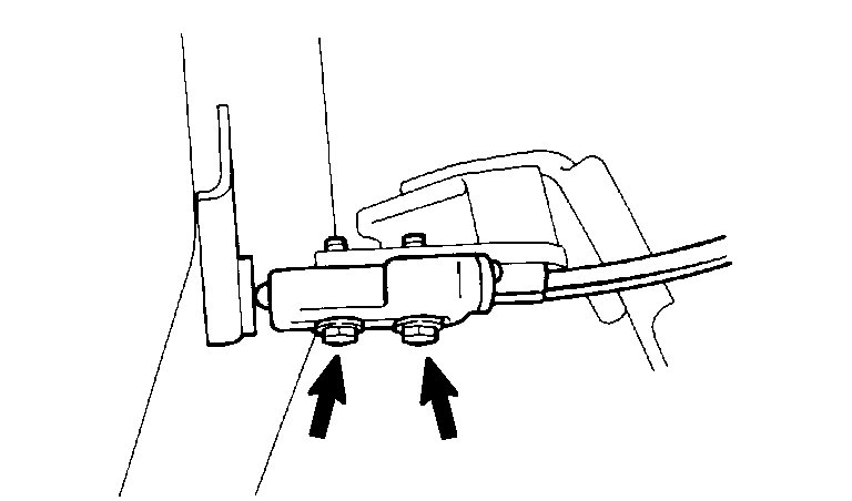

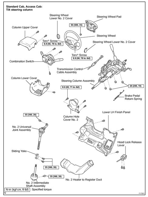

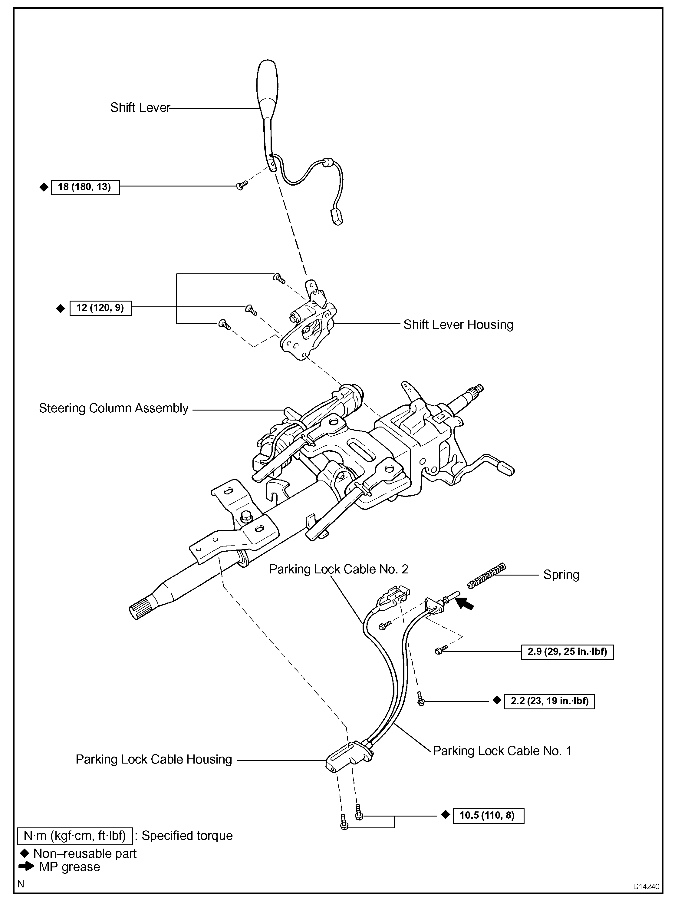

I was attempting to place the truck in drive but when I got to neutral seems like something became disconnected. It's in neutral but moving the gear shift will not engage.
Sep 29, 2019 at 1:47 PM
Welcome to 2CarPros.

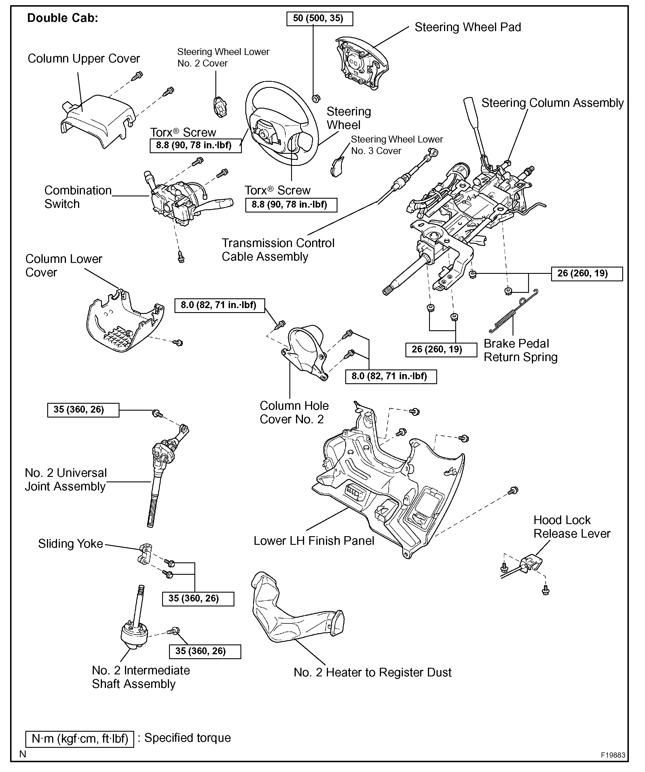

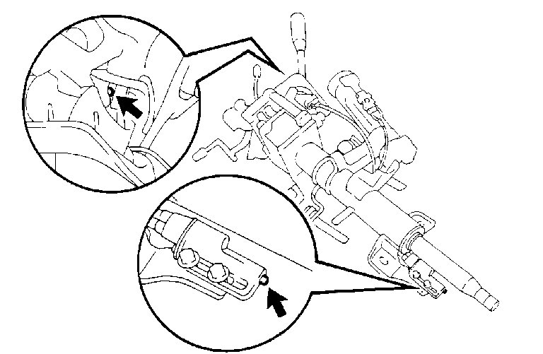

Take a look through these directions. They are for cable replacement. You will need to inspect the locations indicated in the attached pictures, which correlate with the directions to see if something is disconnected or broken.

COMPONENTS
REMOVAL
1. REMOVE STEERING COLUMN ASSEMBLY
pic 5
2. REMOVE PARKING LOCK CABLE ASSEMBLY
a. Remove the screw and cable No. 2.
b. Using a torx socket wrench, remove the 2 screws and cable No. 1.
c. Remove the spring.
d. Remove the 2 bolts and parking lock cable housing.
3. REMOVE SHIFT LEVER
a. Disconnect the connector.
b. Using a torx socket wrench, remove the torx screw and shift lever.
4. REMOVE SHIFT LEVER HOUSING
Using a torx socket wrench, remove the 3 torx screws and shift lever housing.

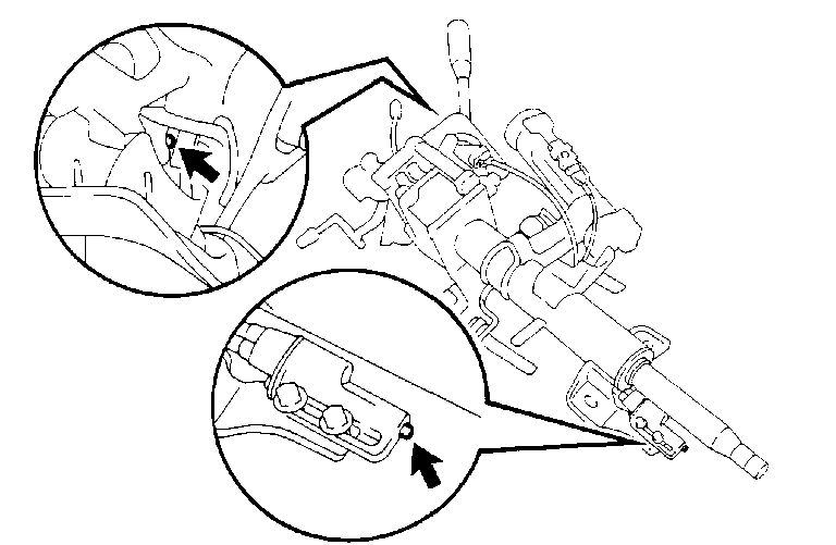

3. INSTALL PARKING LOCK CABLE NO. 1 AND NO. 2
a. Apply MP grease on the lock pin and internal surface of shift lever housing.
b. Install the spring and parking lock cable No. 1 into the shift lever housing.
NOTICE: Be careful not to bend or twist the cable abnormally.
c. Using a torx socket wrench, install 2 new screws.
Torque: 2.9 Nm (29 kgf-cm, 25 inch lbs.)
pic 6
d. Wire the cable No. 1 and No. 2, as shown in the illustration.
