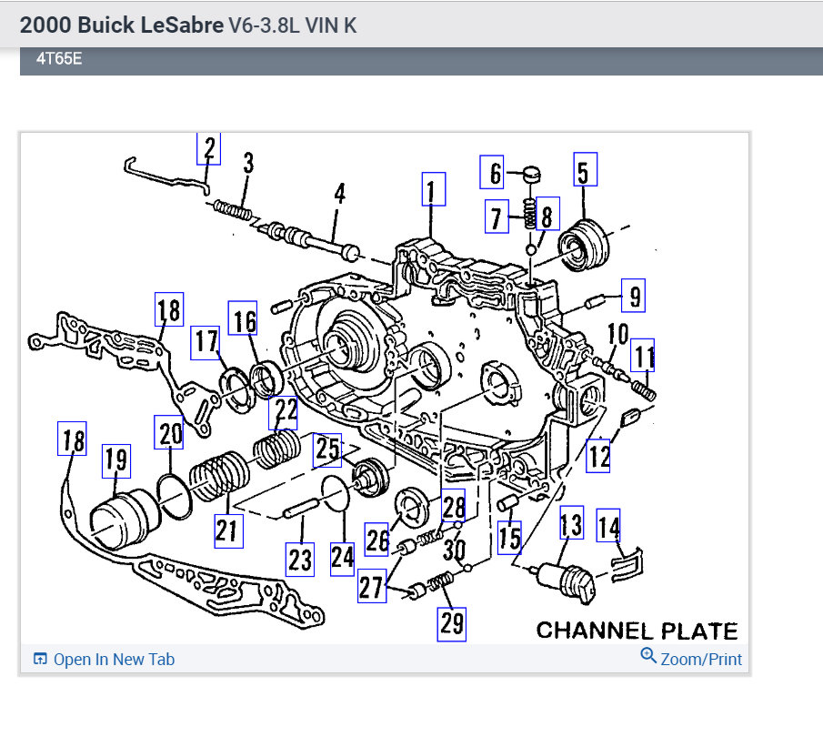

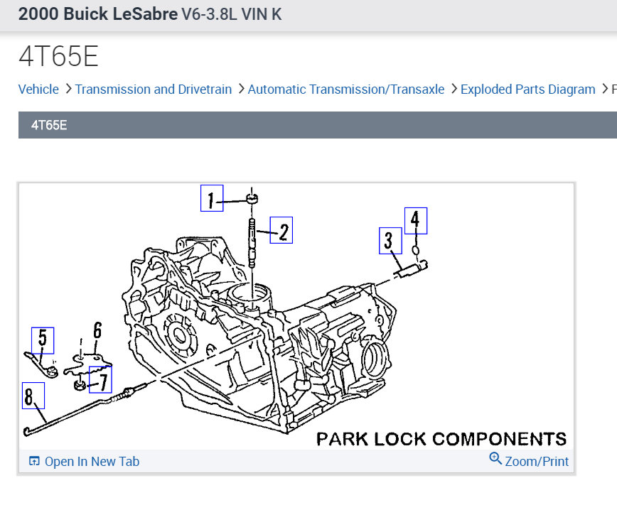

It sounds like the channel plate has gone bad which is what the cable connects to here are diagrams so you can see how the system works. Check out the diagrams (Below). Please let us know what you find. We are interested to see what it is.

Here are the part numbers and cost of the major components:
Valve Body
Side Cover
Case & Related Parts
1 - Case Side Cover
24211955
$173.03
Side Cover Gasket
2 - Side Cover Gasket Kit
24206959
$102.30
Gasket
3 - Gasket
24205119
$10.25
Wiring Harness
4 - Harness
24230348
$72.06
Front Pump
5 - Front Pump
24226042
$298.78
Order By Description.
Oil Pressure Switch
6 - Fluid Pressure Switch
24223197
$60.20
Valve Body
7 - Control Valve
24218254
$418.07
Separator Plate
8 - Valve Body Spacer Plate
24217552
$25.17
Separator Gasket
