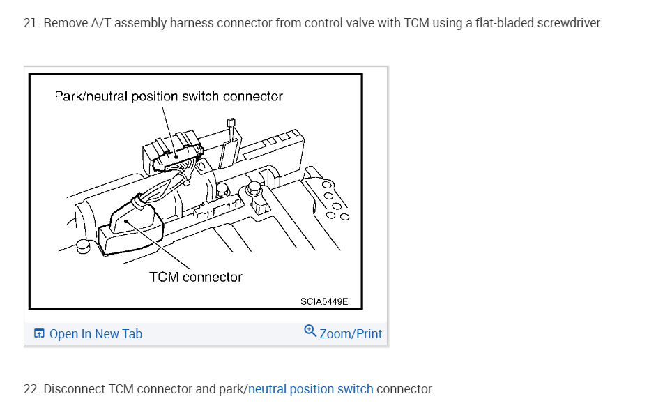

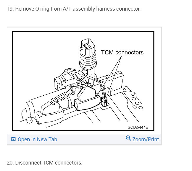

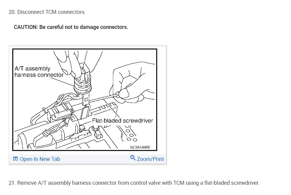

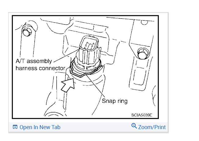

It sounds like the gear range sensor is not plugged in completely or the sensor has gone bad. here is the location and how to replace it so you can check it out. Do the other gears work like reverse and park? Check out the diagrams below to help show you what I am talking about. Let us know what happens and please upload pictures or videos of the problem.

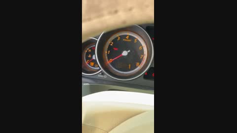

It will go in the gears but when I shift to them it just says the one the entire time.
Dec 10, 2022 at 1:17 PM
Thanks for the video and image. I would definitely look at the transmission electrical connector, also when you reinstalled the valve body did you reconnect the Park/neutral switch electrical connector? Please check out he images above to see what I am talking about.
