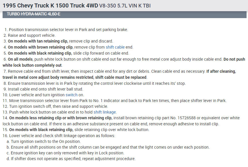

Is there any how to videos on changing the gear selector cable and adjusting it if it can be adjusted.

Here is what I found for replacement and adjustment of the shifter cable. I've attached a picture below. Get back to us and let us know what happens or we'll go from there. Hope this helps and thanks for using 2CarPros.

I hope this shifter cable information helps. Sorry, unfortunately you can't ask different questions on the same thread as it doesn't work this way. If you have an additional timing issue it will need to be asked as a NEW question. Sorry this is the way it works and I don't make the rules. All responses are answered to the email you provide. Here is the link to ask a new question like a possible timing issue.
