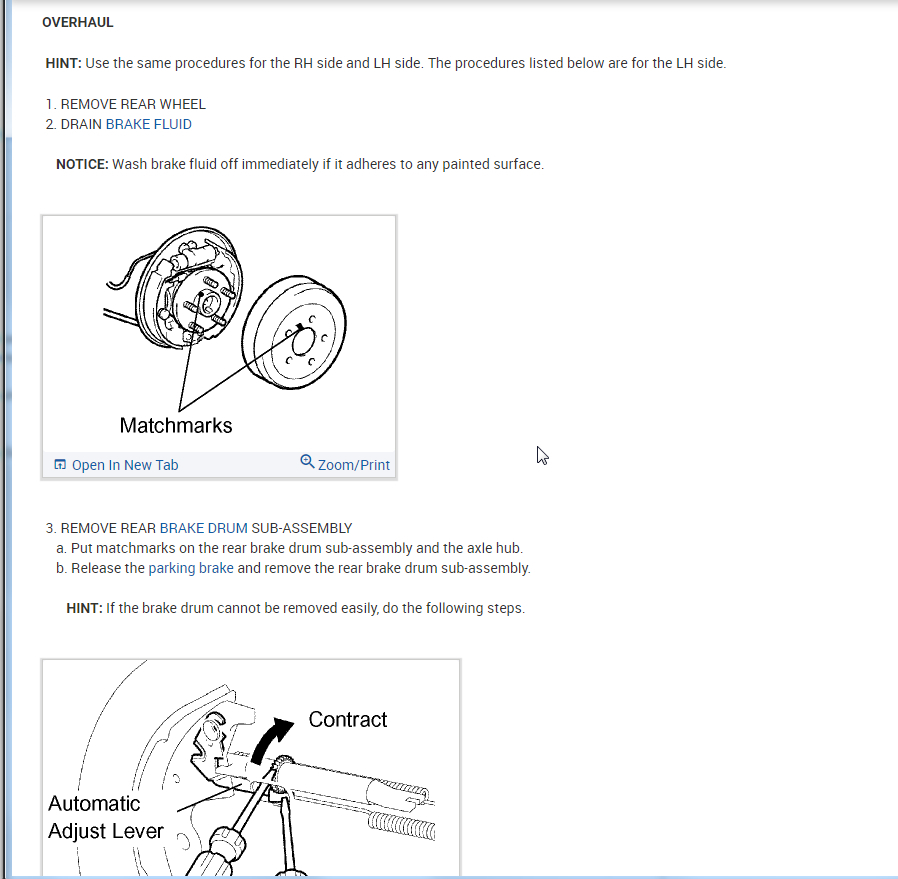

I discovered my brake grind in the rear ordinarily without pressing down the brake. My brakes are gone please help me change them out.
Aug 16, 2016 at 2:27 AM
CERTIFIED EXPERT
18,907 POSTS

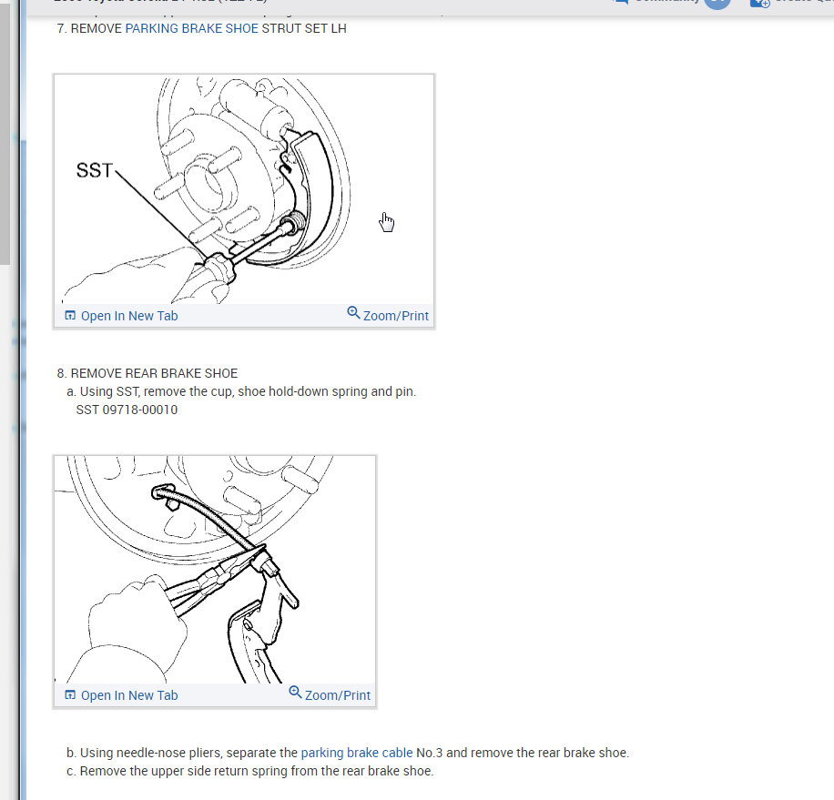

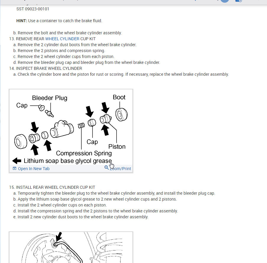

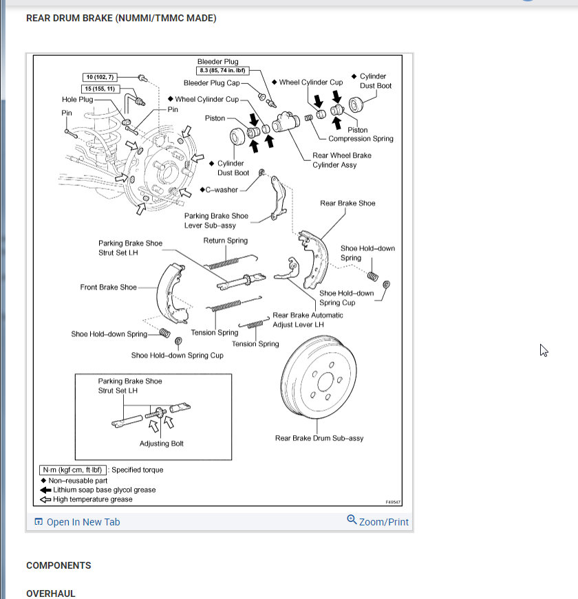

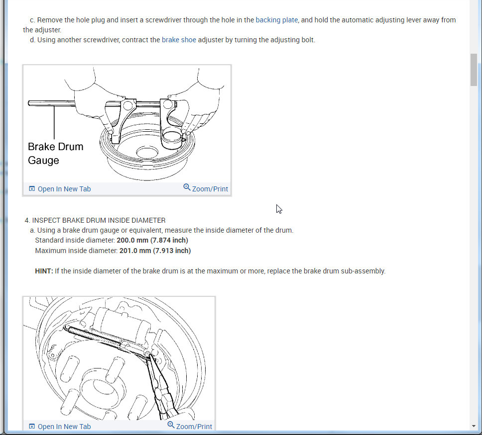

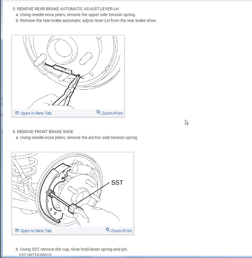

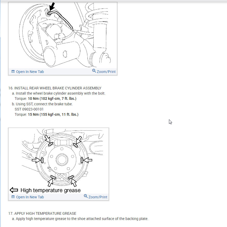

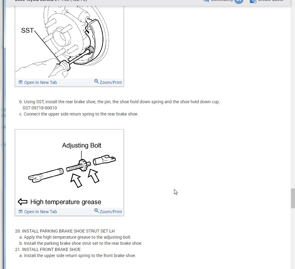

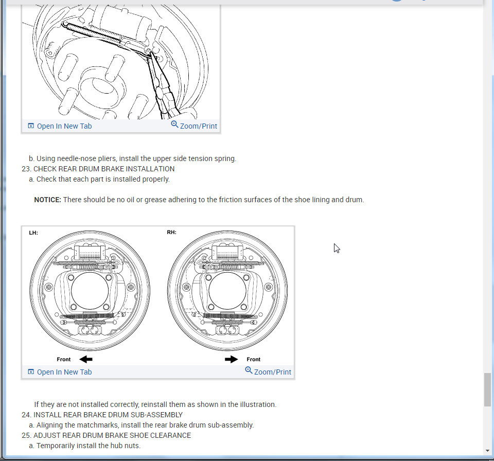

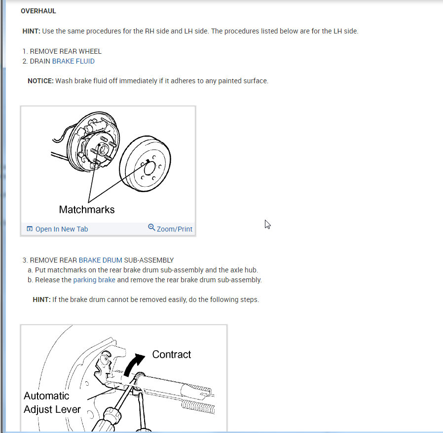

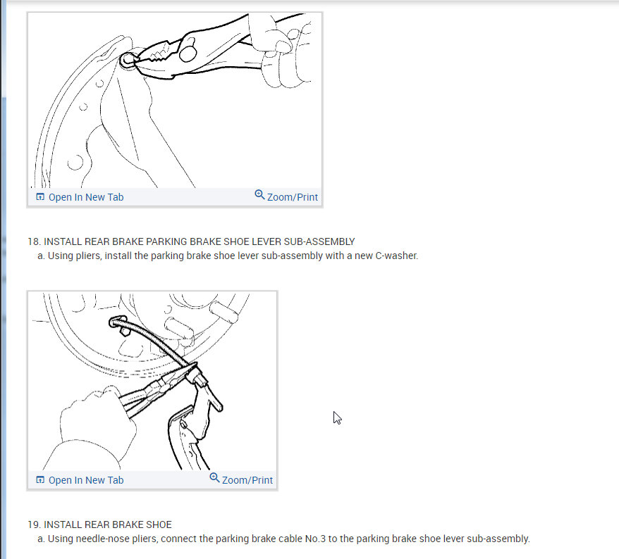

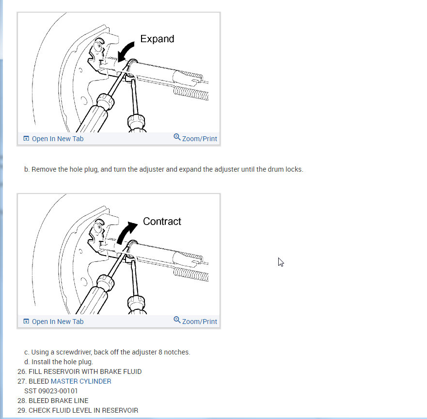

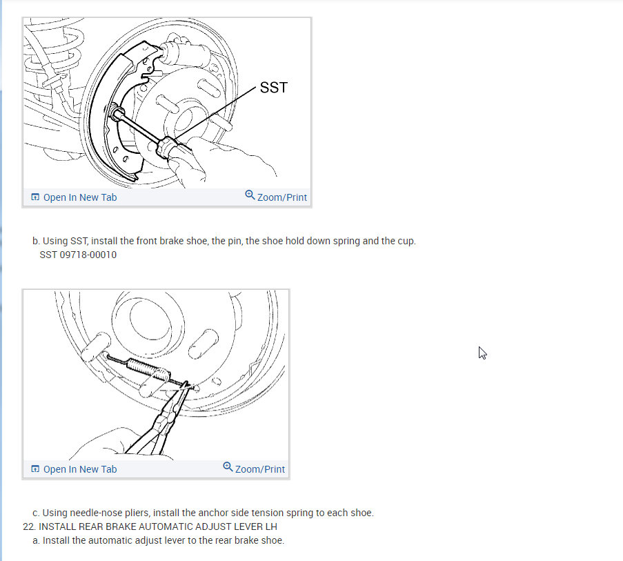

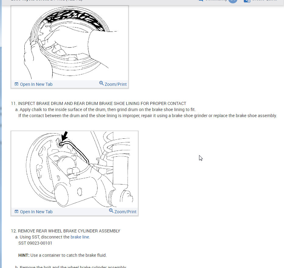

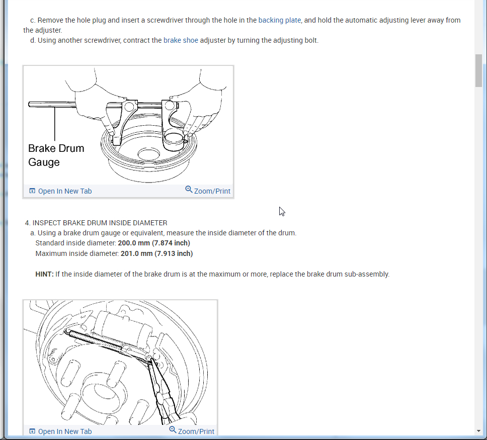

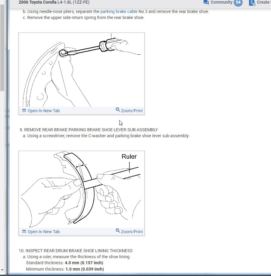

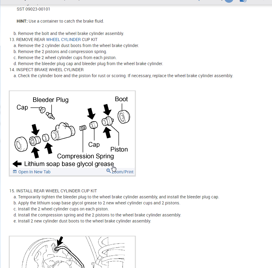

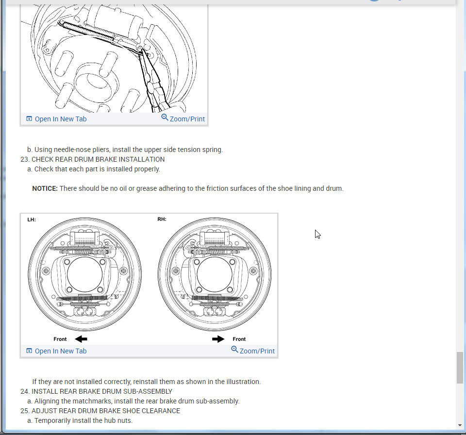

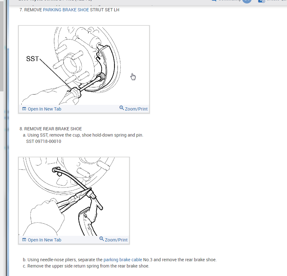

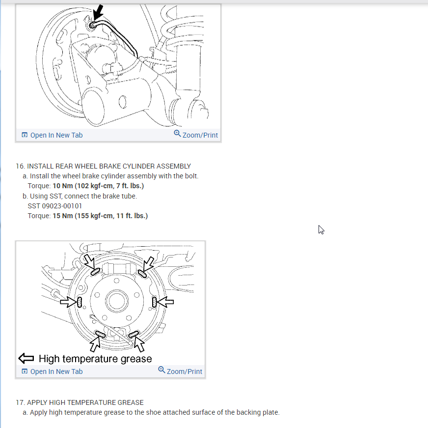

Here is a guide that will help with this:
https://www.2carpros.com/articles/how-to-replace-rear-brake-shoes-and-drums
Below you will find the process from the manual that will give more detail on how to replace the rear brakes. Please let us know if there are questions. Thanks
