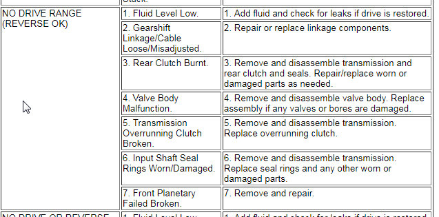

Hi Raul,
Here is the diagnostic flow chart for this issue. Please take a look at this and let me know if you have questions. It is pretty self explanatory but if you need help making a repair that you find as the issue, please let me know.
Thanks
