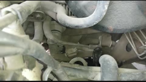

This is what have seen when moving shifter as sequence reverse,1, 2, 3,4, 5.
Aug 27, 2018 at 7:06 AM
Thanks for he video. I can see some hoses getting in the way of the shifting. When the shifter is in reverse try to push the gear selector on the transmission further to see if you can get it in reverse this will tell us if it is a transmission problem or the shifter cables. Please let me know.
Aug 27, 2018 at 10:44 AM
AHMEDMANSOUR
  • 6 POSTS
Yes, when I pushed the levers to shift I got the reverse and car moved reverse.

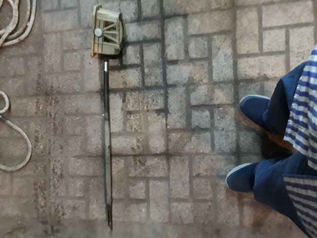

The problem solved by changing these parts.
