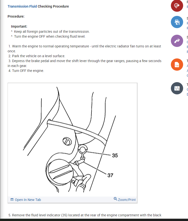

hot oil level in max mark zone of dip stick with engine running at idle.
