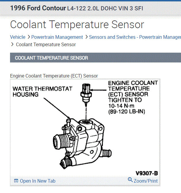

Thank you for your answer. I checked the ohm readout on the temperature sensor and it is way off. I notice that the wires to the sensor have crumbling wire protection coating. Can I diy this with new wire?
May 17, 2021 at 11:05 AM

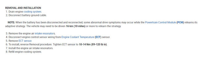

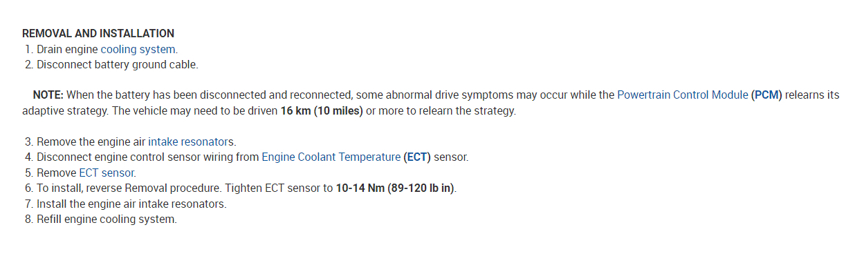

As far as replacing the sensor, you should be fine. I attached the directions below. You will need to drain the coolant level below the sensor or you will end up with a mess. LOL

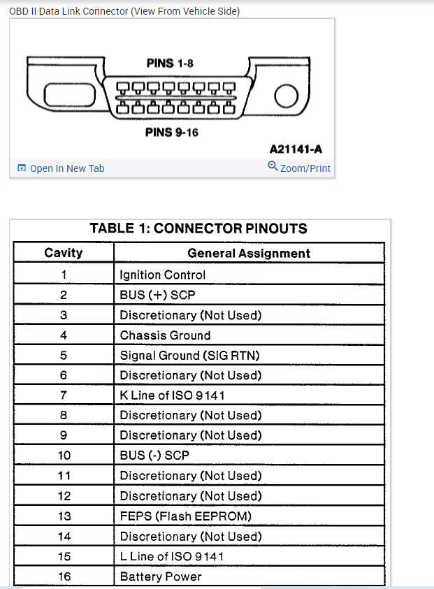

First is to scan for codes, the second is to allow to idle and monitor the temperature, remember to inspect transmission oil for any burn smell and if it is full according to Ford dipstick. Let us know what happens and please upload pictures or videos of the problem.
I am glad to help you, if there is anything else we can help you with please contact us again. Thank you for choosing 2CarPros. Take a look at the chart for diagnosis connector.

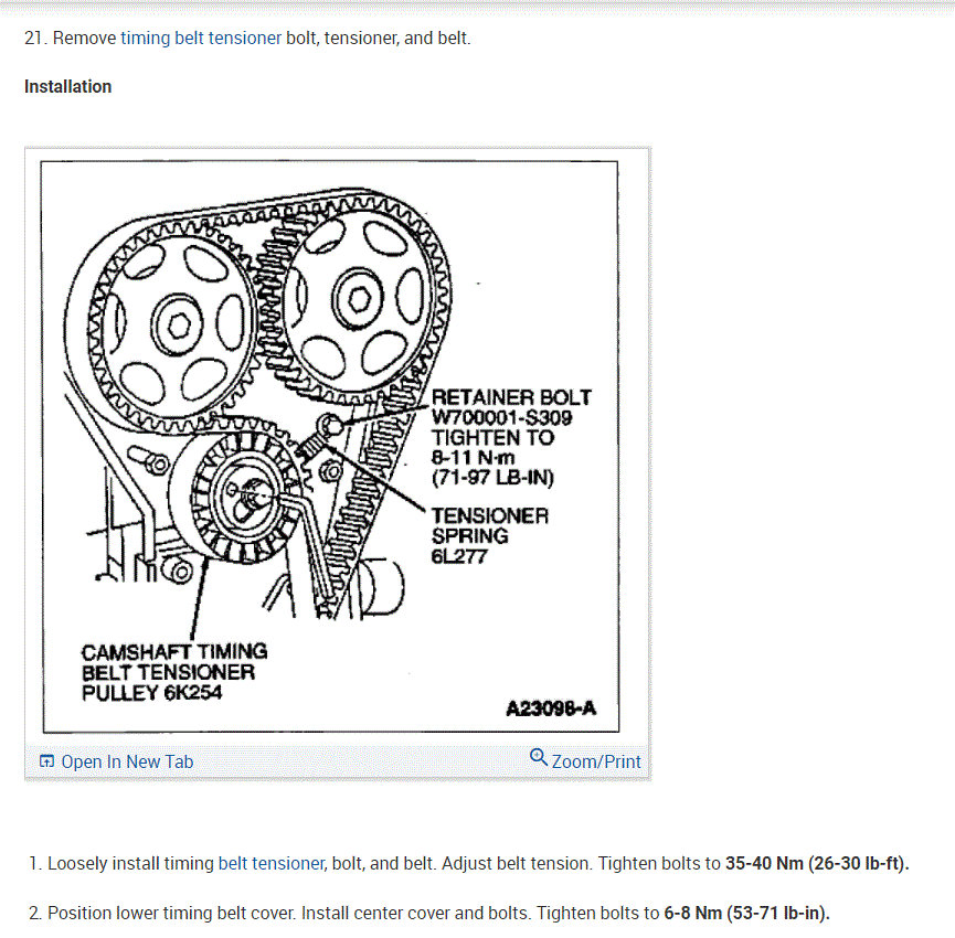

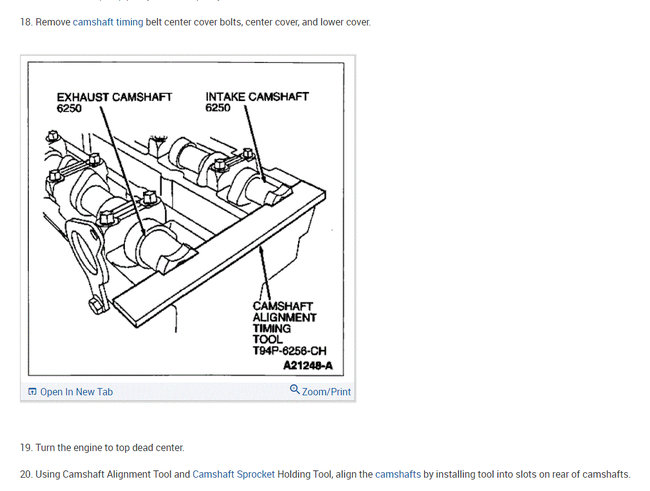

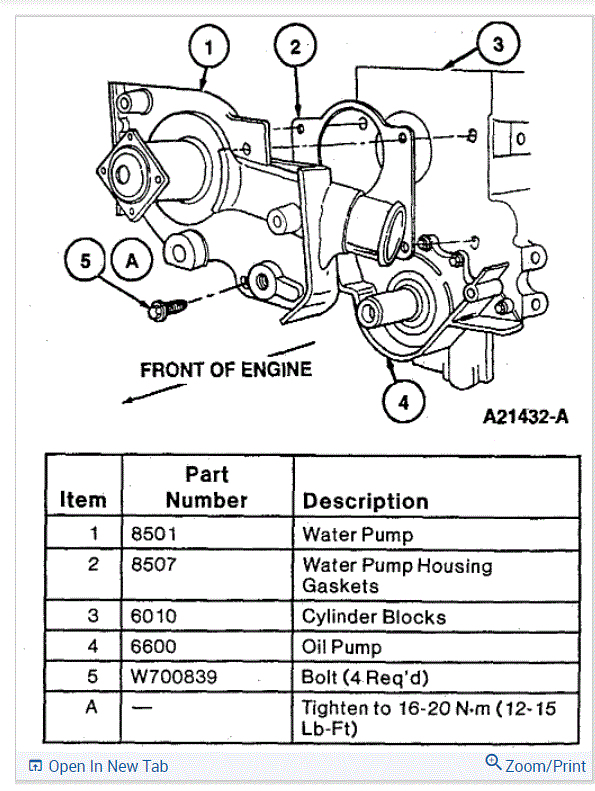

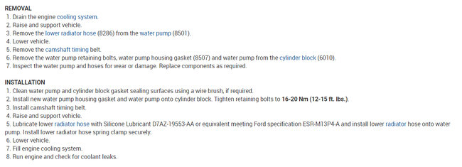

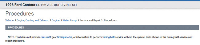

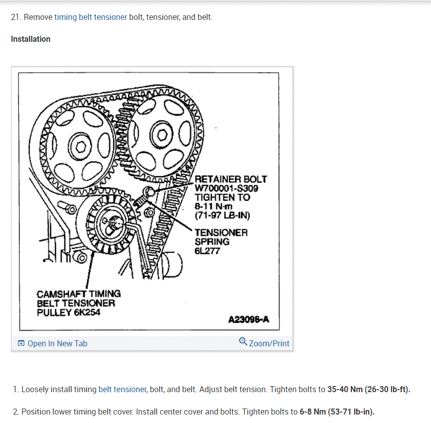

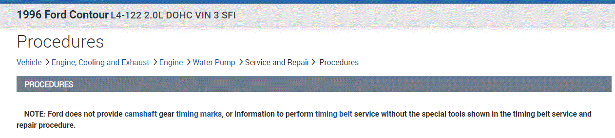

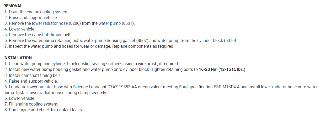

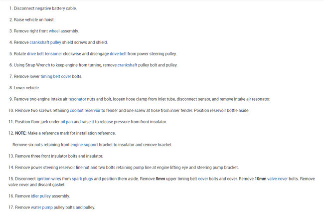

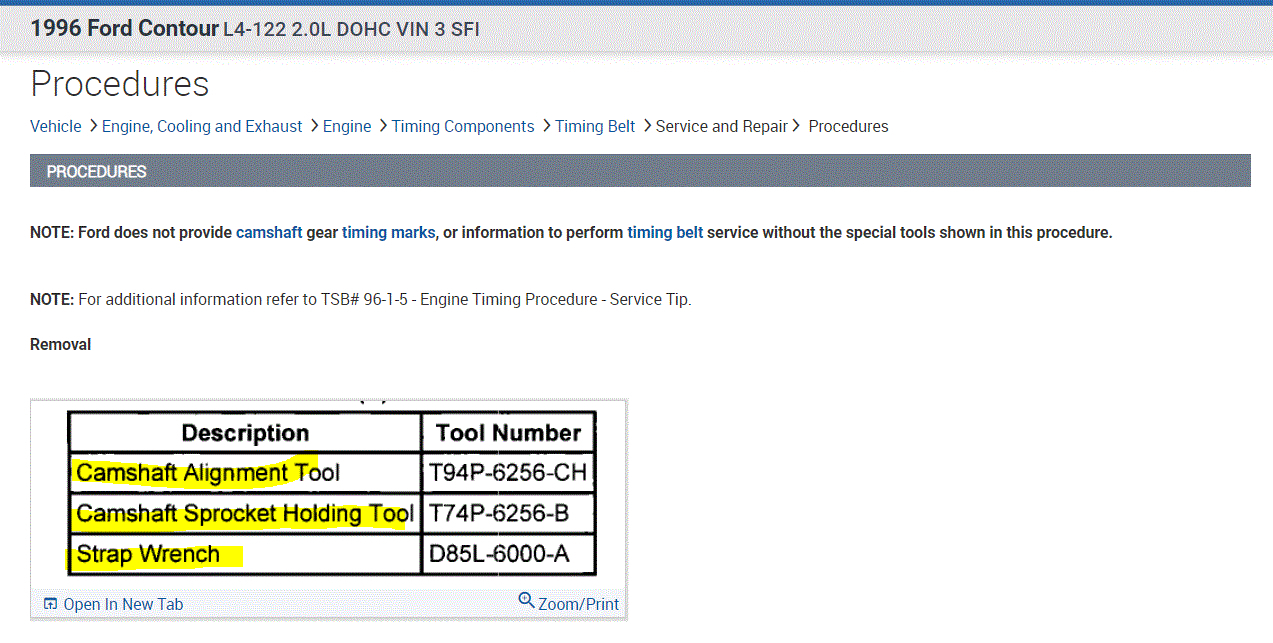

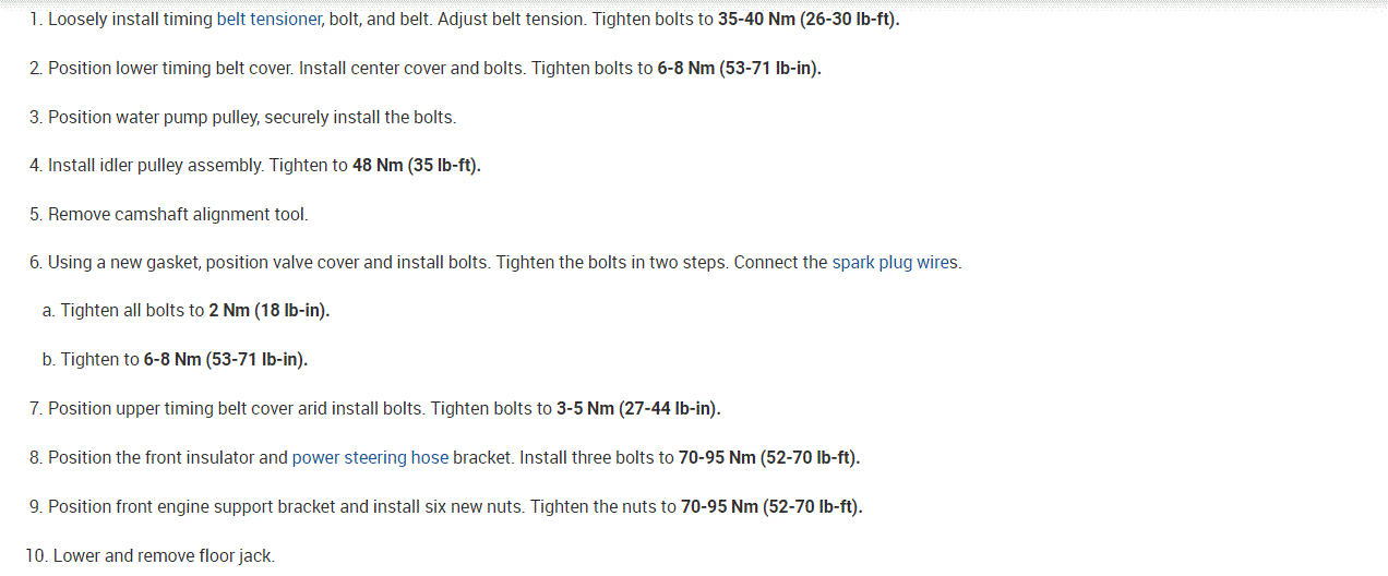

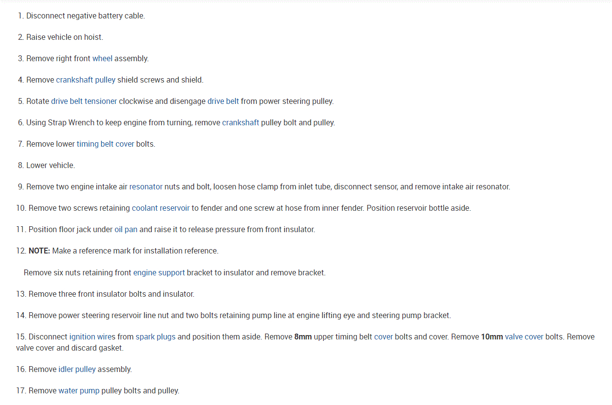

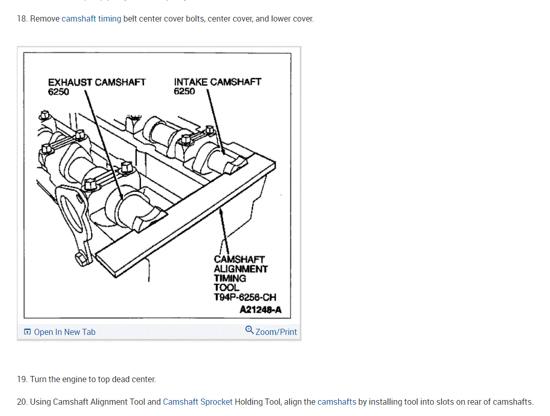

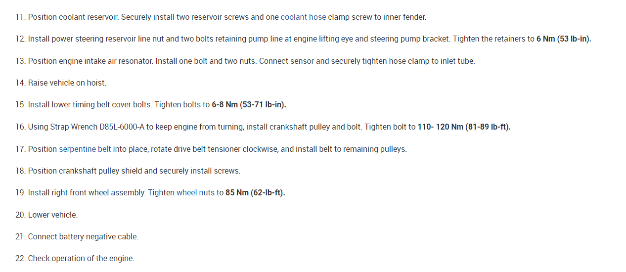

The camshaft timing belt needs to be removed. I am going to first give the directions for the pump replacement. After that, I will include the belt directions. You will need a couple of special tools to accurately time the cams. They are indicated in the directions. I believe you should be able to rent or borrow them from a parts store.
Once you get it back together, turn the engine several rotations to make sure there is no binding. If there is, don't force it. Instead, recheck the timing marks.
Interestingly, (and this is from memory) the 2.0 DOHC in a Contour shouldn't be an interference engine. However, the same engine in the Ford Probe was. So, that's why I'm recommending turning the engine several times first.
See pics below.

May 22, 2021 at 12:50 AM
Unfortunately, yes. Although it is driven by the serpentine belt, it is mounted to the engine block behind the timing belt. I have to be honest with you. It isn't an easy job on this vehicle. Make sure you are 100% sure the pump is bad.
I will try my best to help you from here, so don't worry about asking questions.
