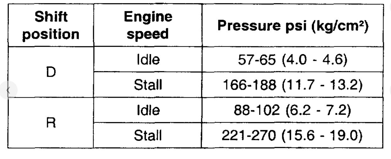

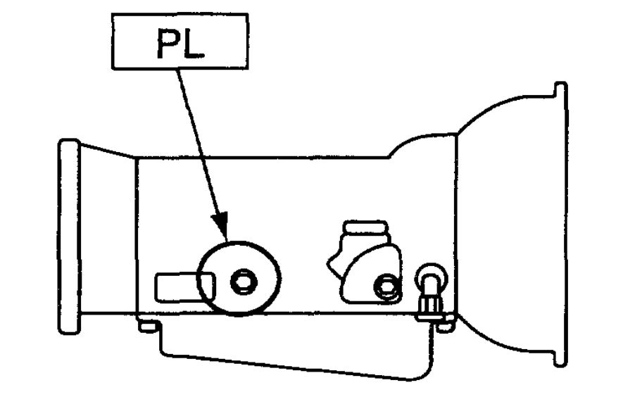

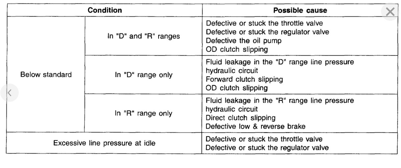

Line pressure is also key to the transmission to work. I attached the chart for the proper pressures.
You will need to rent a gauge for the testing.
If both of these are okay, then it has an internal failure.

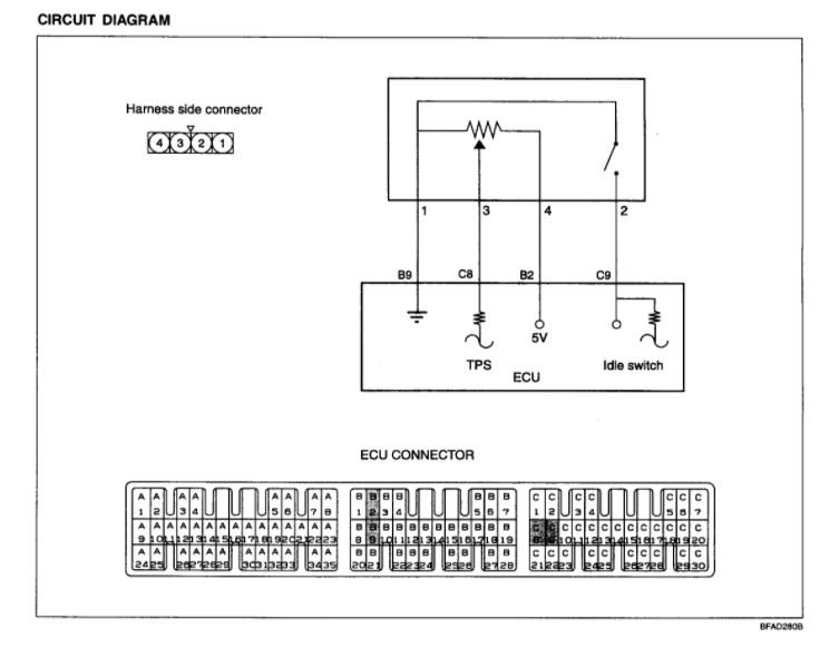

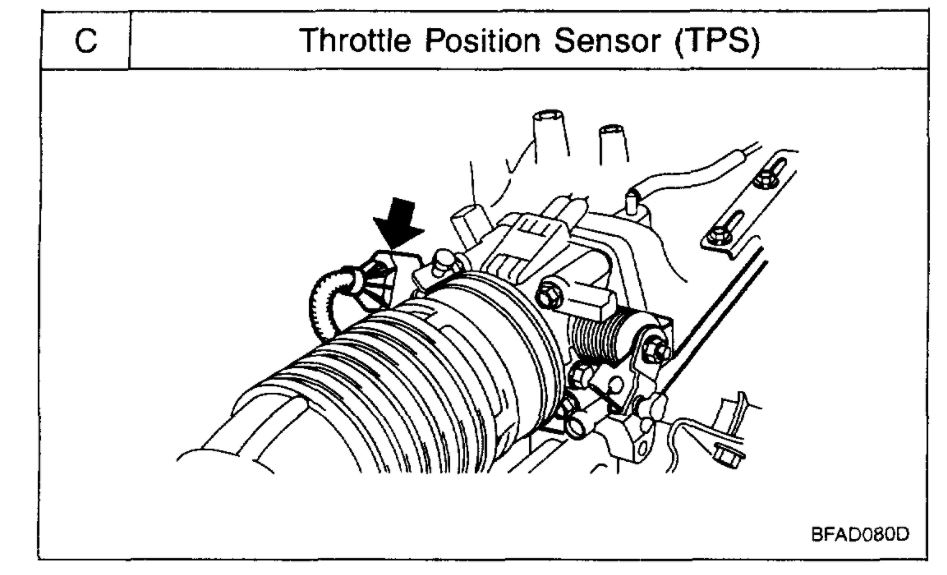

Throttle Position Sensor (TPS)
The TPS is a variable resistor type that rotates with the throttle shaft to sense the throttle valve angle. As the throttle shaft rotates, the output voltage of the TPS changes. The ECU detects the throttle valve opening based on this voltage change.
Circuit Diagram

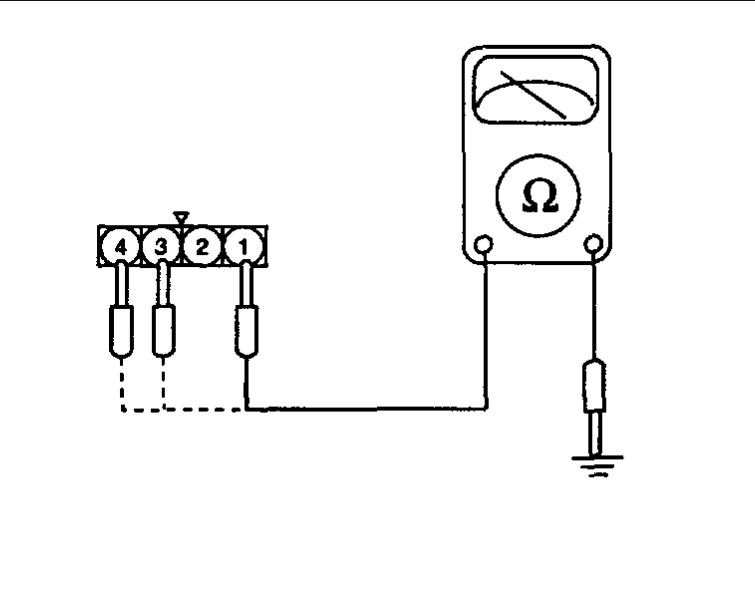

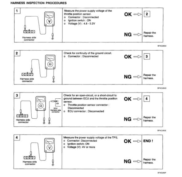

Harness Inspection Procedures
