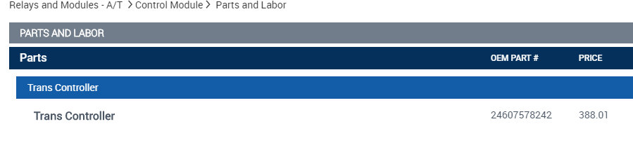

We need to start with checking fluid and then monitor the commanded gear with the scan tool. If the commanded gear is not achieved we need to inspect inside the unit for metal. Depending on these findings will direct where to go. If the transmission is following the commanded gear and they are not correct then the control module is the issue.
