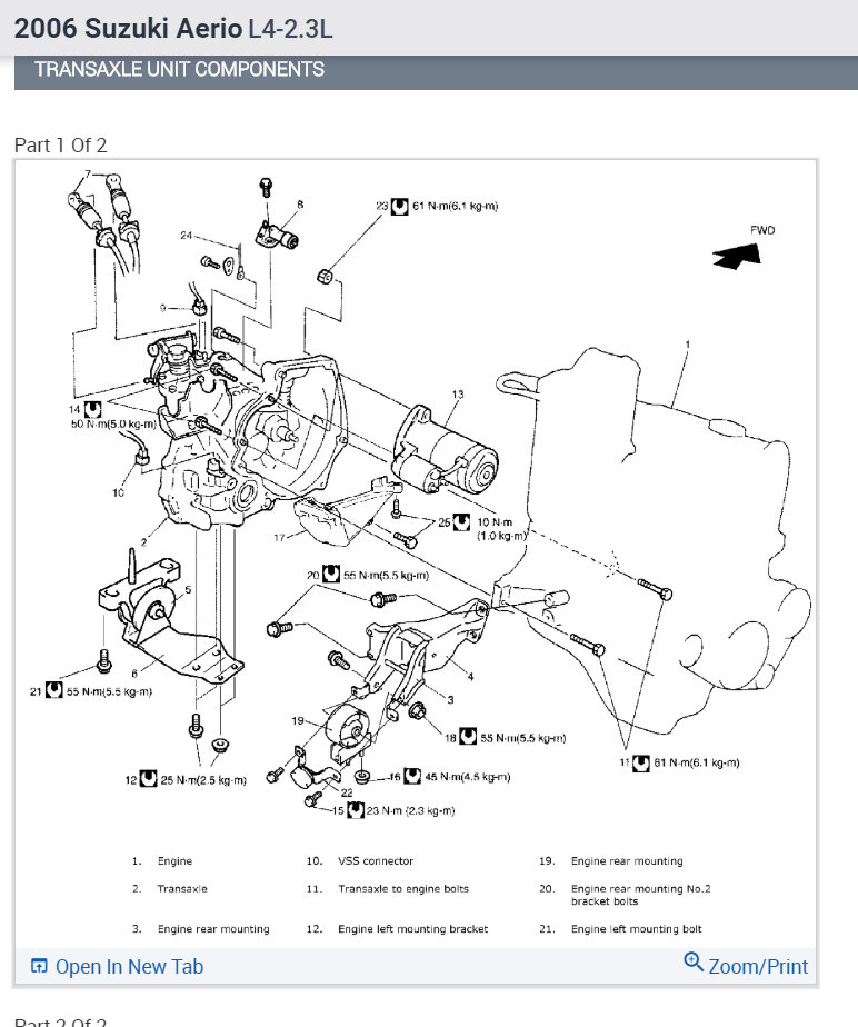

This can be the transmission mount that needs to be replaced because it is allowing the transmission to move around. Here is how to replace it in the diagrams below. Can you please shoot a quick video with your phone so we can hear the noise? that would be great. You can upload it here with your response. Check out the diagrams (below). Please let us know what you find. We are interested to see what it is.
