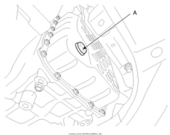

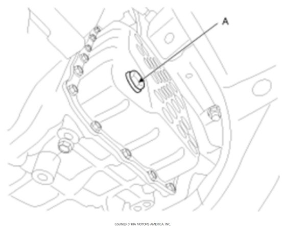

Hi, I found this for you, it looks like you have a plug in the side of the cover that determines the oil level
Let me know what you find out
