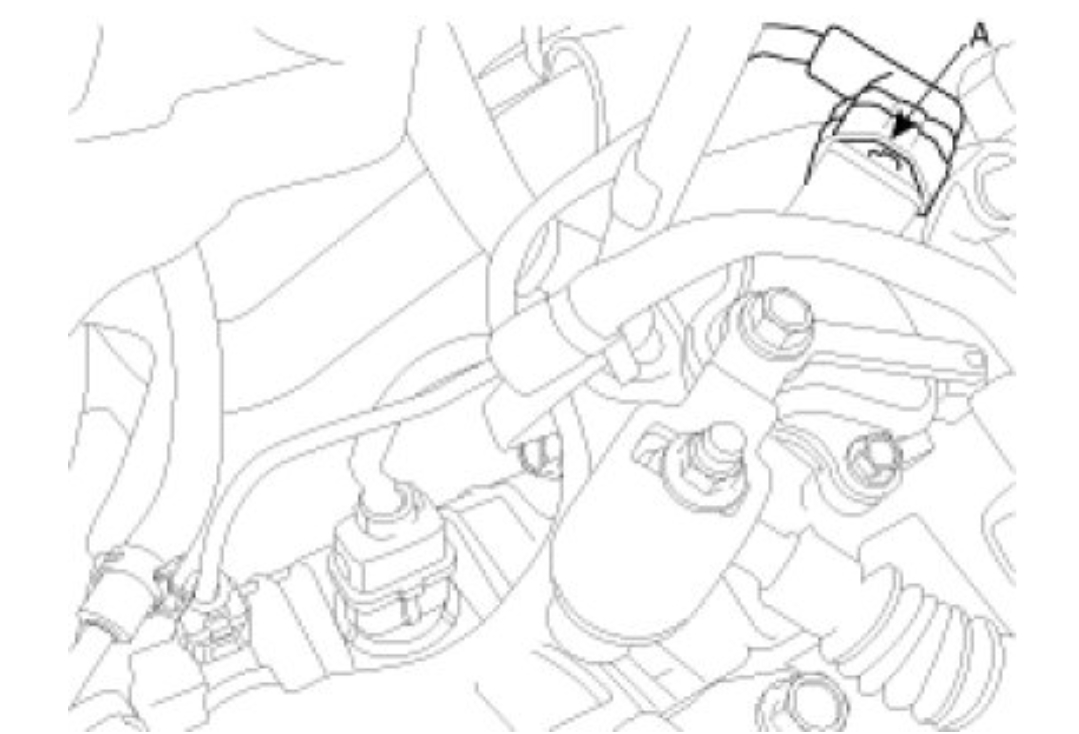

4. Remove the air cleaner assembly.
5. Disconnect the inhibitor switch connector (A).
pic 1

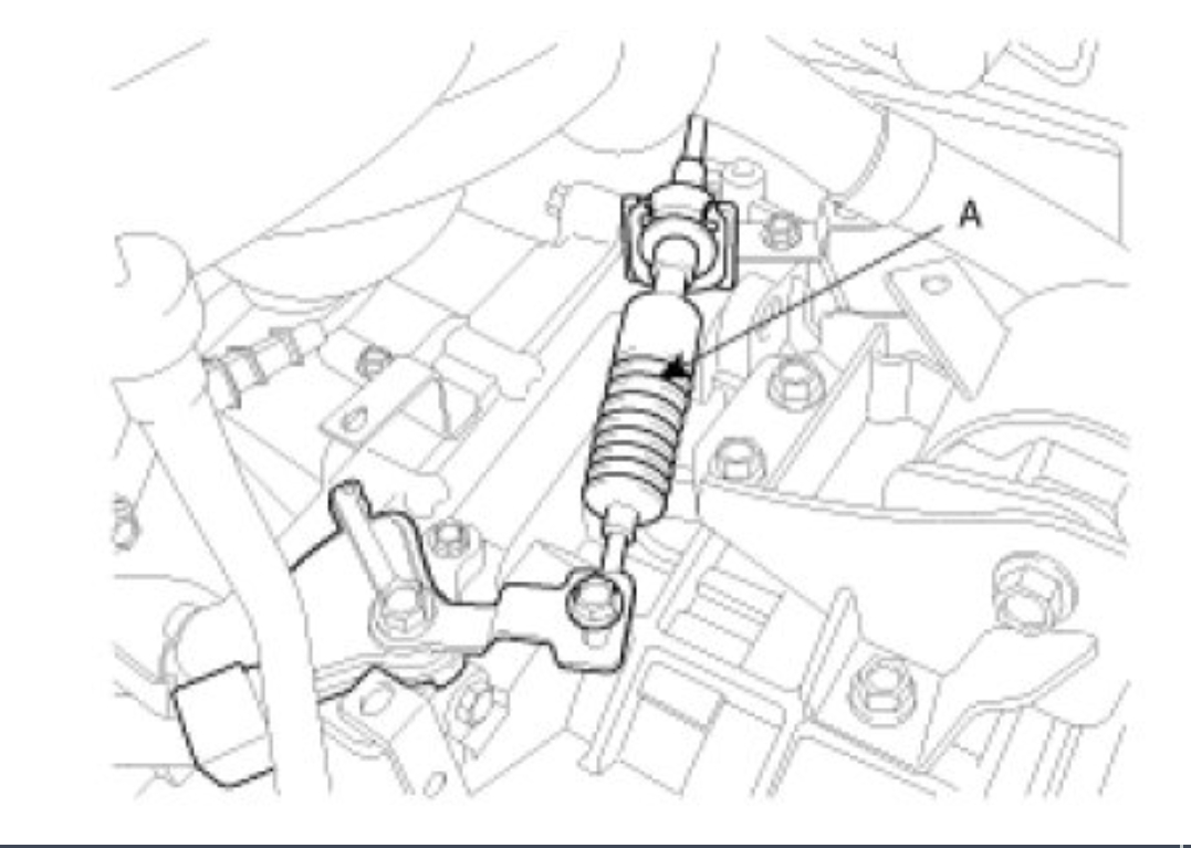

6. Remove the control cable(A) from the manual control lever.
pic 2

4. Install the control cable (A) to the manual control lever.
pic 3
5. Connect the inhibitor switch connector (A).
pic 4
