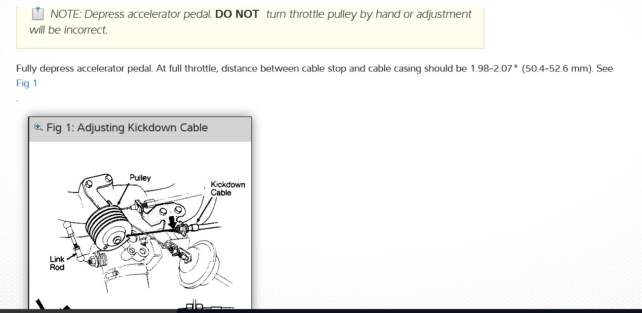

it is probably the throttle cable is not adjusted correctly or is binding. This seems to be quite involved to repair this right. If is to much for your husband to do, have a transmission repair professional do the repair. Measurement in picture is for kick-down. Also if transmission worked okay prior to repair then it is a problem with the adjustment.
