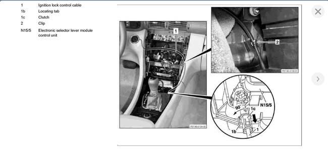

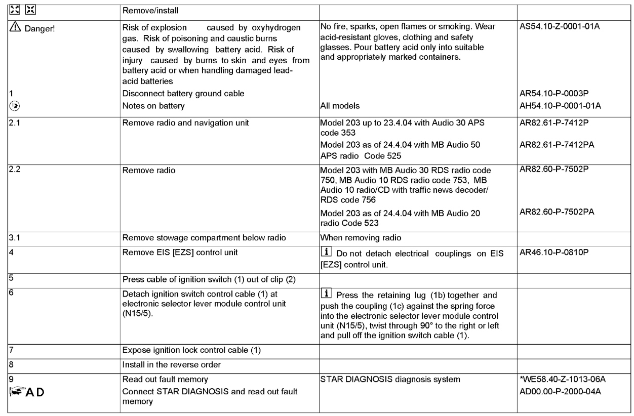

There is a shift interlock cable that sounds like is misadjusted are is not working right here is a guide to show you what to look for so you can find the problem.
