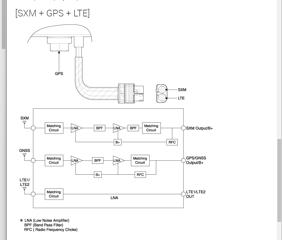

When you turn the GPS on, what does it say? Does the radio try to connect with the satellite but just does not do it or does it give a message?
Please see the attached below and let me know what style antenna you have on the top of the vehicle. This will help with confirming that this is the issue.
Lastly, I would suggest calling Hyundai and asking them if they are able to change the codes on their end or if they have a work around for this.
However, I suspect this is as simple as the vehicle cannot communicate with the satellites that are there in Egypt so I am not sure there is anything that we can do, and the solution will come from the dealer.
