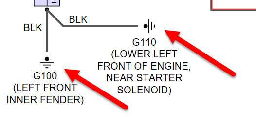

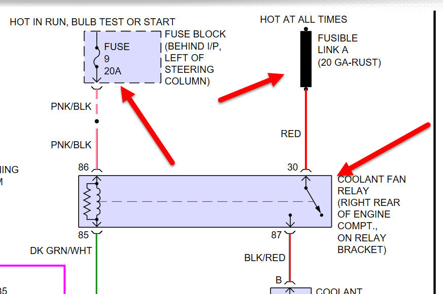

check fuses first under hood and in car you may have blown one that controls cooling fan. if you did not change the sensor from other engine check wiring it is at left rear of engine and has a purple and yellow wire leading to it. also, check items in picture.

I found fuse 9 20 amp was fried. Sent my son to buy a few. I will update when he gets back. thank you.

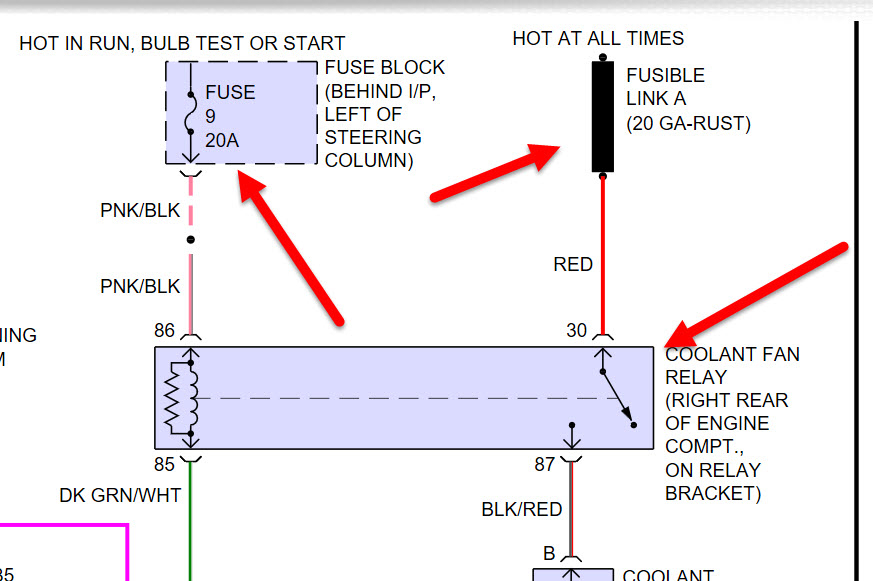

Do you have a wiring diagram for the number 9 fuse circuit? so I can try to figure out what is overloading it?

i am assuming that there may be aground off someplace and that the number 9 fuse is continuing to blow. picture shows what circuits it goes to however since it worked okay before and you replaced engine look for pinched wires and maybe a loose ground at lower left of engine where stuff grounds. it also powers gauges so that may be your problem.

replaced the radiator cap. the car ran fine last night again. We will be taking off the ground wires that connect to the transmission and clean the bolt and all the ground wires so we get a good connection.
