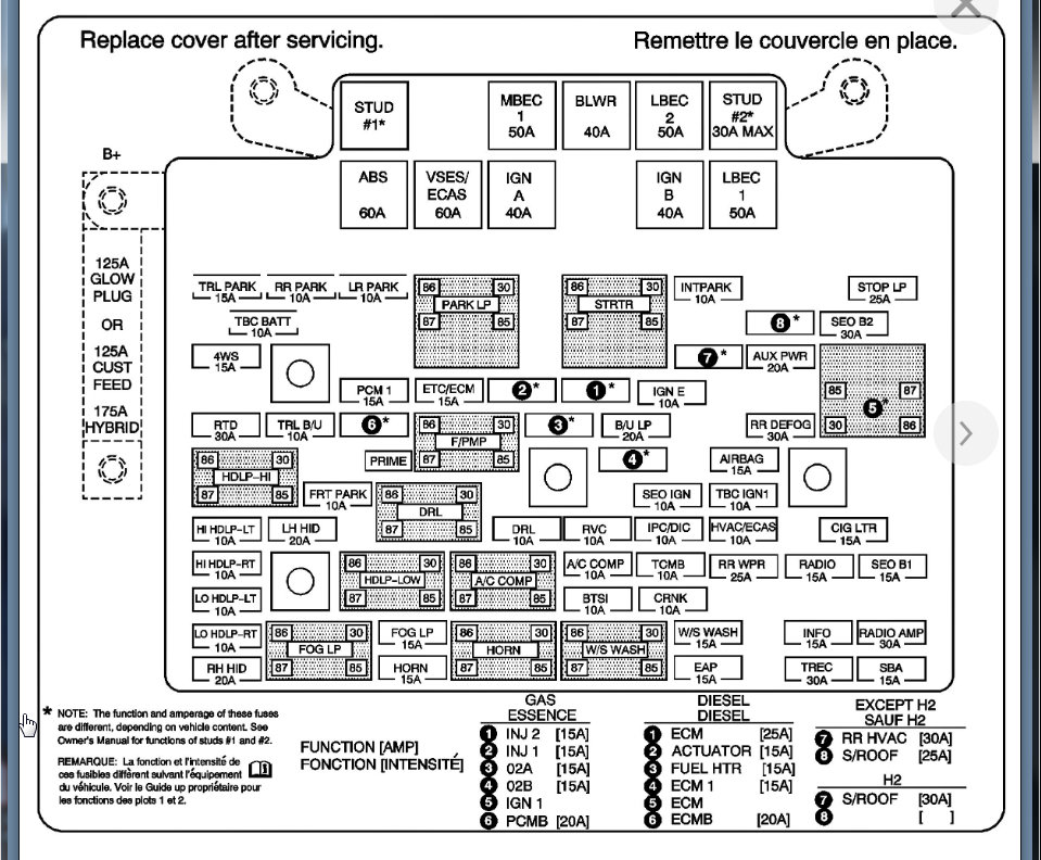

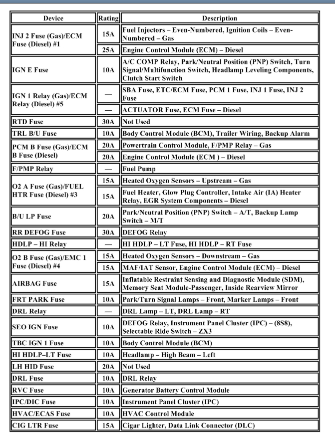

Before you go much further, you need to go through and check all fuses. I suspect you have a couple fuses that are blown causing this issue.
If there are no fuses blown causing this then we will need to start suspecting the cluster itself is the issue. However, before we get there we will need to do some testing.
Let's start with the fuses and move on from there because I think you will find some issues with these.
