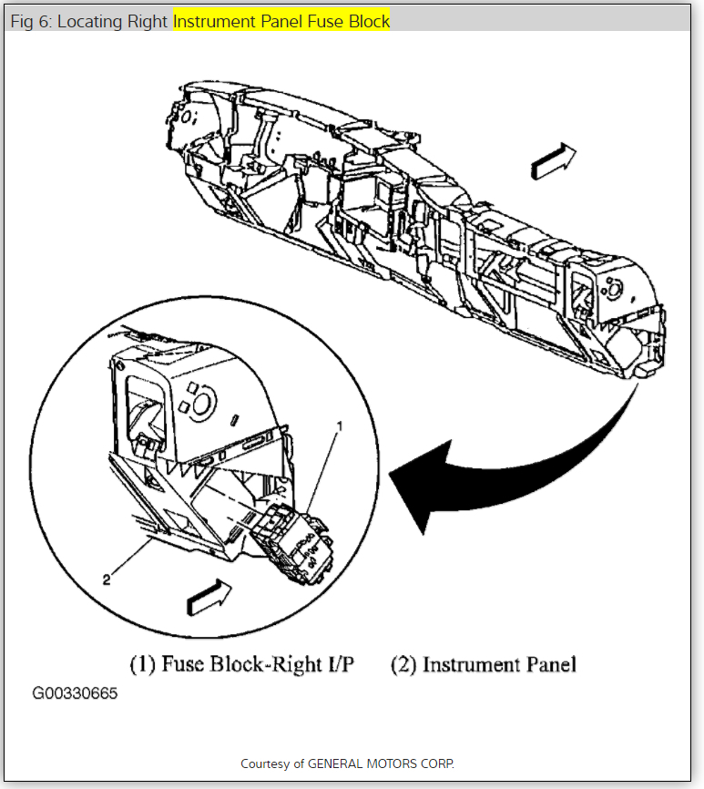

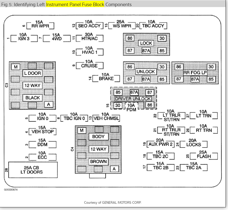

It sounds like you popped a fuse. To be sure lets check the fuses here is a guide with the fuse location in the diagrams below.
