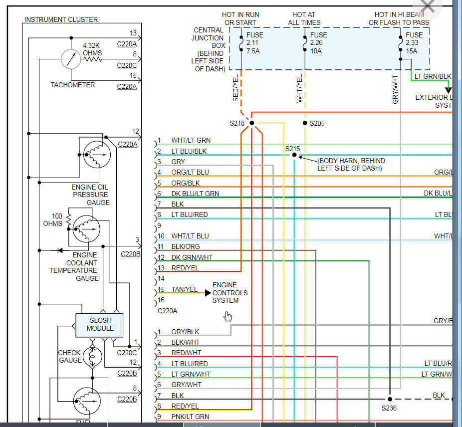

The speedometer, fuel gauge, and other gauges aren’t working. I may have mixed up a fuse when checking for another problem I was having.
Anyone know what fuse number I should check for the gauges going out?
Jan 2, 2020 at 10:58 PM

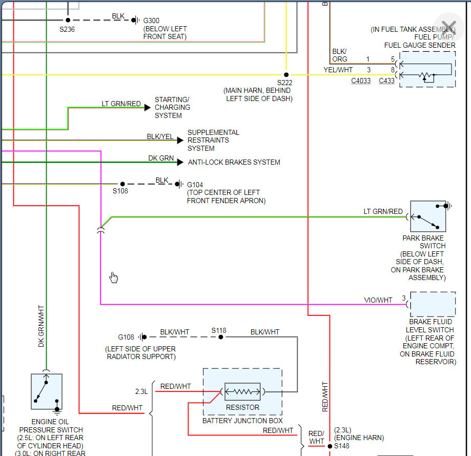

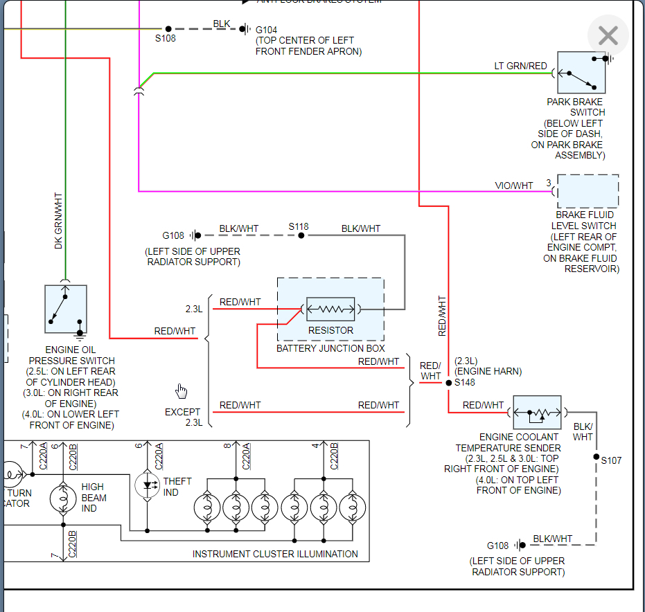

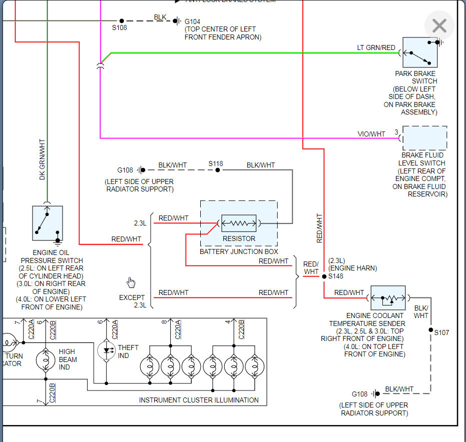

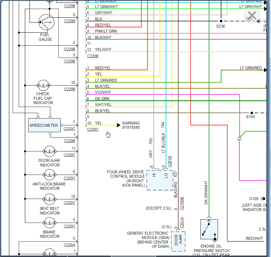

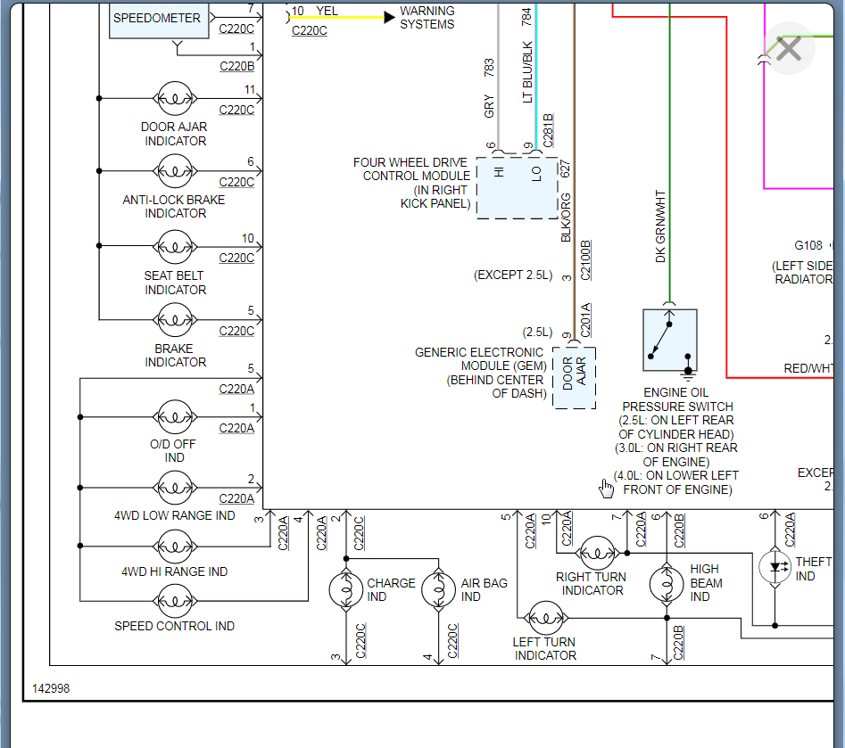

I attached the wiring diagram. Unfortunately there isn't one fuse for all the gauges however, part of the diagram are the fuses related to the cluster.
I suspect that the cluster is the main issue. If you mixed up fuses then it is possible that you put a smaller fuse in and it blew.
So I would check these fuses and if they are ok then I suspect the cluster has failed.
Let me know what you find and we can go from there. Thanks

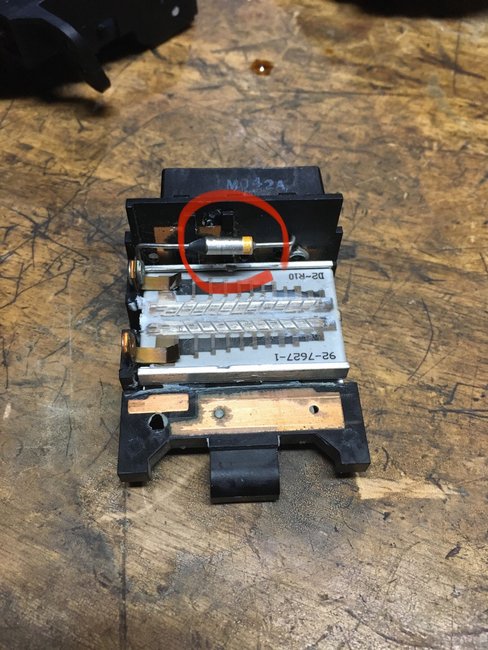

Hi folks,
I just got the truck listed above. The instrument cluster dash light not working and everything else is good.
No blown fuses ,then I took out the 4 pin instrument cluster dimmer switch and directly use a jumper wire to test the pins in the connector to dashboard. It works when I put the jumper wire between power wire pin and ground wire pin.
My conclusion is instrument cluster cluster dimmer switch is bad, but is it fixable? I got 11.7 ohm between this resistor, anyone knows what’s the standard spec of this resistor?
Thanks for any help!
Albert

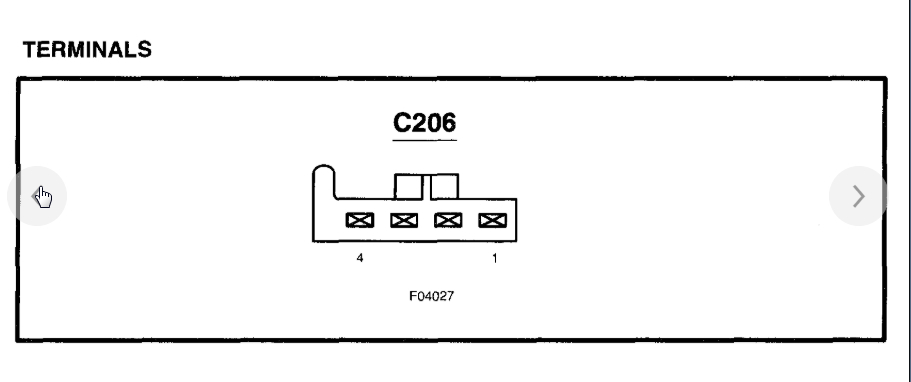

ALBERT CHIU
Here’s the one I took out. Thanks!
Dec 15, 2020 at 7:12 PM (Merged)

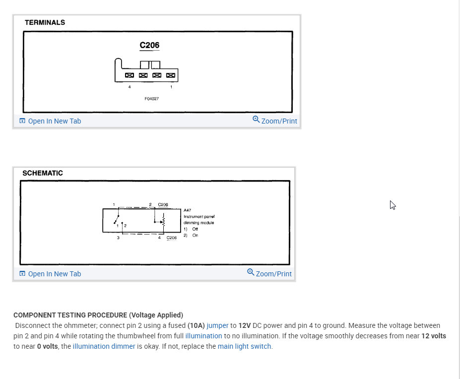

Sorry we don't what makes you think the resistor is bad? It looks like you have heat damage to most of the unit? I would just replace it.

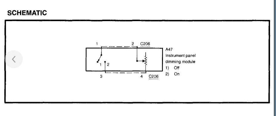

Here is the test for the dimmer. Unfortunately we don't have a spec for this resistor so the only way to know that is to check another one that works. They don't provide it because they don't expect people to rebuild them.
Clearly anything is possible but they are cheap enough that if it fails this test, it is better to just replace it.
Let me know if you have questions. Thanks

ALBERT CHIU
Thank you Ken and KASEKENNY1,
My first thought was wrong.
Finally got some time working on it today, the test was 50-50 situation. Then I figured out there’s some loosing connection problem and fixed it. I’ll keep it in service until it fails again.
