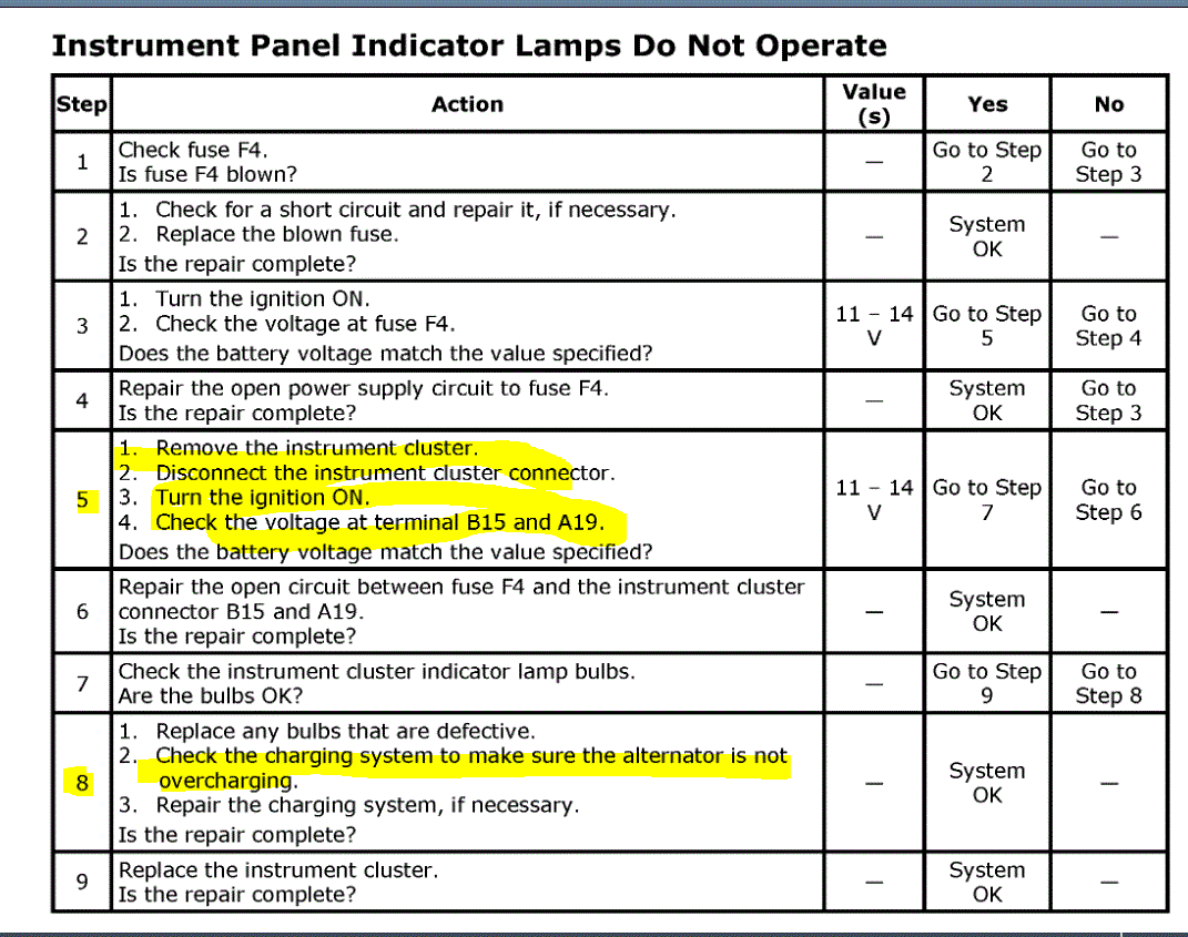

To me it sounds like the instrument cluster is failing However, I did look through common causes for failure. What I found is a lists of tests. One is to remove the cluster and check power to specific pins on the connector. Also, one thing that is mentioned I found odd. That is to check if the charging system is overcharging, which could cause the problem.
Take a look at the pic below at what I highlighted. Let me know if you are comfortable performing the test. Also, I need you to check the alternator output. Here is a link that explains how it is done:
