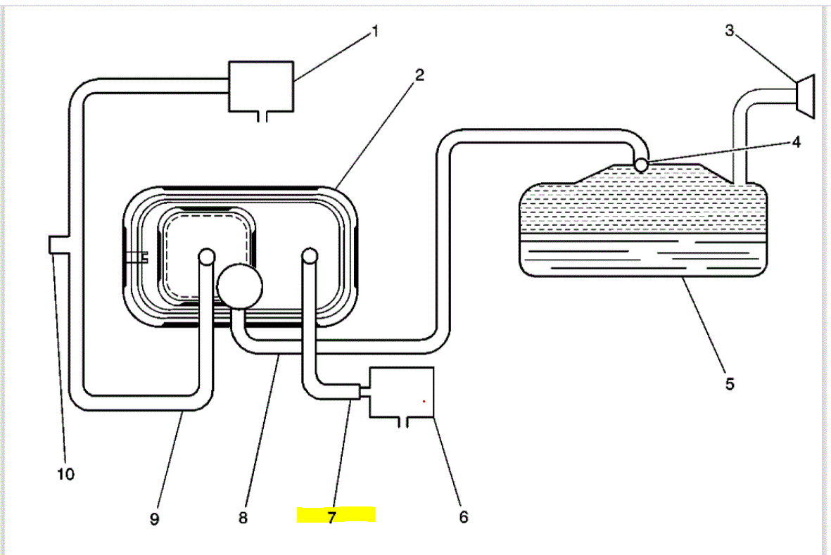

Code P0442 check engine light on, gas tank not purging, trips full sensor on gas pump
2004 PONTIAC SUNFIRE
120,000 MILES • 2.2L • 4 CYL • 2WD • MANUAL
QUICKTECH
  • 13 POSTS
P0442 Code check engine light on
1 Replaced the gas cap - made no difference.
2 Replaced the solenoid purge valve next to engine (aftermarket Napa Echlin) and it seemed to fix it for about 6 weeks , check engine light went off, was able to fill tank once normally.
3 Check engine light came on again, P0442 Code again, this time replaced the canister purge valve next to charcoal canister - check engine light turned off. There was no smell of gas and no pellets, tubing from canister to valve was clear.
4 A few days later tried filling tank - same issue gas pump clicks off over and over again.
what should I do next?
Mar 13, 2021 at 9:38 AM
The canister vent valve (#6 in pic) either is blocked or not working. Number 7 in the pic is the vent hose. When filling the tank, air needs to escape. If it can't, fuel can't enter. Check to make sure the vent hose isn't pinched. Also, let me know if the vent valve is what you replaced.

Yes, I replaced the canister vent valve and the vent solenoid. The check engine light has gone off after replacing the canister vent valve but tank still is not vented. I removed the hose completely between the canister and the canister vent valve when I replaced the valve. The car is due for emissions test next month so I am down to the wire. The only thing I haven't replaced at this point is the canister itself. They are supposed to "last the life of the car" according to research.
Mar 14, 2021 at 9:00 PM
They can last the life of the vehicle, but that doesn't always happen. I've seen them full of fuel from people overfilling the tank. At that point, they are done. If you disconnect the vent hose, does fuel enter the tank normally? Also, are there any codes still active?

Well, just attempted my next fill up. Pump clicked off within 2 gallons, but I slowed the stream down and was able to fill the tank at a slow rate without a click off. It's improved but not fixed. When I pump the gas you can hear the gurgling get louder right before it trips the pump off.
Mar 31, 2021 at 11:52 AM

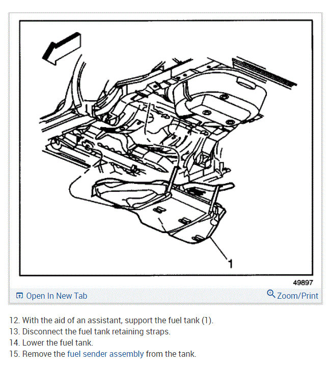

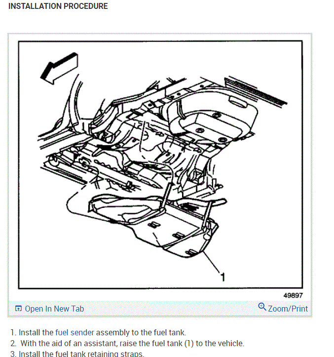

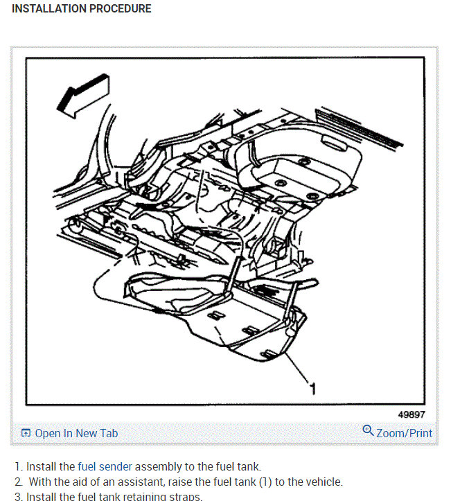

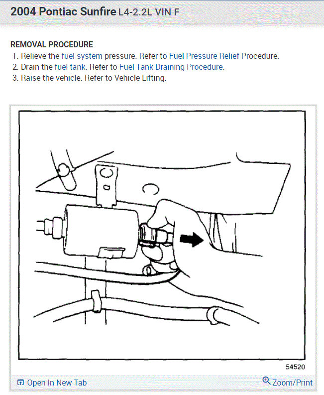

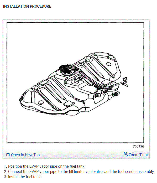

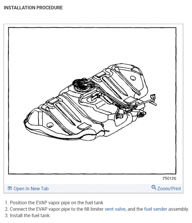

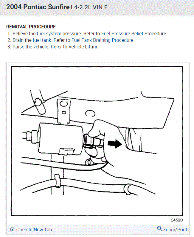

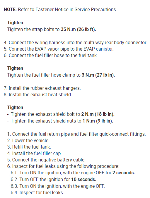

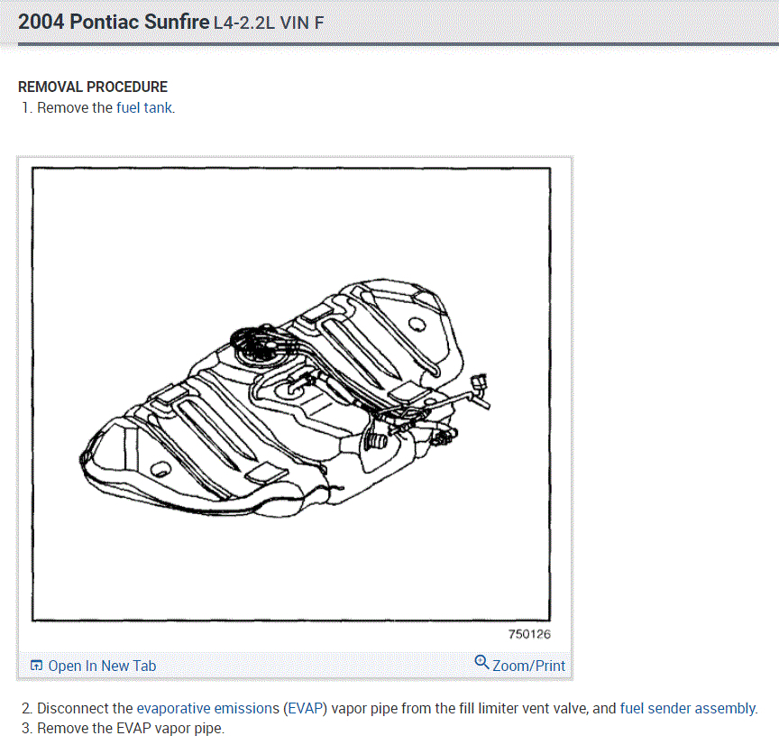

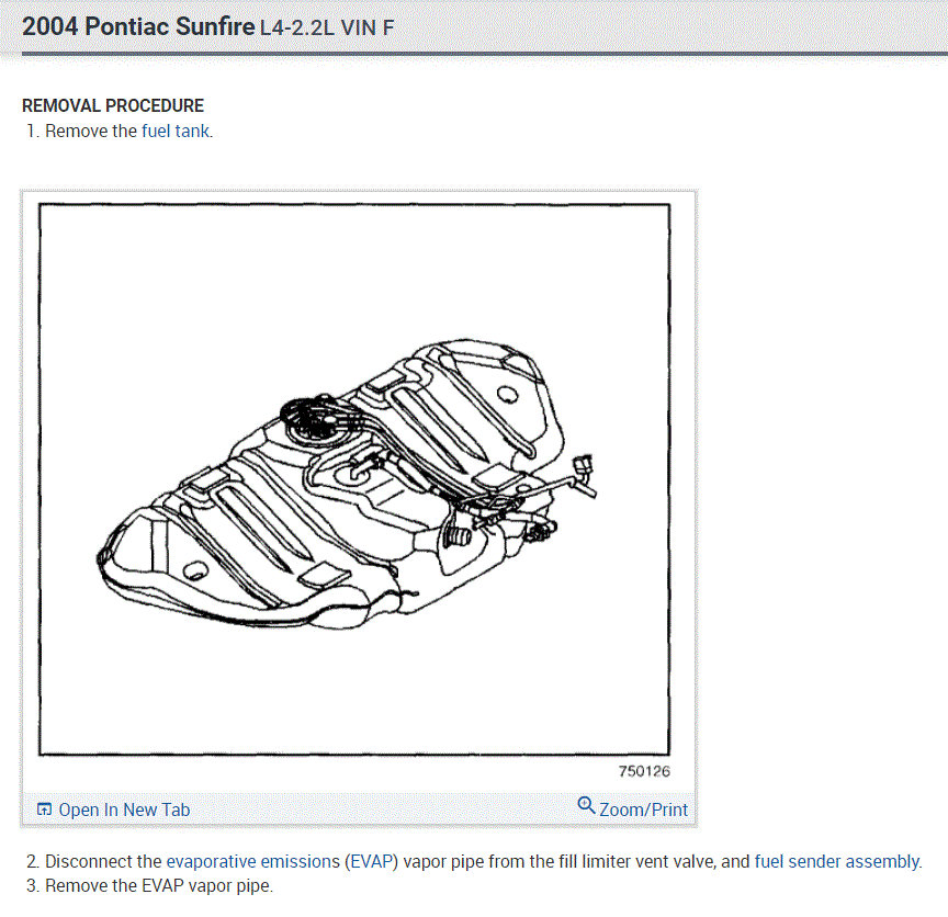

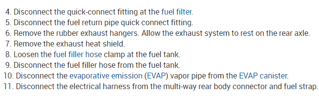

The sound gets louder because the fuel is raising up the filler tube. If you had it disconnected and it only helped a bit, then the problem has to be before the canister. At this point, you will need to remove the fuel tank and check the fuel limiter vent valve on the tank. I have a feeling it is stuck closed or partially closed.
The attachments below provide the directions and pics relevant for the removal and replacement of the fuel tank and the fill limiter vent valve.
If it is still doing a similar thing, either the hose from the tank is plugged or the vent is not working.
___________________________
Let me know if this helps.
