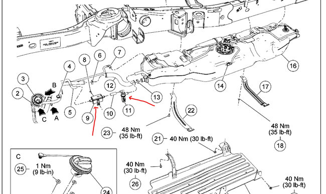

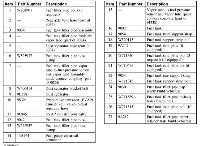

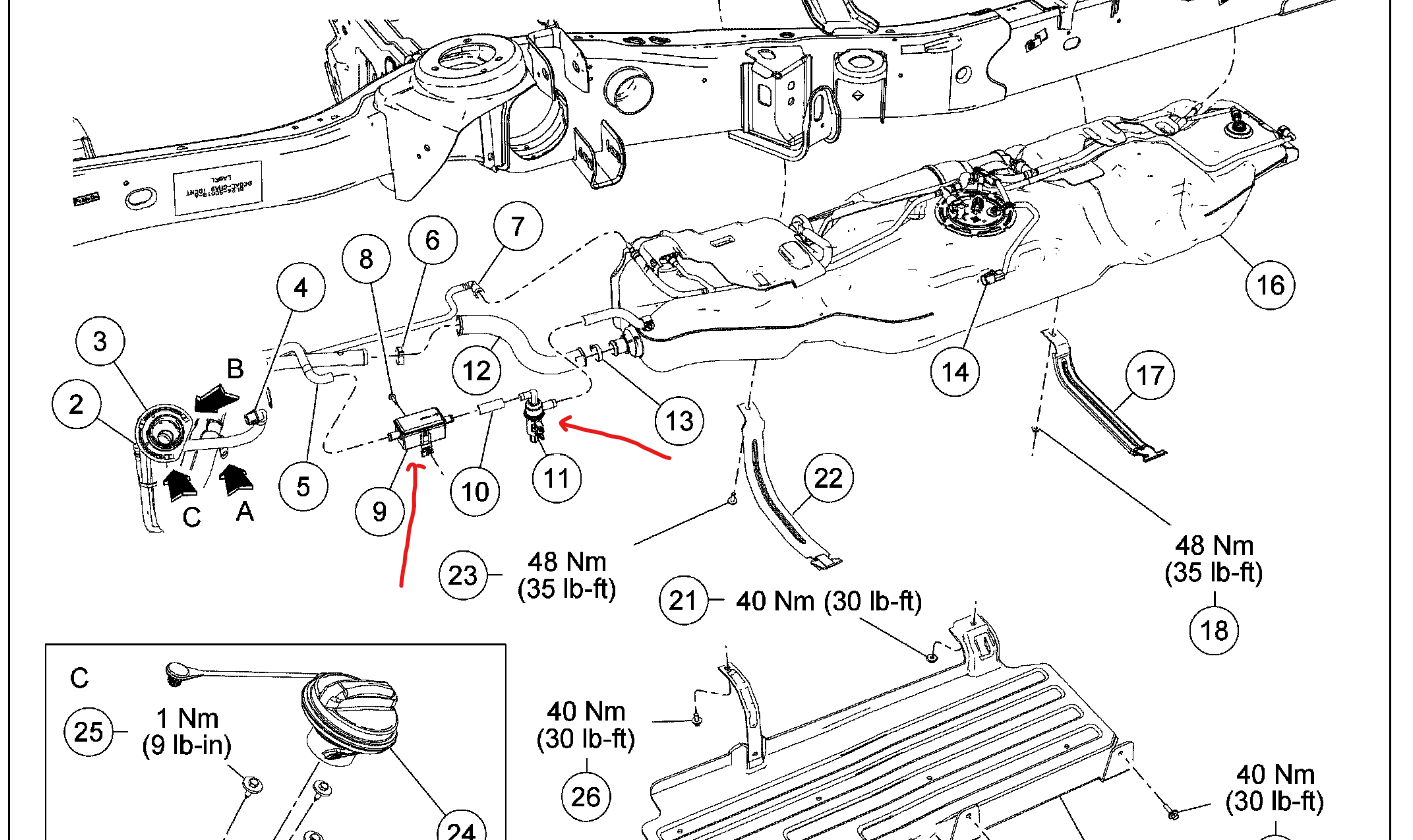

There is a dust separator I would check for blockage, or it might not be working, also double check the vent hoses to make sure there is now a kink in the hose and look at the EVAP canister vent valve. If you temporarily remove the vent line and try to add fuel this should tell us if it is a vent issue, or the main fuel filler tube is having an issue. Please start a new thread for the fuel gauge issue. Check out the images (below). Please let us know what happens.

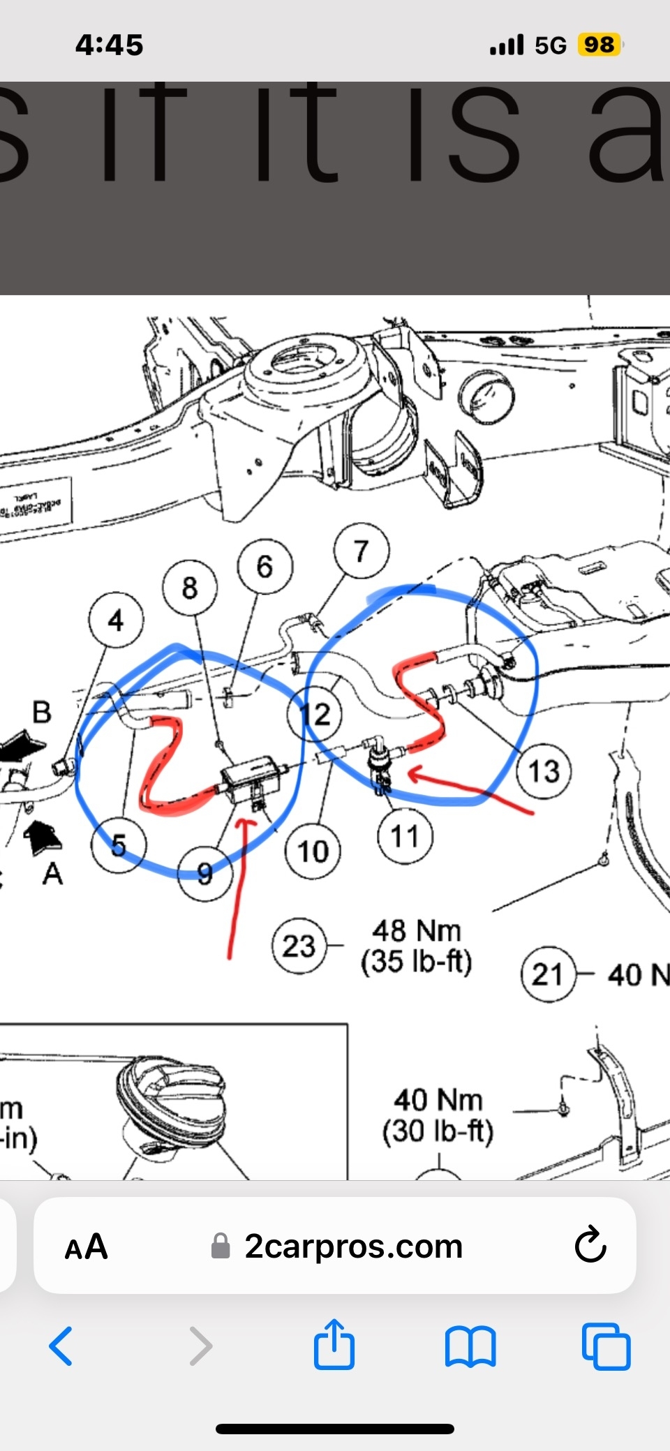

It doesn’t seem to be a kink in any of the hoses. I unplugged the hoses to the vent valve and the dust separator. (Please see the attached picture) and I went to fill up at the gas station and I’m still having issues pumping gas.

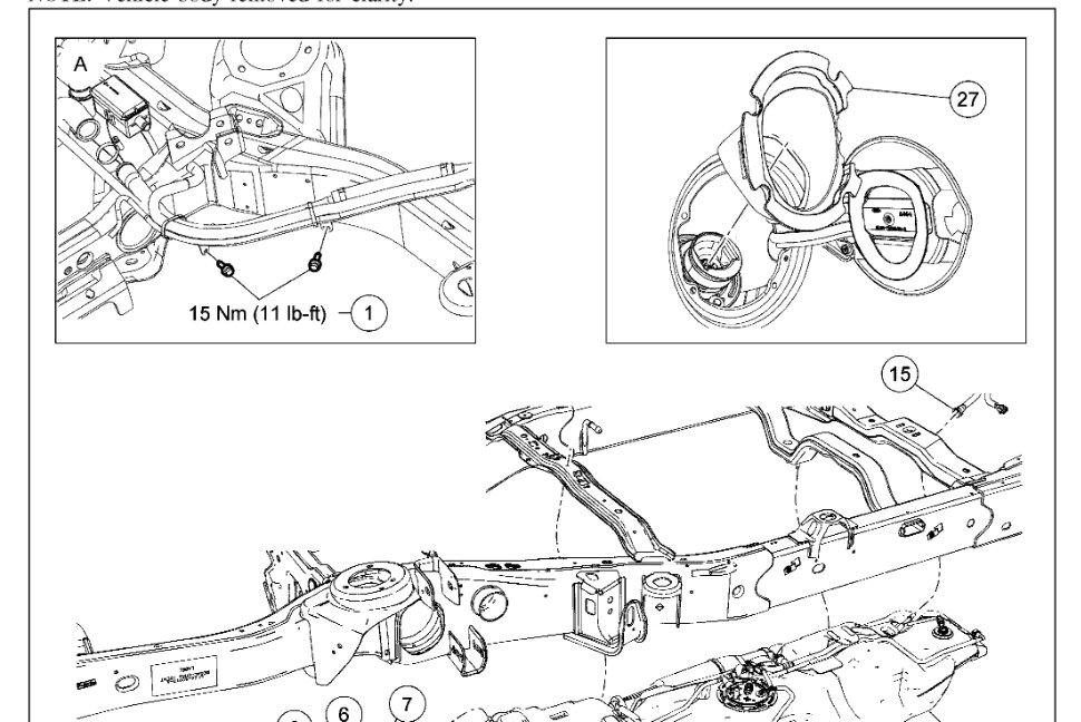

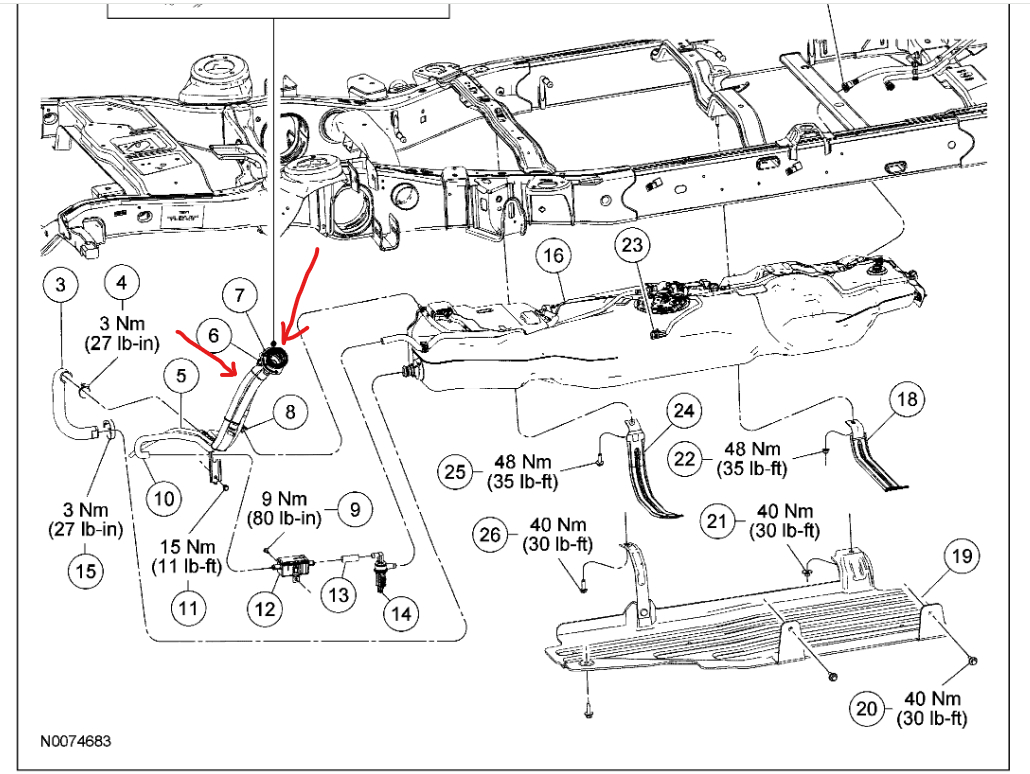

Okay, then the blockage must be in the fill or vent tube itself, also, some fuel tanks have a anti-roll over valve in the tank that might be stuck, do you remember seeing it when the tank was out? I would remove the filler neck and vent tube for inspection. Check out the images (below). Let us know how it goes.
