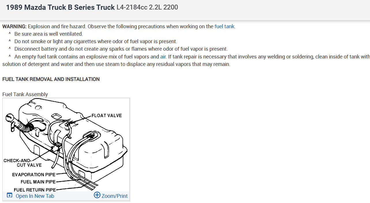

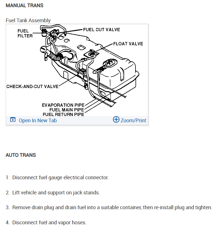

You probably have a fuel pump that is going out, also I would replace any lines that are dry or cranked which should take care of the problem. here is how to replace the fuel pump. Check out the images (below). Please let us know what happens.
