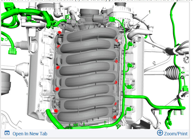

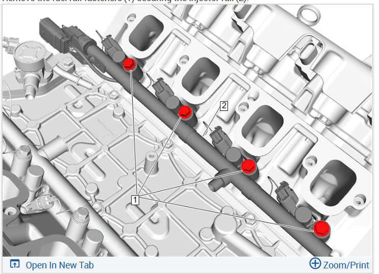

Yes, this happens when a fuel injector starts to leak, you do need to remove the throttle body and intake manifold to get to them to check the fuel injectors. Here are the locations of the injectors so you can use a flashlight to inspect them for leakage once the intake has been removed. Check out the images (below). Please upload pictures or videos in your response of any problems.

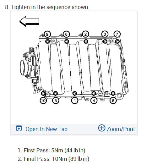

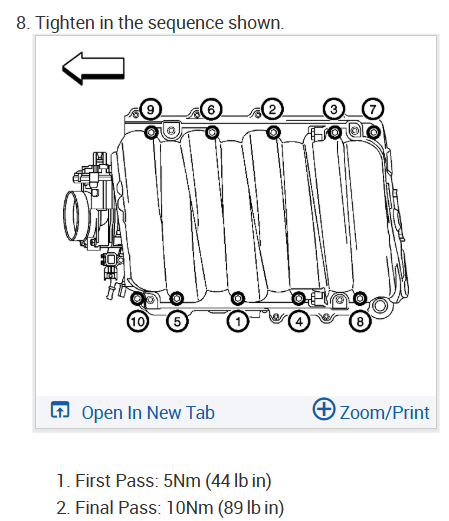

Can you send the schematics to remove the throttle body and the manifold? I have a pretty good idea of how it comes apart, but I would like to have the schematics too. You know just in case there's this random hidden bolt you can't find. LOL
Jun 16, 2025 at 11:14 AM
No problem, the throttle body you can leave on the intake and take it off all in one piece. Check out the images (below). Let us know how it goes.
