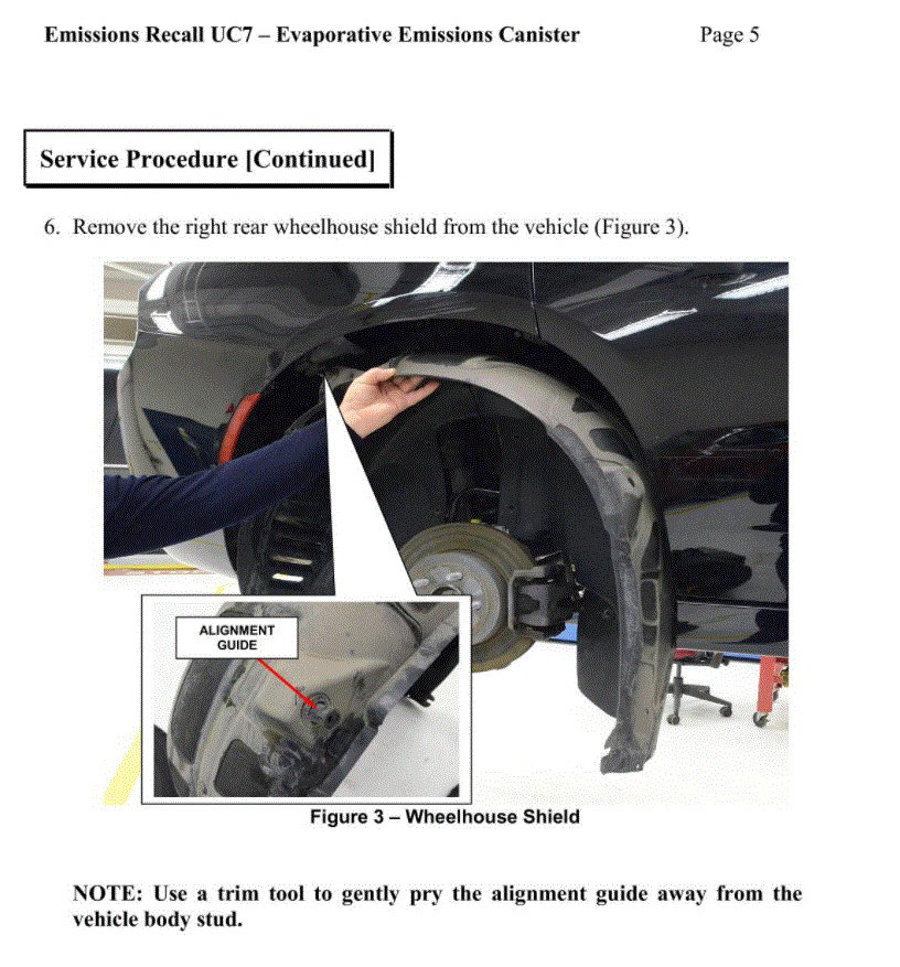

There are several places that the smell can come from. Can you tell an approximate area on the vehicle where the smell seems strongest or where it seems to come from? For example, it could be from the fuel tank, under the center of the vehicle where the fuel lines run, under the hood, and so on.

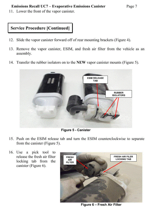

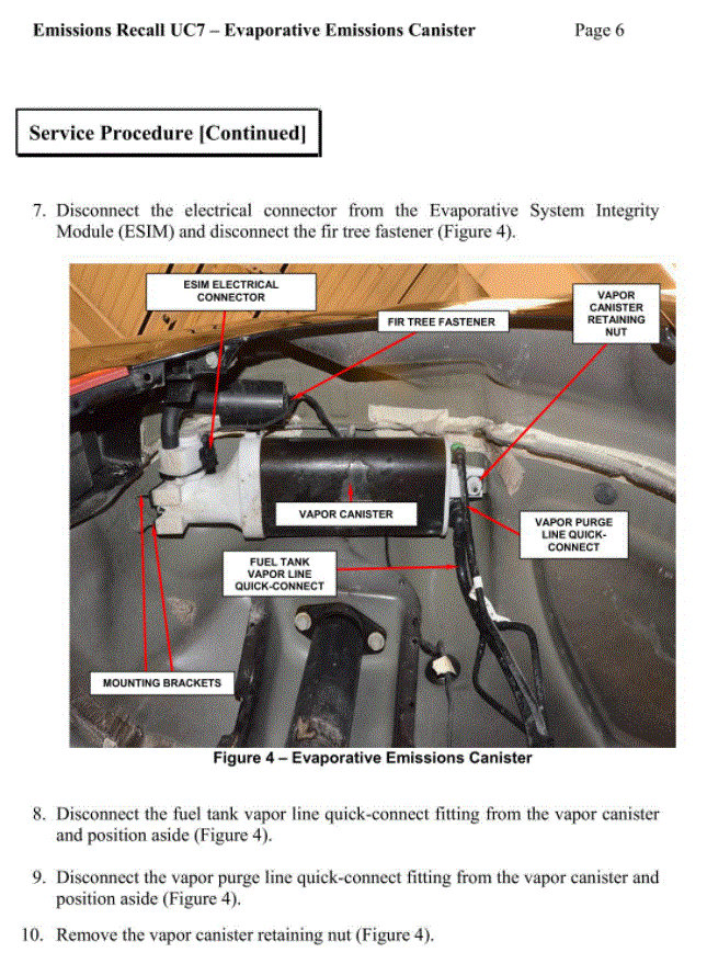

Also, there is a recall on the evaporative emission system (EVAP) charcoal canister. If I had to guess, I have a feeling that is where the problem is located. The canister is located behind the passenger side rear inner fender liner. See if the smell is stronger in that area.
I attached the recall and directions for repair. Take a look through it. If you haven't had this recall completed, have it done.
Let me know if this helps or if you have other questions. Also, let me know what size engine this has. Is it the 3.6L or the 5.7L?
See pics below.

Went on Mopar's website and it says that that recall has already been completed in 2019.

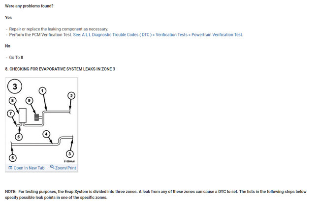

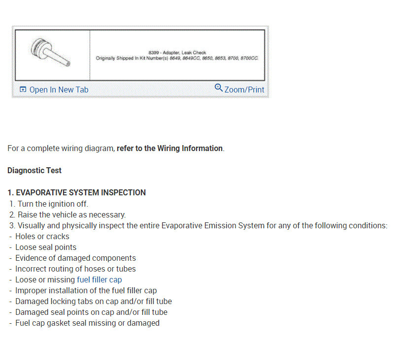

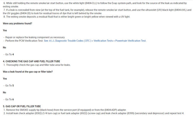

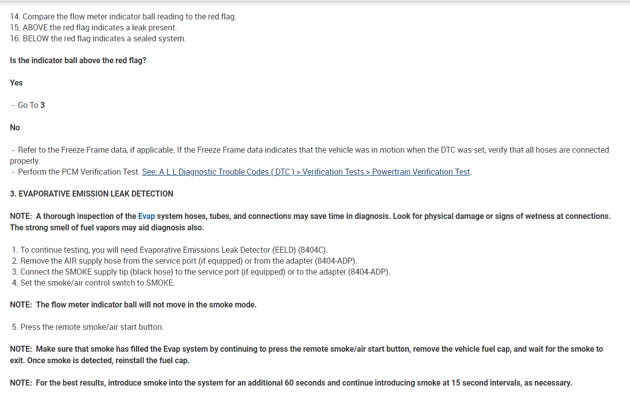

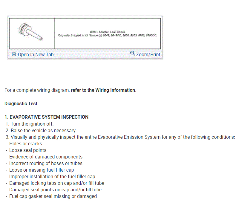

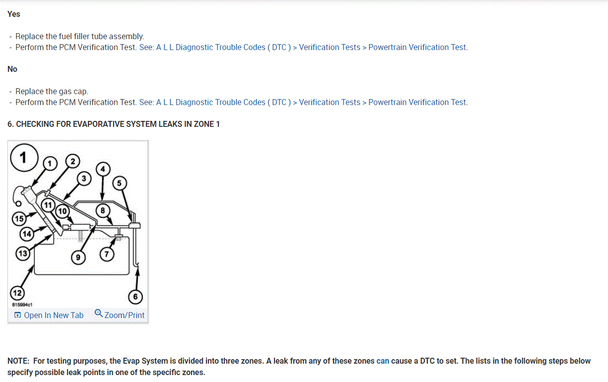

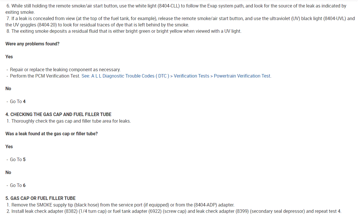

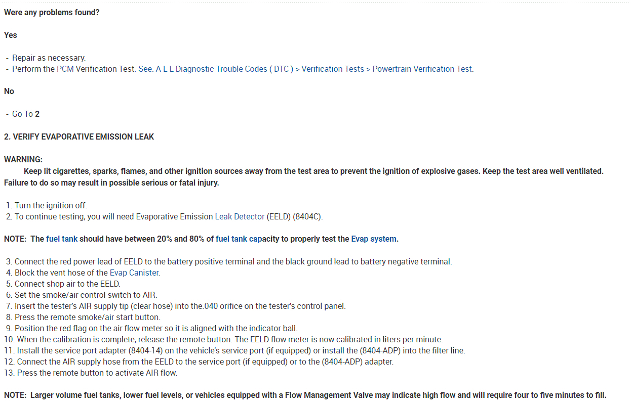

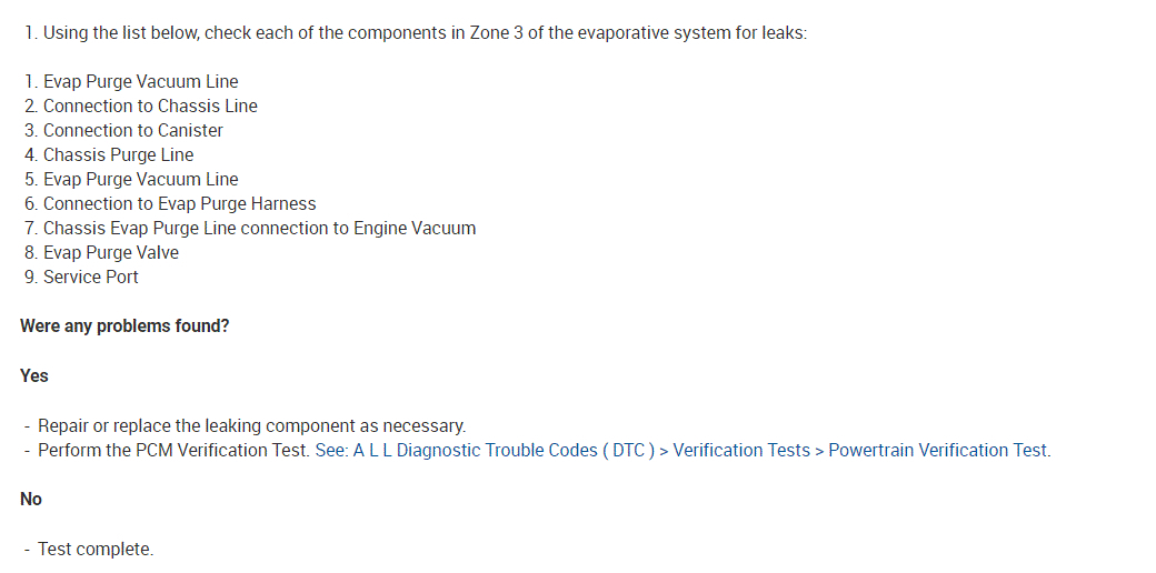

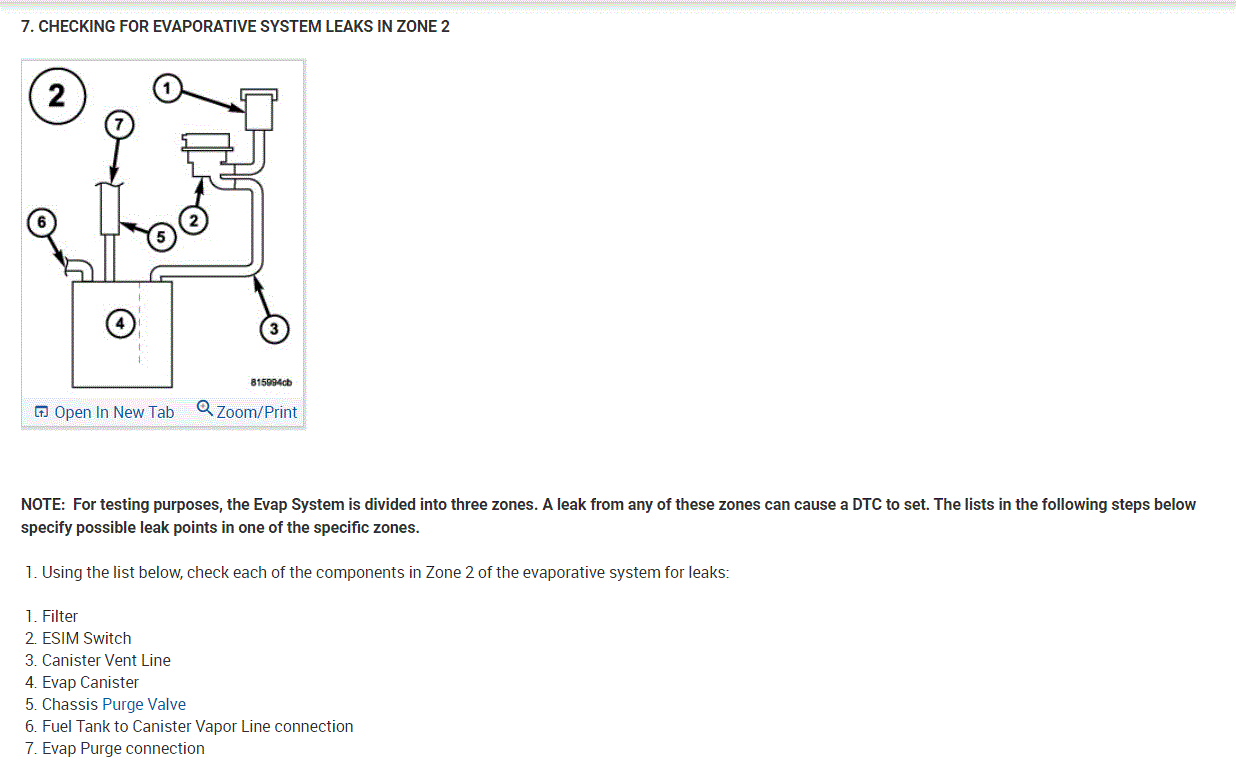

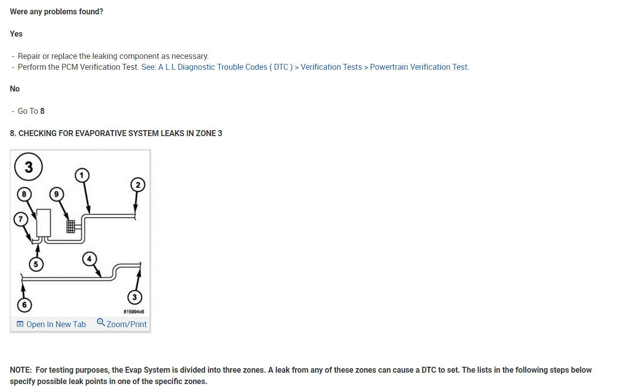

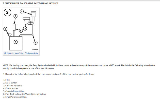

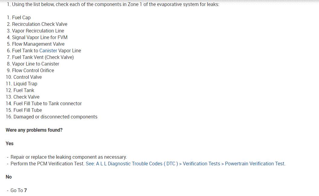

If it is happening when you fill the tank, I feel somewhat confident it is related to the evap system. The next time you notice the smell, see if it is coming from the fender area I mentioned. Since the smell gets into the vehicle, see if it is coming through the vents which would indicate it's under the hood. You just may not notice it when you open the hood.
Other issues with the evap system such as a leak, should turn on the check engine light. If that has happened, retrieve the codes and let me know what they are.
If there is an evap leak, I attached the diagnostics below for smoke testing the system.
Let me know if this helps.
See pics below.

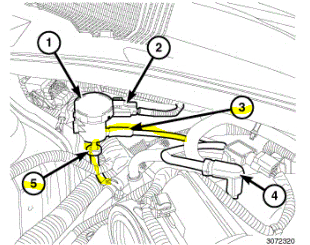

Also, I want you to check one other thing, the canister purge solenoid. It's located under the hood. I realize you don't notice the odor outside of the vehicle, but because of the physical location of this component, it could be coming straight into the vehicle.
It is mounted high on the firewall under the hood. Take a look at the pic. Check the vacuum hoses I highlighted. Make sure they are properly attached and there is no evidence of damage to either of them.
See pic below.

Sorry I haven't gotten around to checking that. However, I don't smell the gas anymore ever since the day after putting the new air filter in, maybe that was the problem all along! The old one did look really gross, so I wouldn't doubt it.
Sep 30, 2021 at 7:41 AM
That's good to hear. If the filter was really plugged, it would have caused the air/fuel mixture to be rich (too much gas/not enough air). It may have been running rich enough that you were smelling something.
