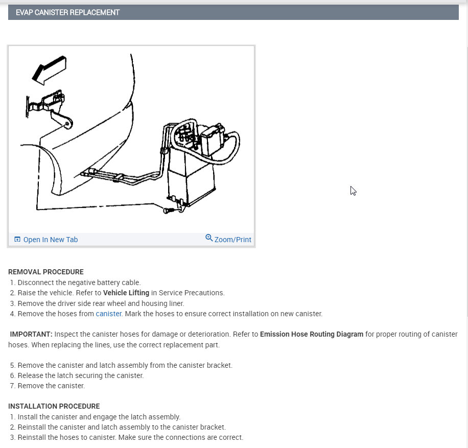

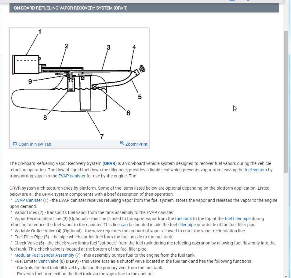

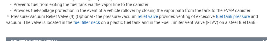

Next is the vent tubes of the fuel tank and fill neck to the canister are clogged. Or the canister itself is full of fuel. If this is the case then when you fill the tank the fuel creates a seal and the vapor cannot be vented to the atmosphere so it has to be routed the to ORVR system described in the attachments.
I would remove this and blow air through the lines and then check the canister by shaking it to see if it has fuel in it.
