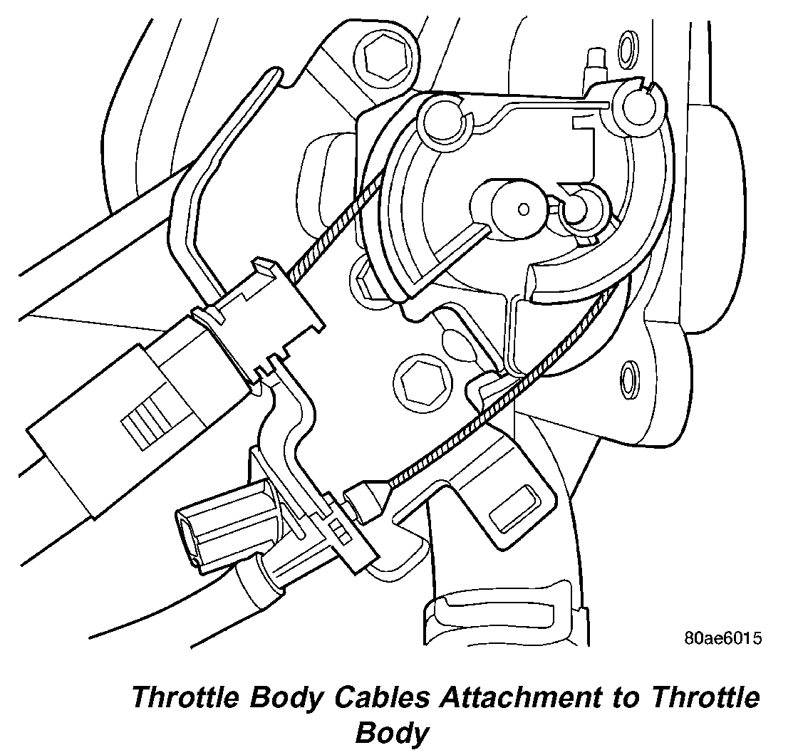

Throttle Body Cables Attachment To Throttle Body
See Picture 1

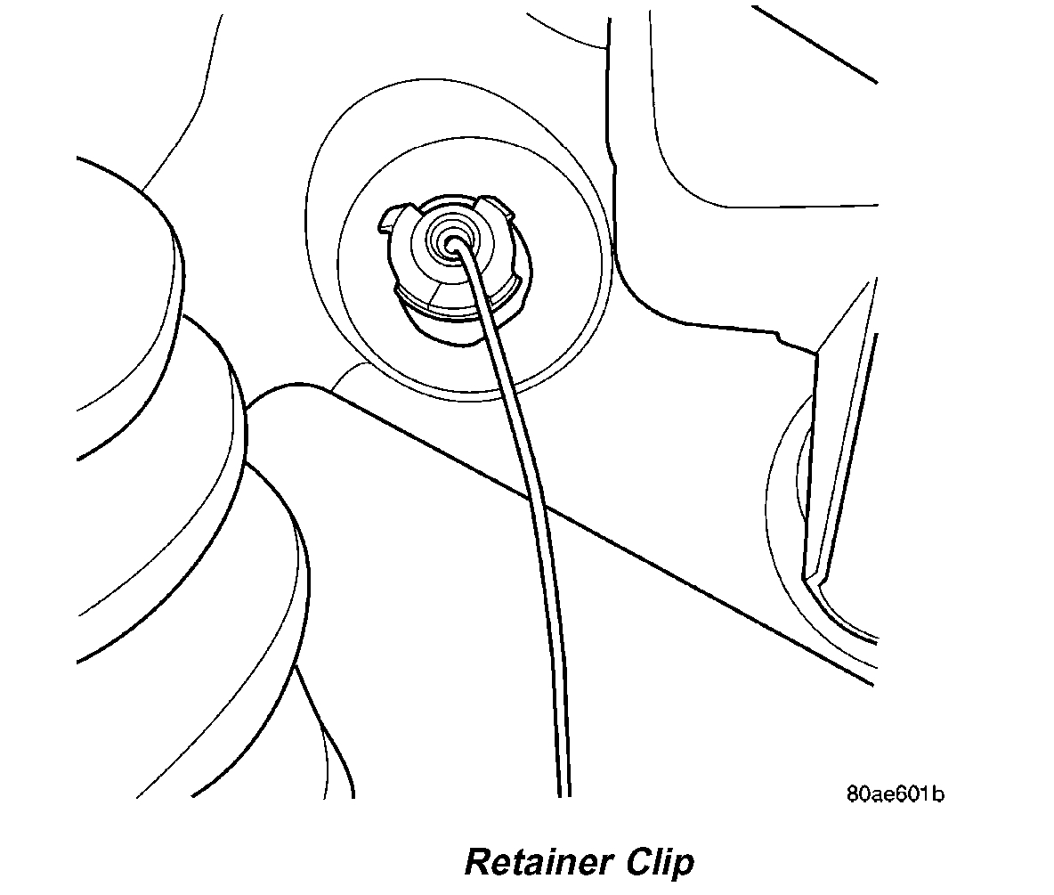

Disconnecting Throttle Cable
See Picture 2
2. Working from the engine compartment, remove throttle cable from throttle body cam .

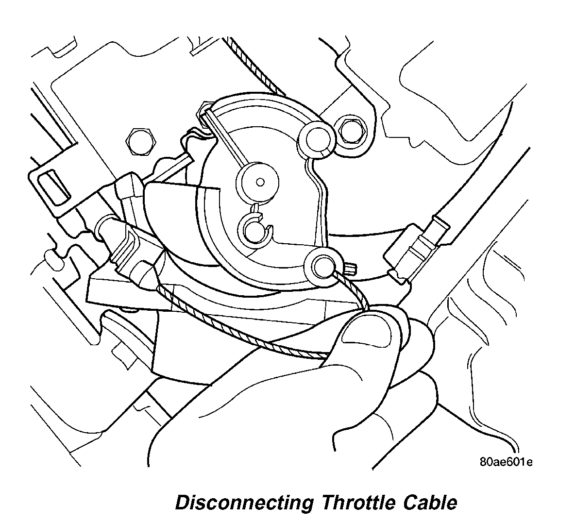

3. Lift the retaining tabs on the cable and slide cable out of bracket.
Locking Spring Tab
See Picture 3

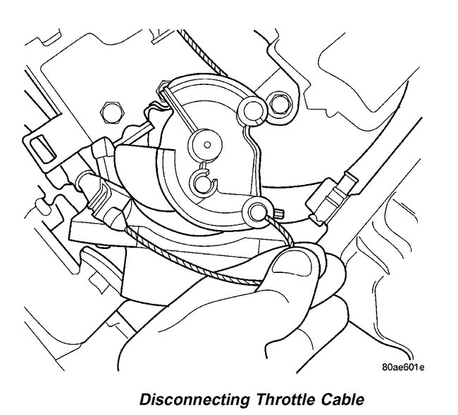

4. From inside the vehicle, hold the throttle pedal up and remove the cable retainer and cable from upper end of pedal shaft.
Retainer Clip
See Picture 4
