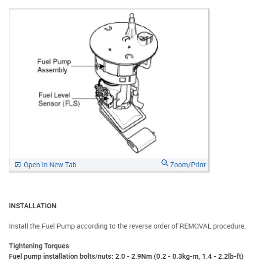

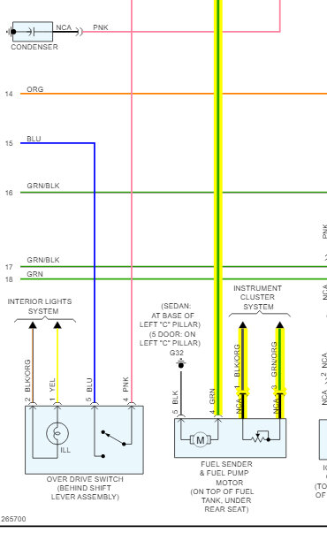

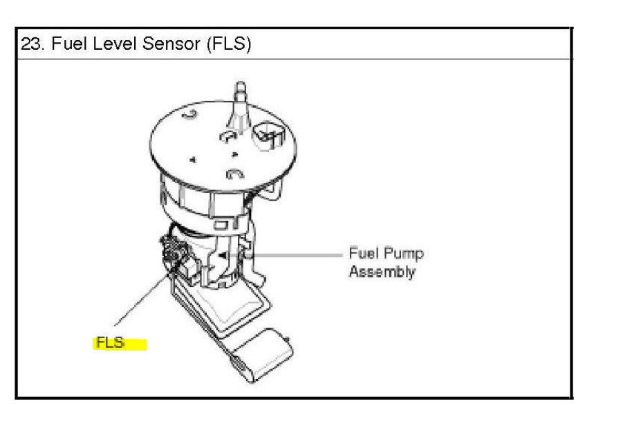

This issue could be due to a faulty fuel level sending unit. The fuel level sending unit consists of a resistor panel and a float. As the float moves up/down it registers a different value on the resistor panel, that gets sent to the gauge.
Over time the resistor can go bad and send incorrect signal to the gauge.
The level sender is part of the fuel pump.

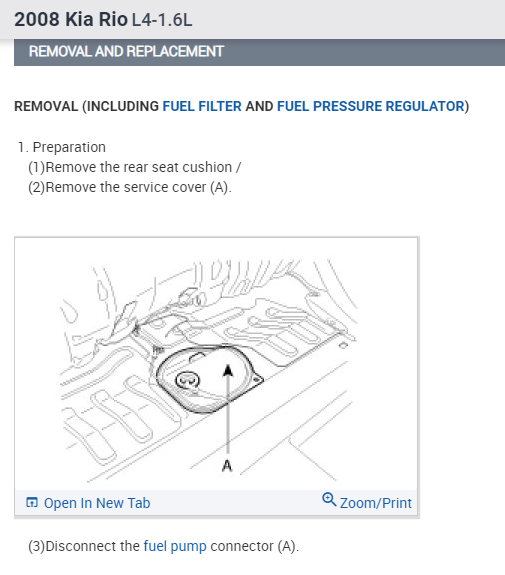

I have attached diagrams below for your reference.
Let me know of any questions.

Was there any corrosion of the fuel pump connector?
If the signal wire for the level is corroded or loose it won't send the signal to the gauge.

The signal wire might have too much resistance due to corrosion or heating up. That could be why it reads correct when you shut off and turn back on.

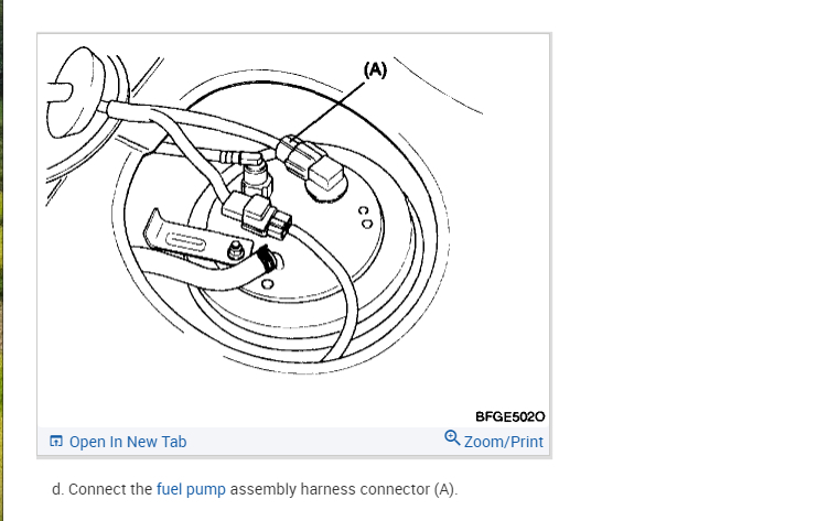

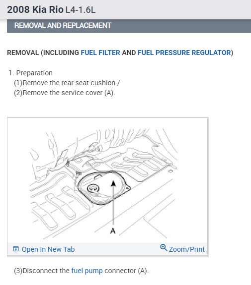

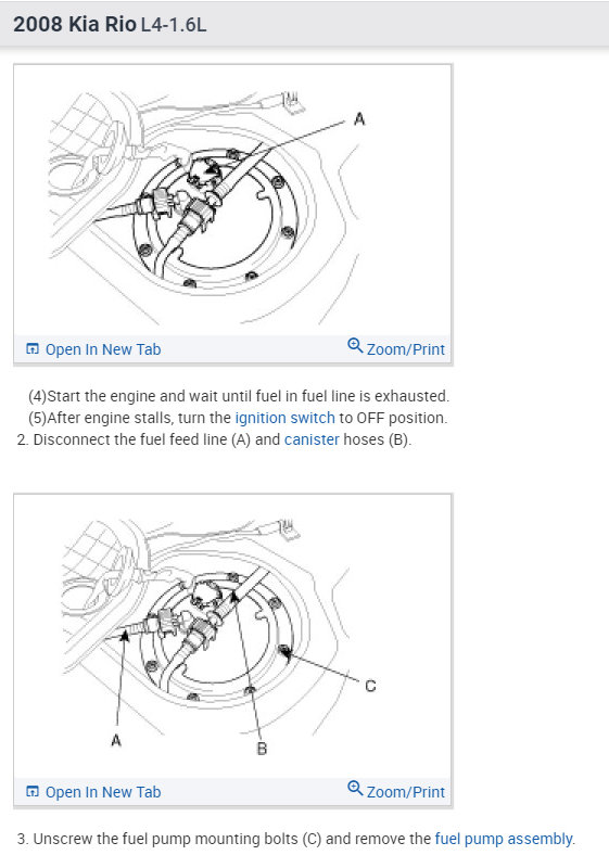

Where are the signal wires located?
Nov 17, 2022 at 3:47 PM
SQM
  • 6,383 POSTS
That is the connector that is attached tot he fuel pump module. See attached diagrams. That plug could be corroded or have bad connection.
