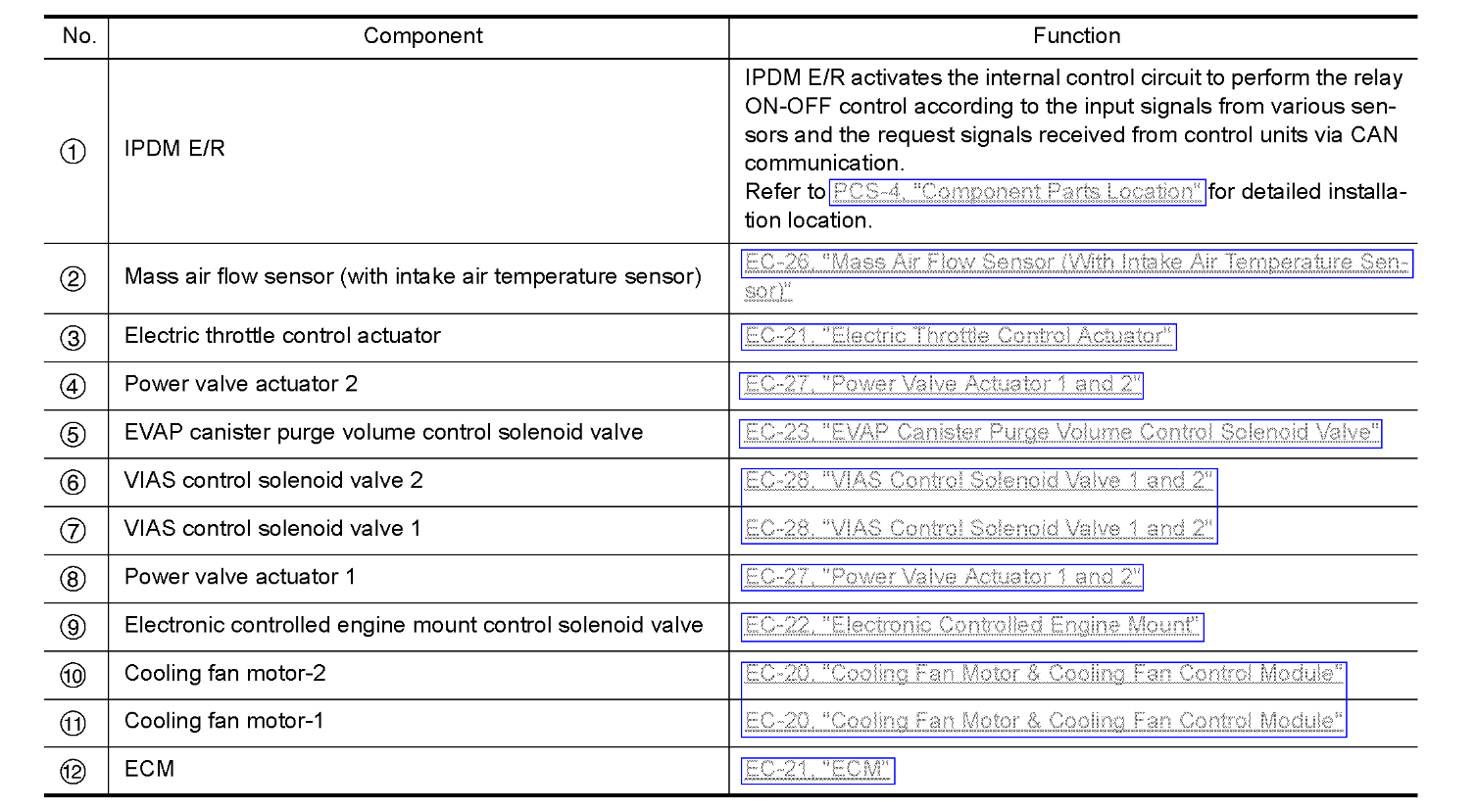

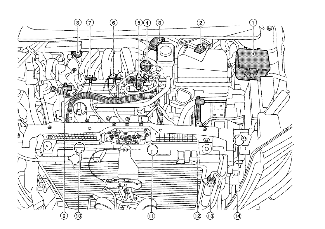

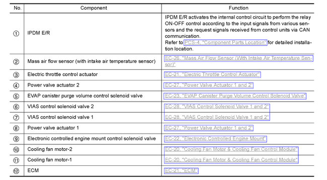

It is the gas level sensor which wears in time and can change resistance which makes the reading off, or the mileage calculator need an update patch. Also, I would check the air in the tires and clean the MAF sensor. Here is the location of the MAF sensor and a generic guide to show you how:
