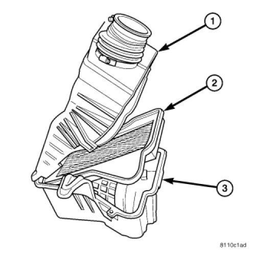

I was wondering what could make my gas mileage go down. When I fill my tank now I only get about 200 miles til empty but I used to get almost 400. Does this mean I need a tune up? It also shifts hard out of first gear.

A tune up can definitely help with fuel mileage. However, you mileage has nearly dropped in half. The first thing I would check is to make sure the air filter is clean and nothing is blocking the air intake/induction tube between the filter housing and the throttle body.

Here are the directions specific to your vehicle for the air filter. It shows how to replace one. Check yours first and make sure it isn't plugged. If it is, replace it. Also, make sure the air induction tube is not blocked by anything. The attached picture correlates with these directions.
1. Install the air filter element into air box.
2. Move cover so that the tabs insert into the air box.
3. Seat cover onto element housing and tighten the screws.
4. Reconnect the air inlet tube and tighten clamp.
5. Connect the intake air temperature sensor wire harness connector.
