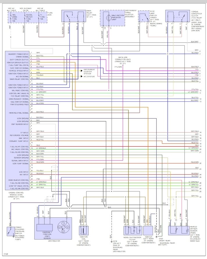

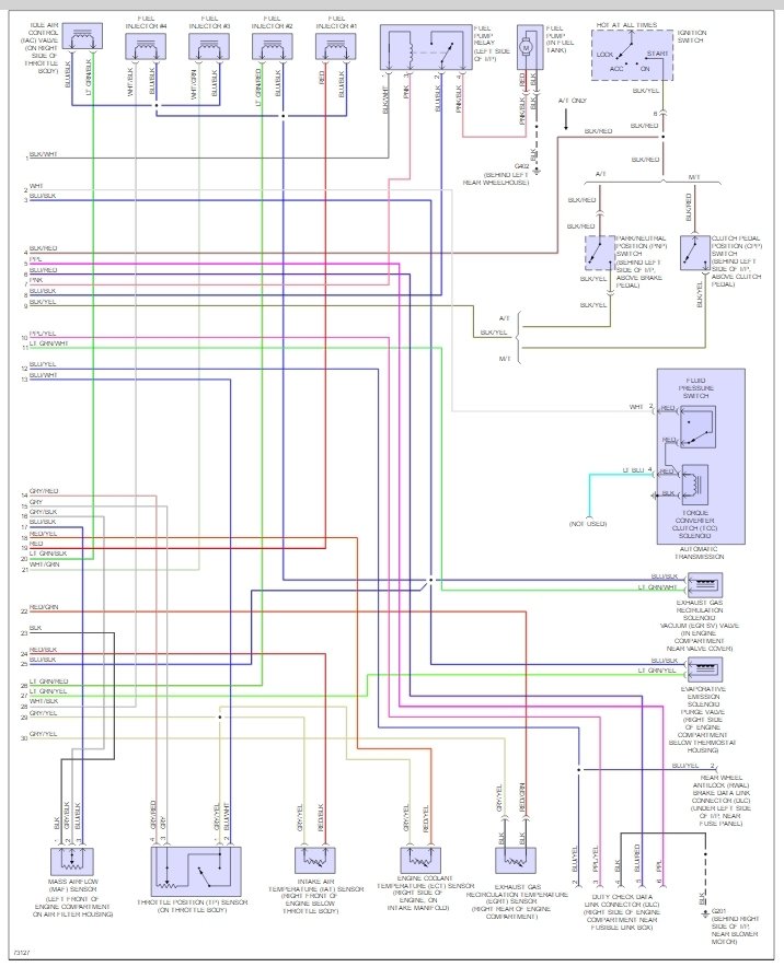

Hey William,
It sounds like you might have a system ground that is off, if it all checks out the computer is bad because you have an injector driver that is stuck on.
