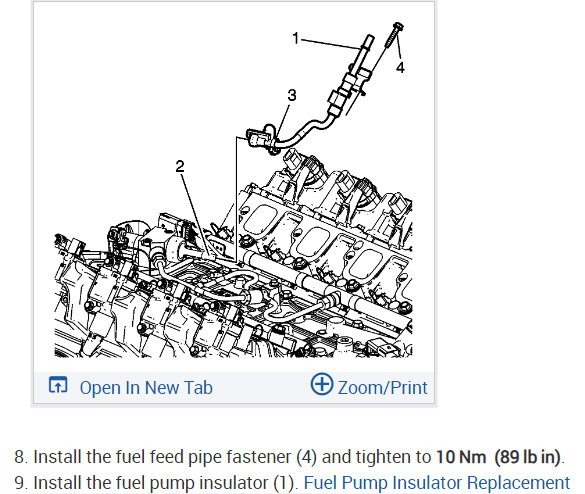

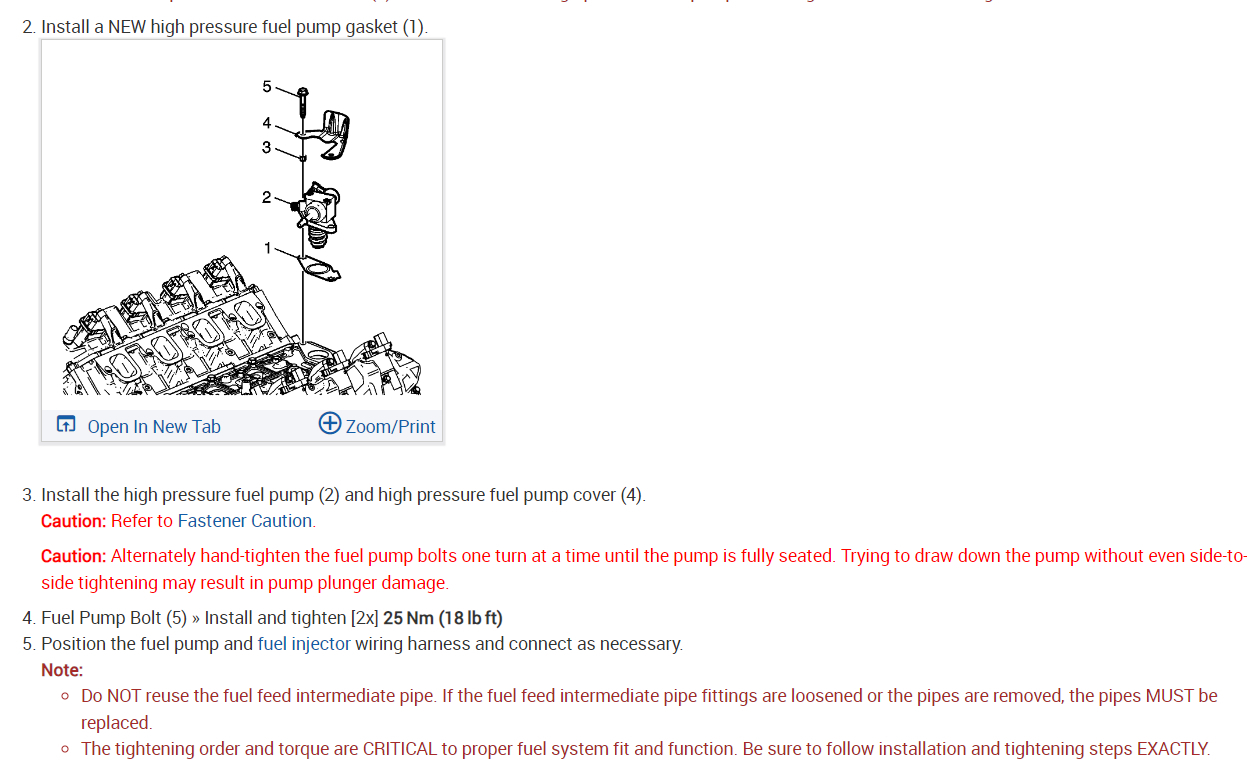

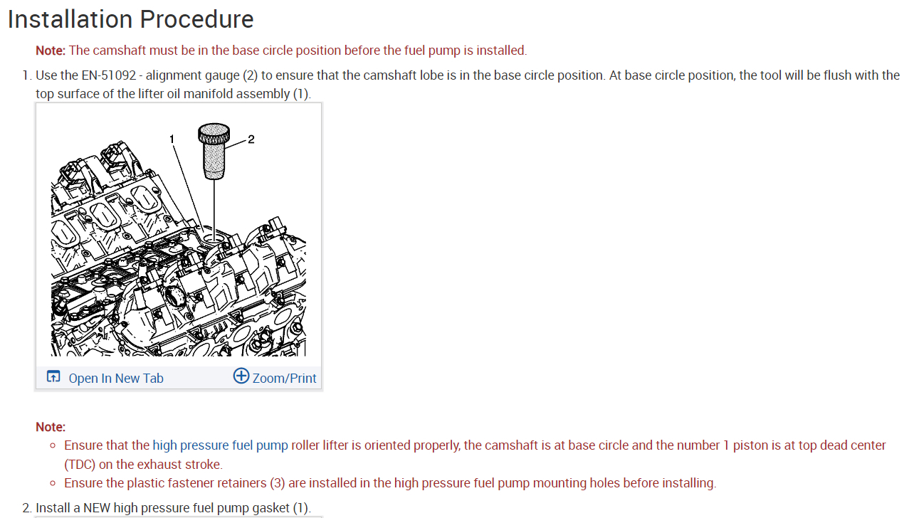

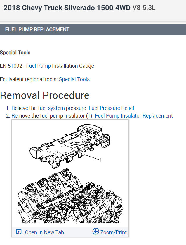

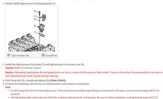

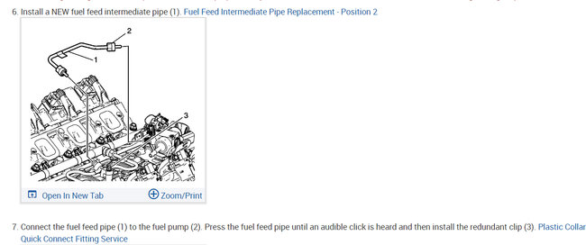

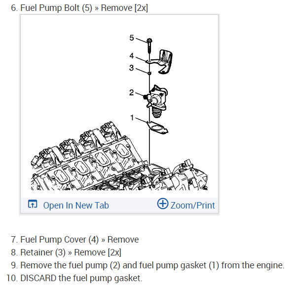

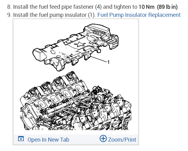

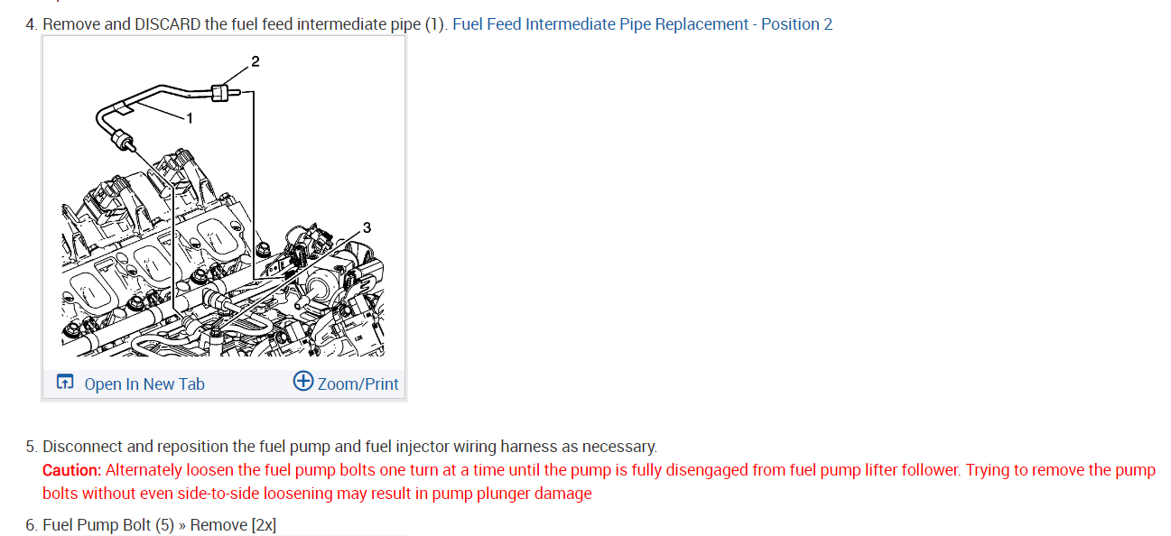

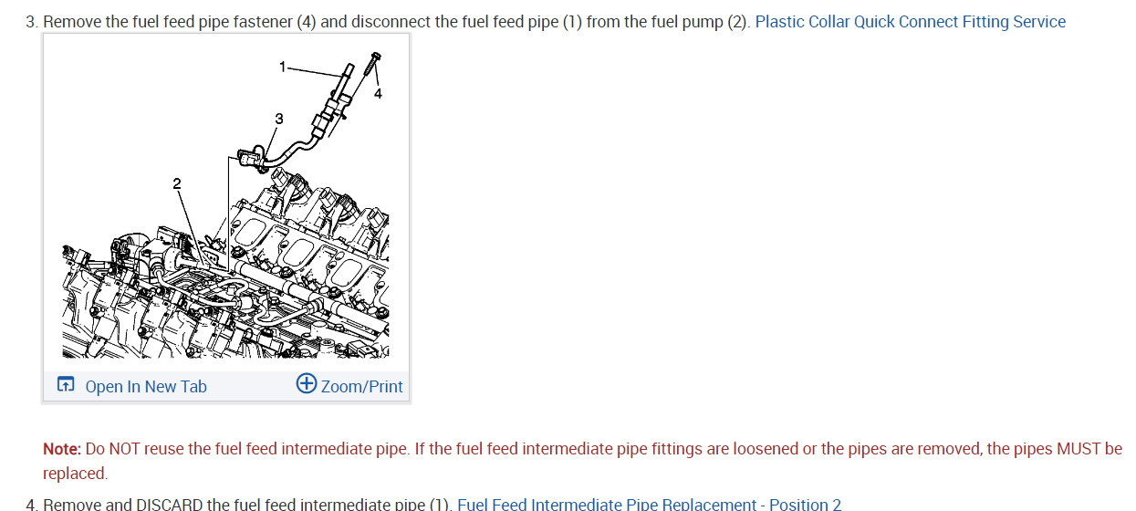

Opps, yep that is not good. So, it sounds like the high-pressure fuel pump main seal is bad and leaking into the engine, here is how to change it out correctly. I would get a new pump not rebuilt. Check out the images (below). Please let us know what happens.
