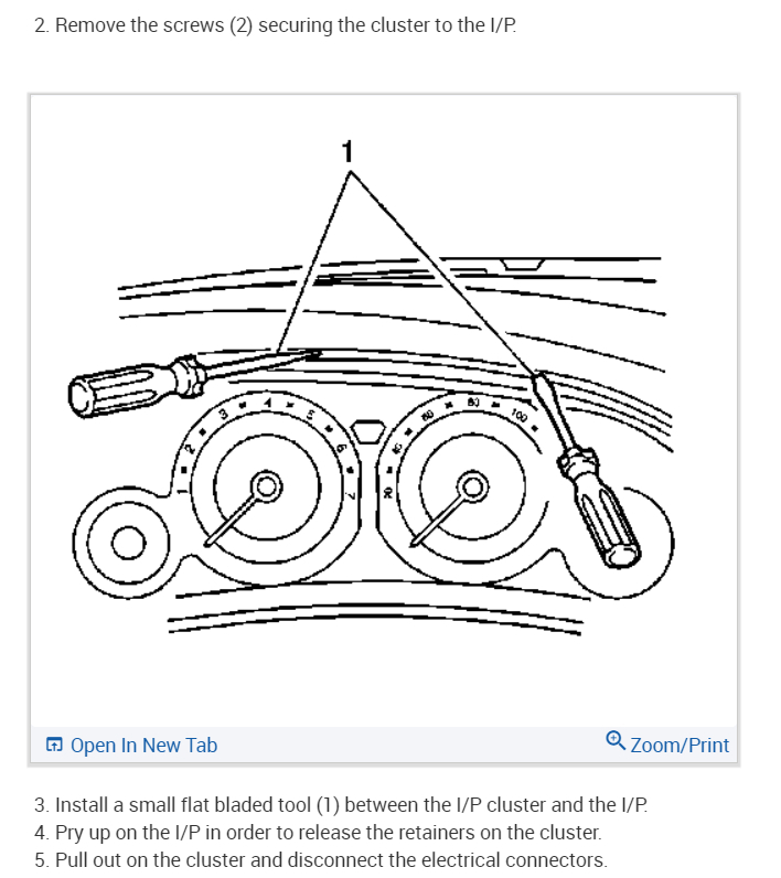

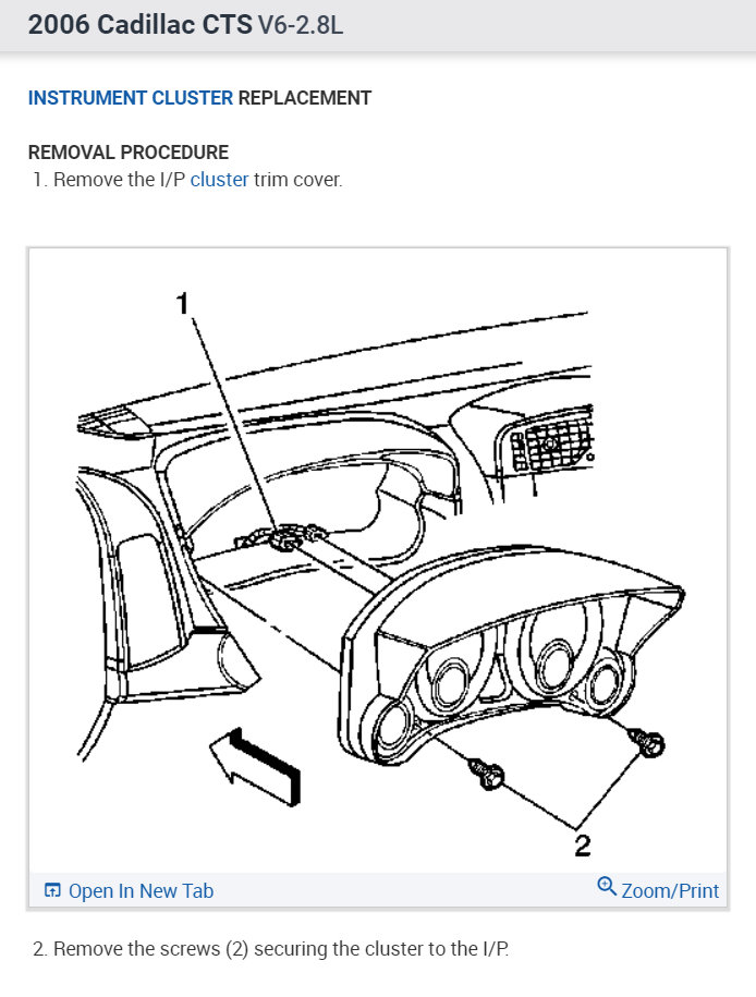

I have seen the instrument cluster go out causing this issue. here is a video showing the job being done on a similar car with diagrams below to help show you on your car:
