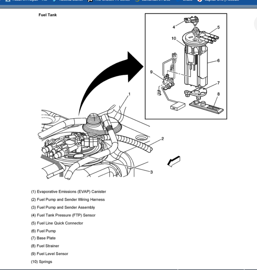

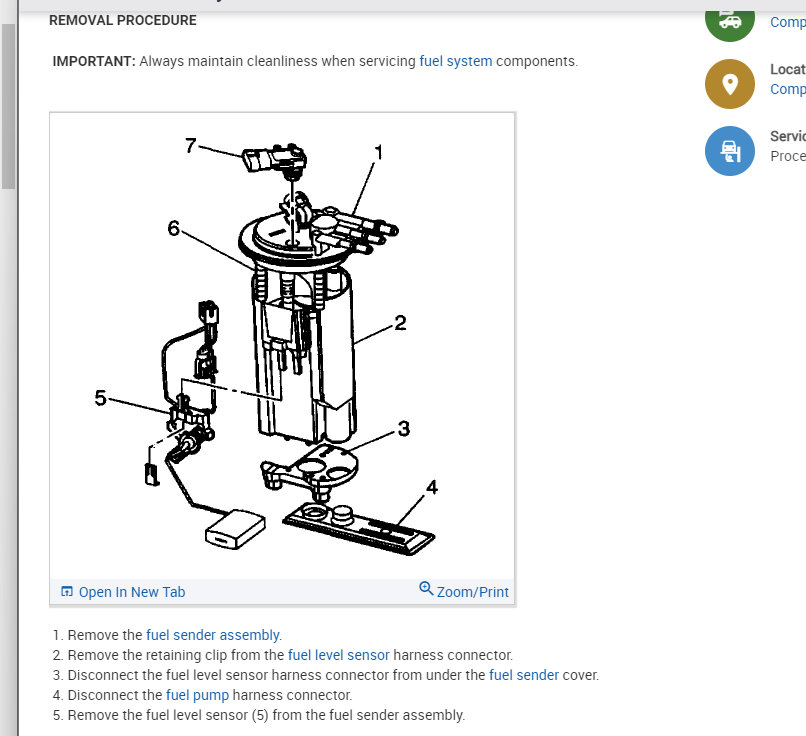

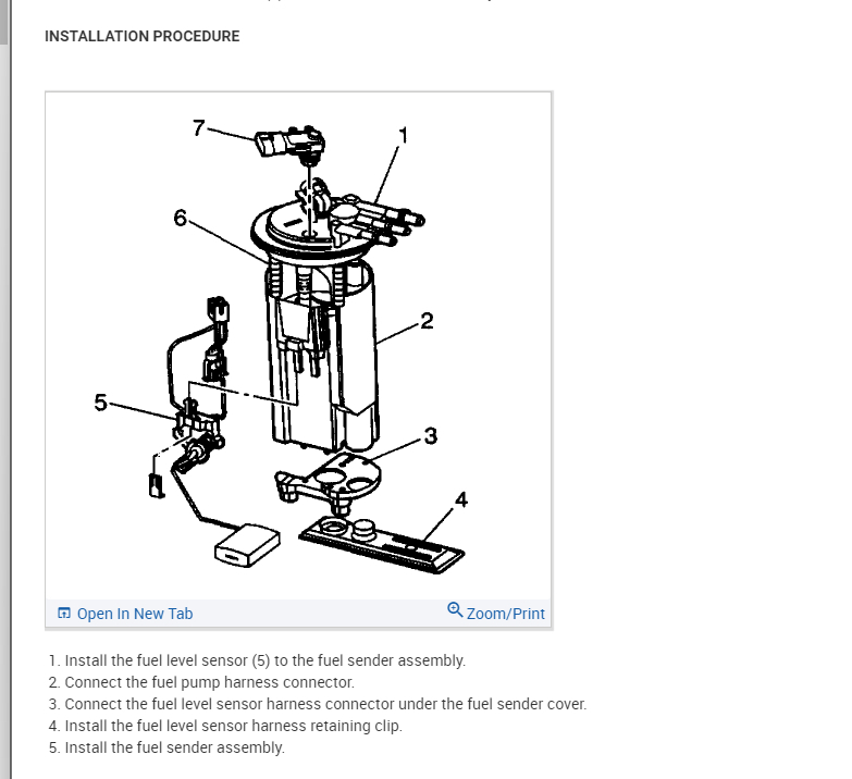

Hey guys! So, I just bought the car listed above with two problems.
First one, gas gauge always reads full. Doesn't go back and forth, it just always reads full.
