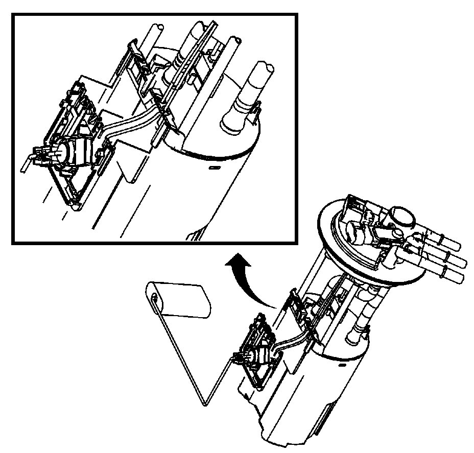

The fuel level sensor on this vehicle is in the fuel tank and part of the pump module. I suspect that since it isn't accurate, the float may be stuck or the rheostat has failed. The only way to be sure is to remove it. I attached a pic of it.

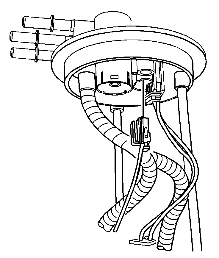

1. Remove the fuel tank module.
pic 2

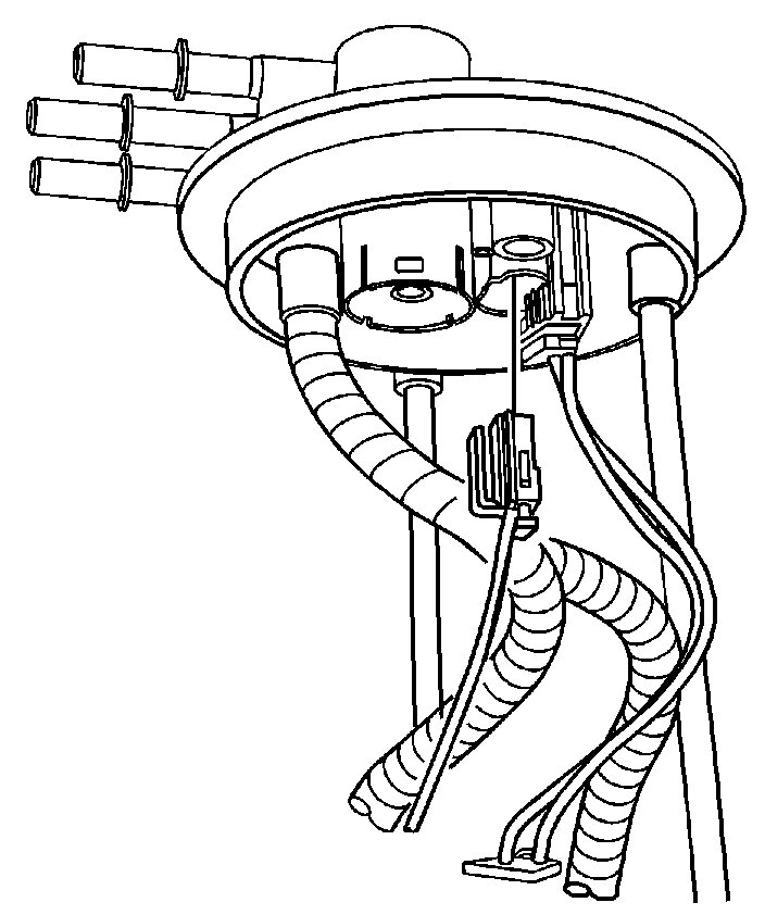

2. Disconnect the fuel level sensor electrical connector from the module.
pic 3
3. Complete the following in order to remove the fuel level sensor from the module assembly:
3.1. Disengage the locking tab from the sensor.
3.2. Slide the sensor downward from the module.

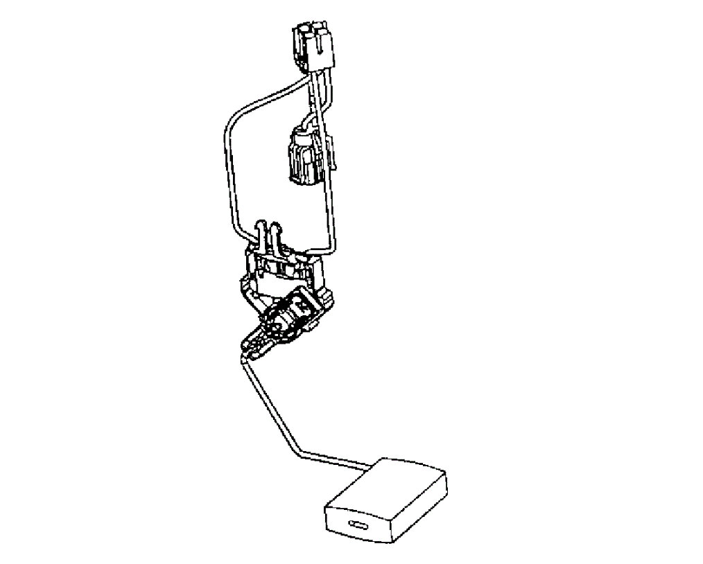

INSTALLATION PROCEDURE
pic 4
1. Complete the following in order to install the fuel level sensor to the module assembly:
1.1. Align the edges of the sensor with the slots in the module.
1.2. Slide the sensor into position, ensure the locking tab is fully engaged.

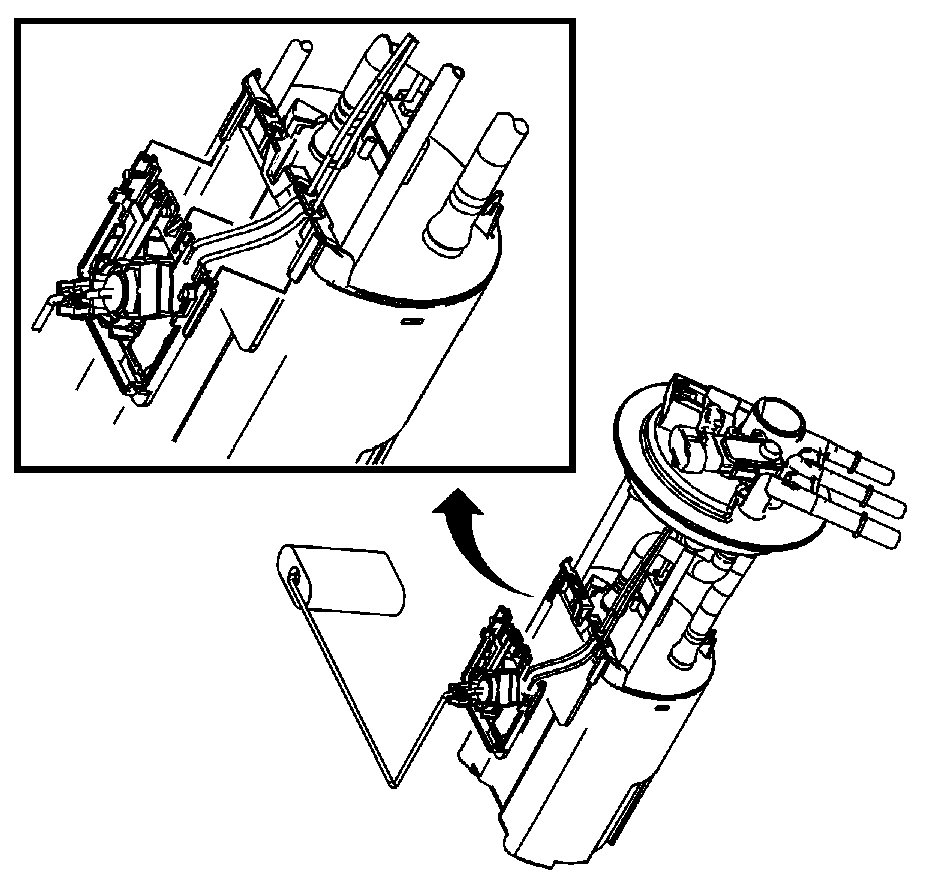

pic 5
2. Connect the fuel level sensor electrical connector to the module.
3. Install the fuel tank module.
