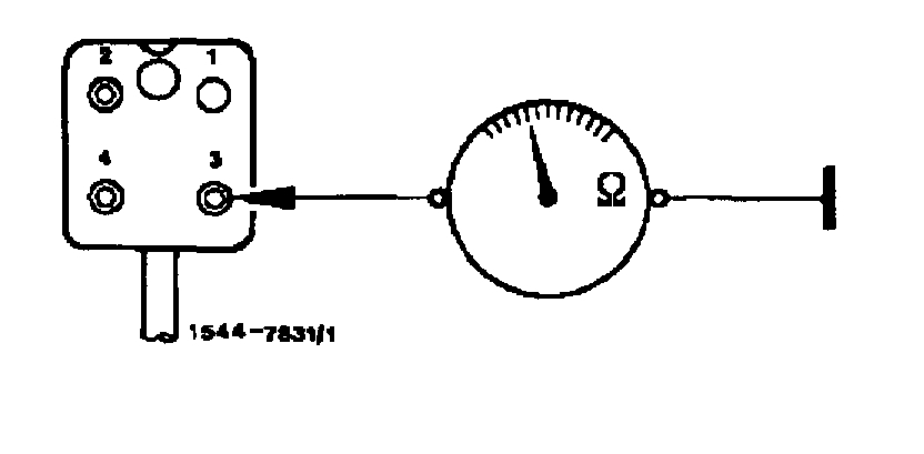

Testing immersion tube transmitter (removed)
(pic 1)
Connect ohmmeter to terminal G and terminal 31 and measure resistance.
a) In installation position, (readout reserve, float below).
b) Rotated by 180°, (readout full, float at top).

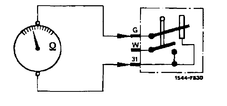

Testing reserve warning contact
Connect ohmmeter to terminal W and terminal 31 and measure resistance.
a) Nominal value 0 ohm in installation position.
b) Nominal value infinite ohm turned by 180°.
Testing harness
(pic 2)
1 Pull coupler from immersion tube transmitter and measure resistance on jack 3 and vehicle ground.
Nominal value 0 ohm
(At test value infinite ohm the grounding line is interrupted).

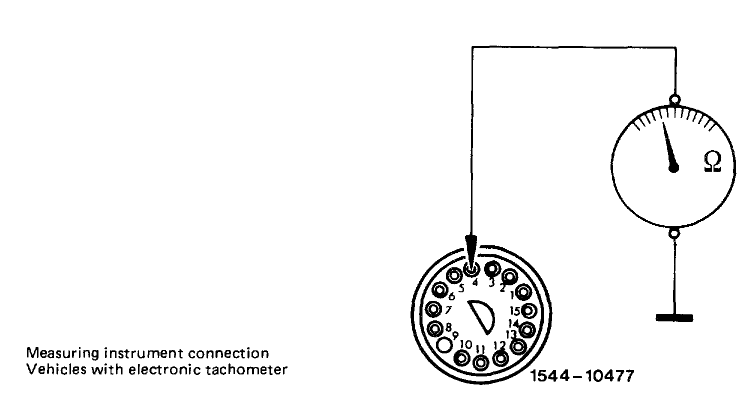

(pic 3)
2 Measure resistance on terminal G and terminal 31 on installed immersion tube transmitter. Value depends on amount of fuel in tank.
Plug coupler back on immersion tube transmitter.

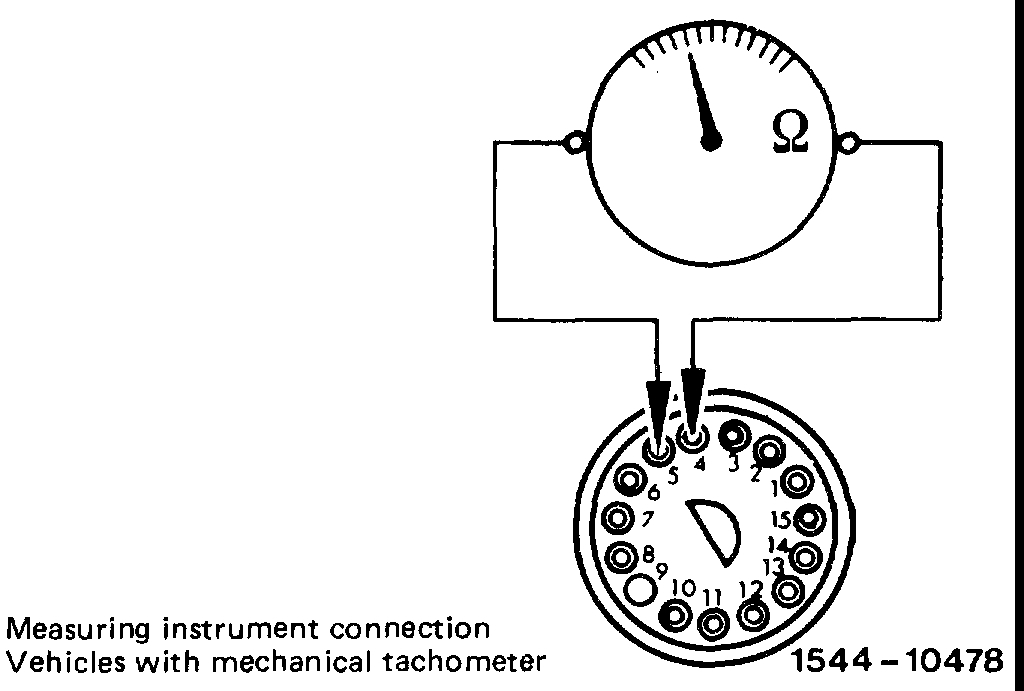

(pic 4)
3 Pull coupler from instrument cluster and measure resistance between jack 4 and jack 5 on vehicles with mechanical tachometer.
On vehicles with electronic tachometer between jack 4 and ground.
Nominal value: the value measured under 2. If the value is attained, the harness is in order (slight deviation caused by length of line possible).
