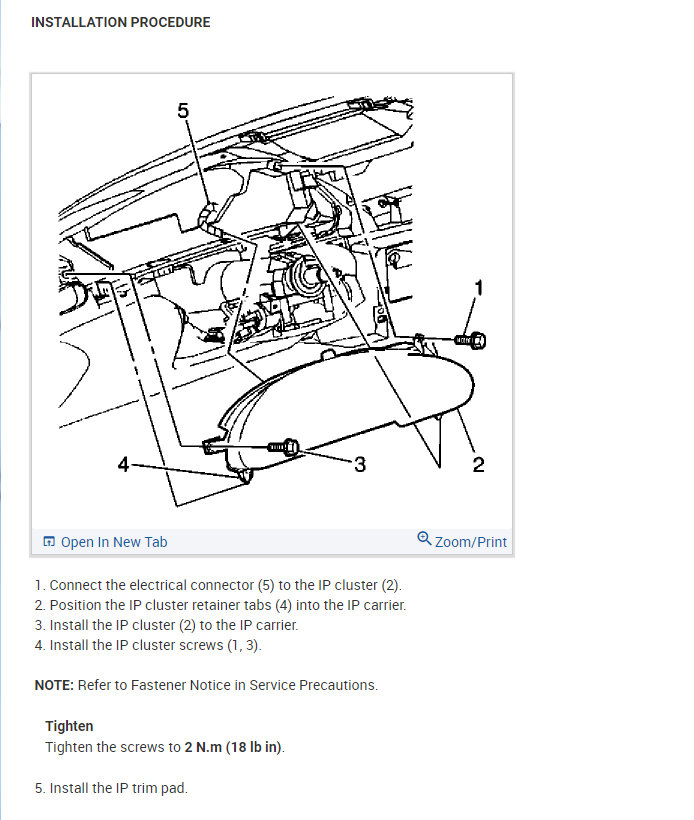

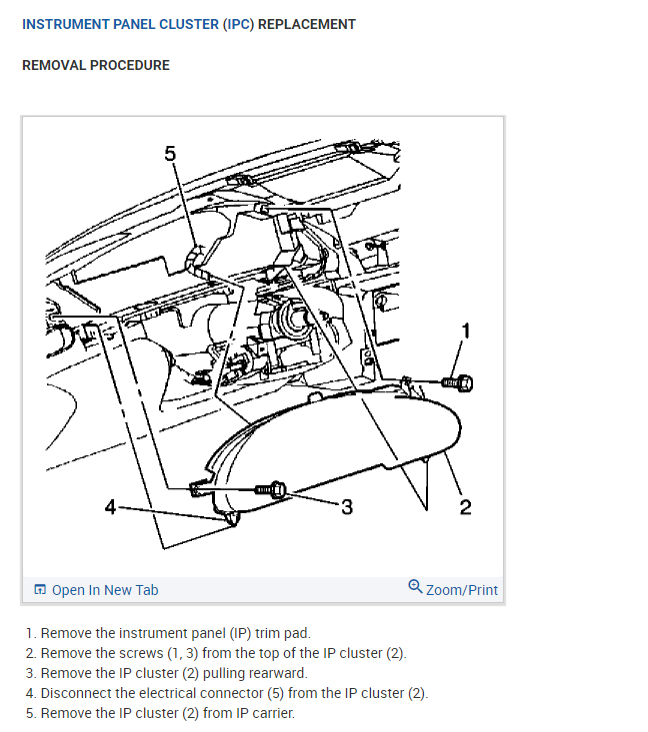

If there are no codes then I would think the cluster is the issue and I would replace that.
I attached the process below on how to do that. Let us know if you have questions. Thanks
