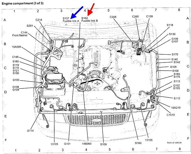

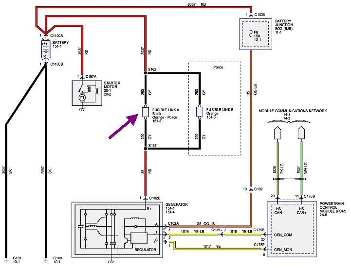

According to the diagram, your car uses a bolted-in fuse. It's rare to find two of those in any one car, so just look at the one in your fuse box. There is no photo of this type of fuse in my regular resources because it is too generic of a part. Take the old one with you to match it up at a parts store or salvage yard. You might find a catalog at an auto parts store that lists fuses by application, but typically they just grab one off the shelf that matches what the mechanic or customer brought in.
A different part of the service literature indicates your car uses a fuse link wire. That is the one I described earlier that simply looks like a piece of wire, but it is a smaller diameter and a different color that the rest of the wire it protects. Yours is listed as an orange wire, so that is the color you will ask for. That color denotes its current rating, just like different fuses have different colors for the same purpose. You'll get about a 12" piece which is enough to be cut for two to four repairs. The length of the piece you splice in is not important to proper circuit operation.
Be sure to slide on two pieces of heat-shrink tubing with hot-melt glue inside. Once the splices are soldered and any sharp points are pressed down, slide the tubing over the joints, then warm them with a match or hot air gun to shrink them. The glue will seal the joints from moisture.
