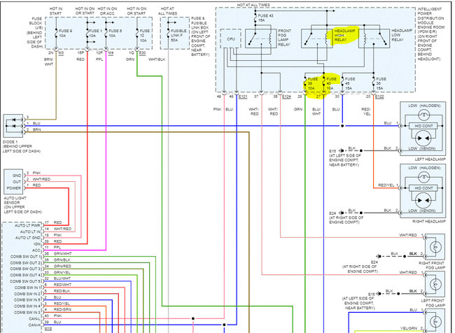

I believe that according to the diagram printed on the box cover fuses that powers the high/low beam and the fuse that powers the IGN cccs cont has popped also. As soon as I replace those fuses it pops again.

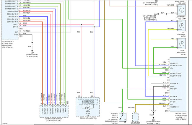

I need to know if the vehicle has daytime running lamps. The schematics are very different.

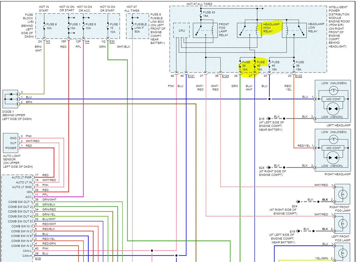

Also, I attached a schematic below for the DRL circuit. I highlighted two fuses. Is it one of these that is failing or both?
Also, recheck the other fuse you mentioned. Is it an eccs fuse and not cccs?
