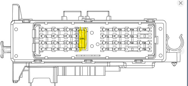

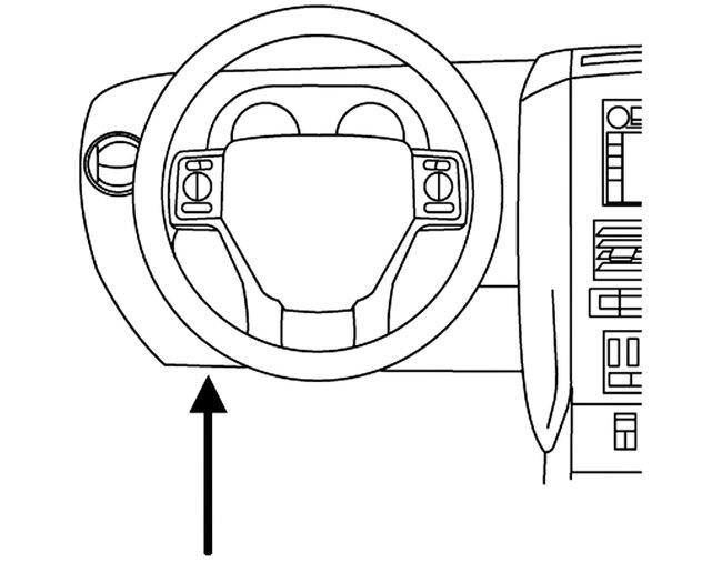

Hi Ronaroll,
There is a fuse box located under the driver side trim. (See picture) I have highlighted the rear window switch in yellow (CB1) and the rear fuse (F5) in blue. I would remove them and test both of them for continuity before moving on to accessing the rear motor.
