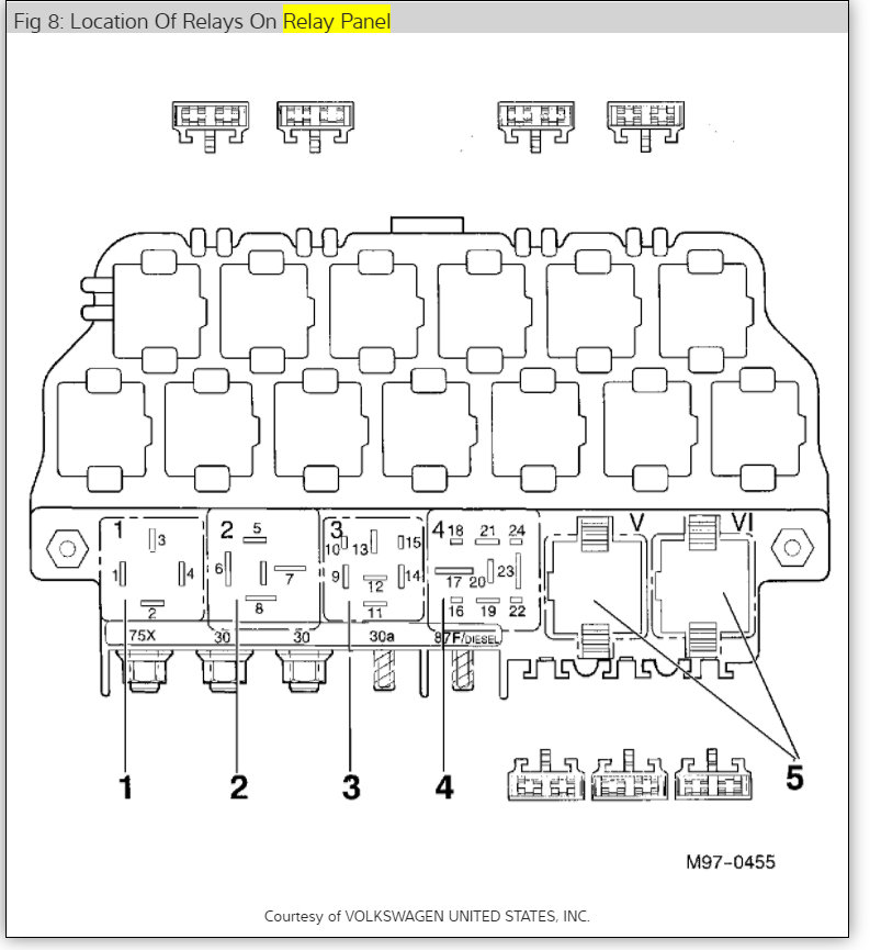

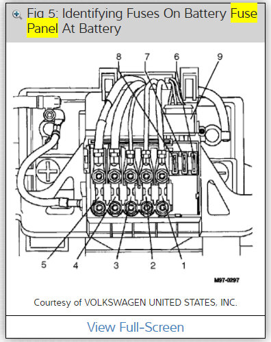

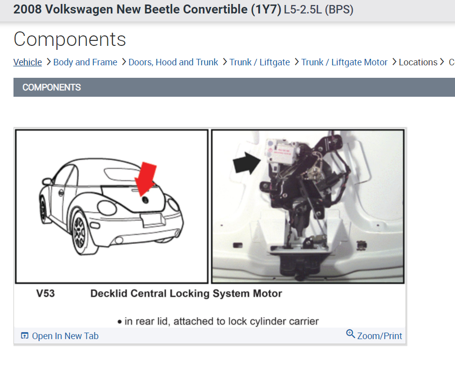

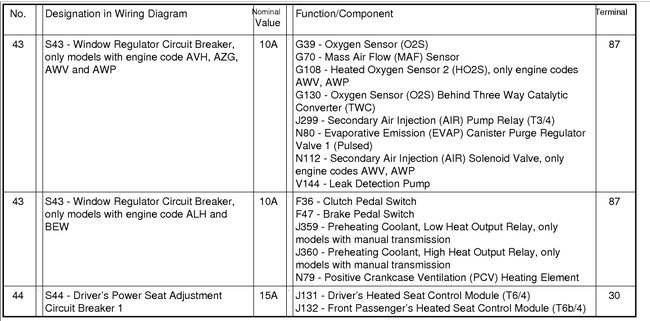

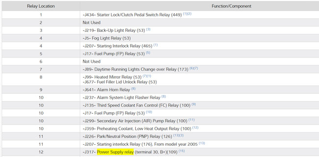

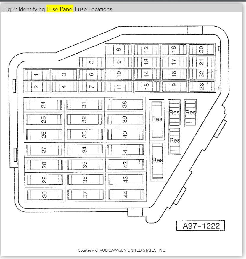

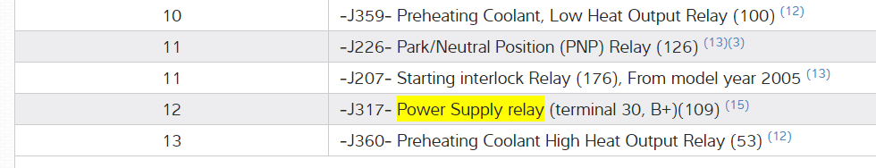

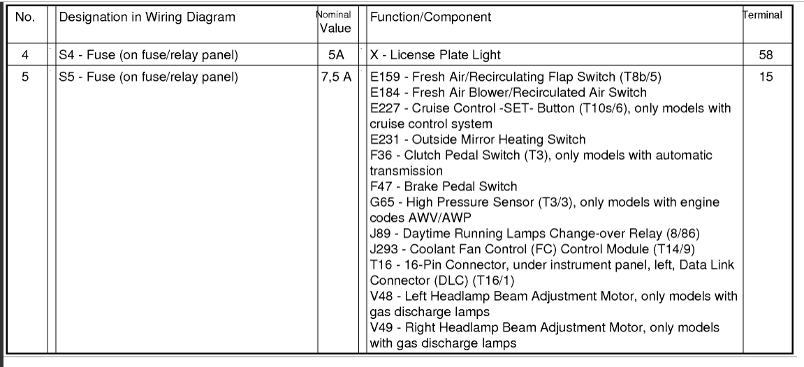

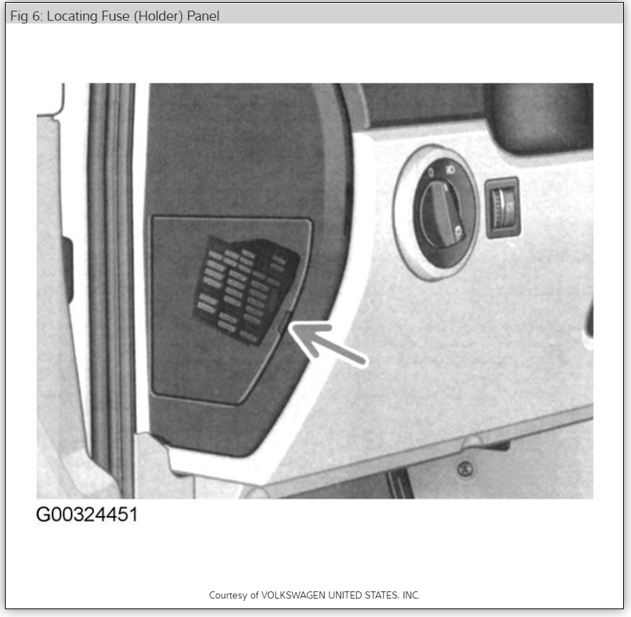

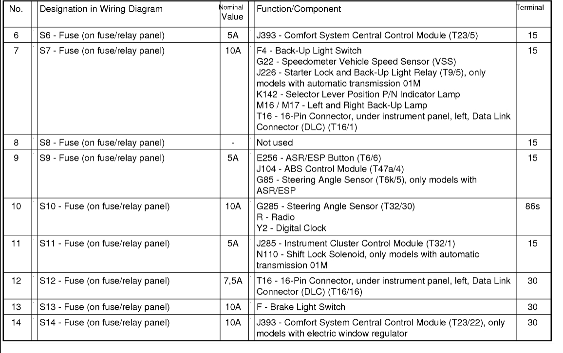

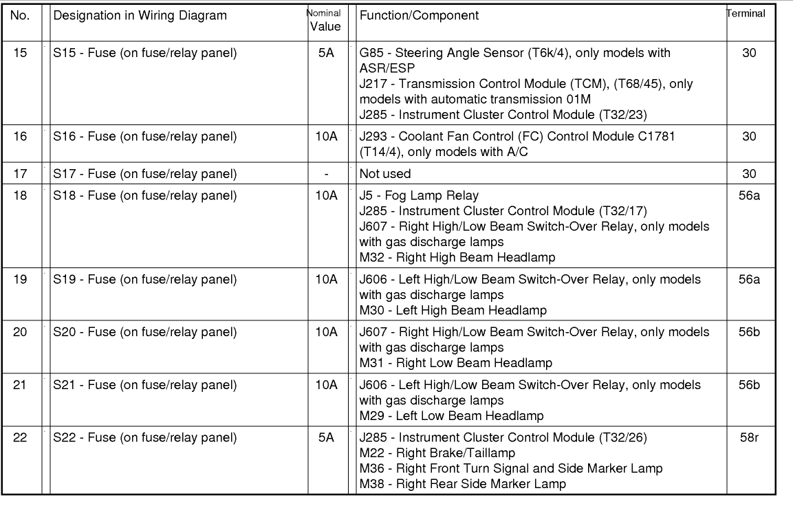

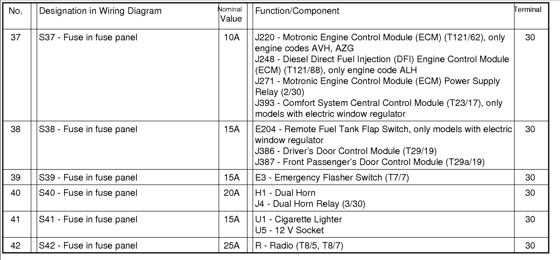

I am unable to open my trunk on my convertible beetle. I have read to check the fuses 14 and 144. Do I need a tool to properly check them? Also if I do need to replace the motor in the trunk does it need to be from VW or will an aftermarket be okay?
