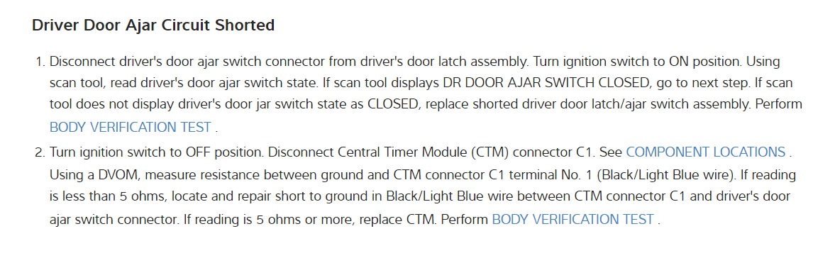

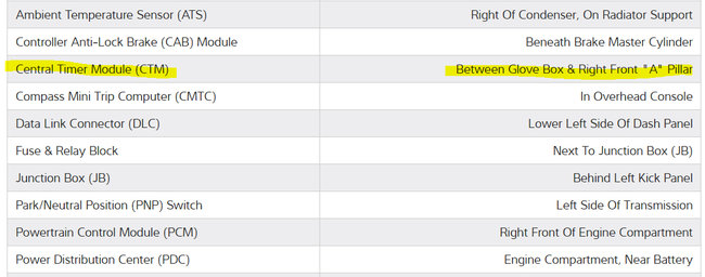

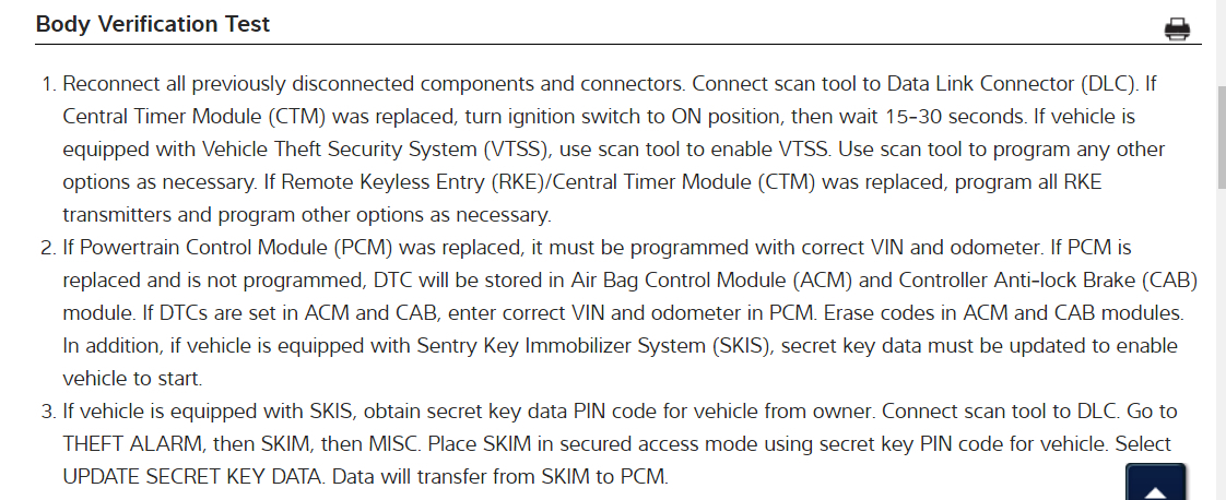

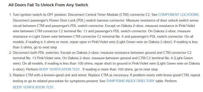

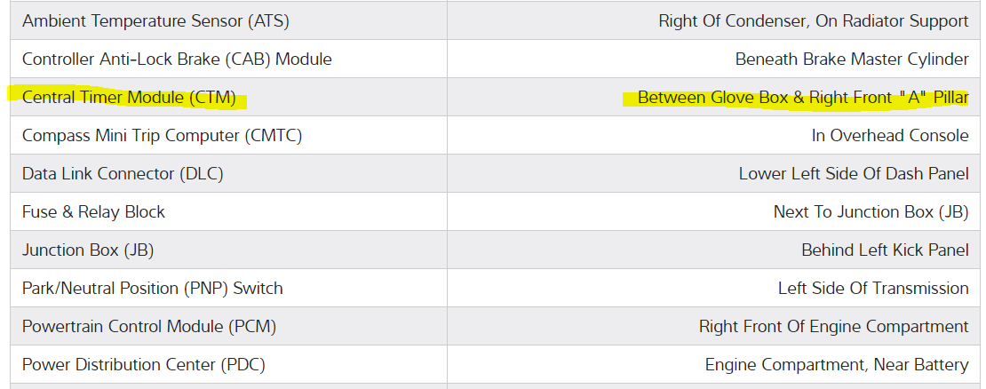

It’s raining and my windshield wipers won’t turn off and my doors won’t lock and when the door is open my lights don’t turn off and I’m afraid of turning my car off because what if it doesn’t start again. what do I do?
